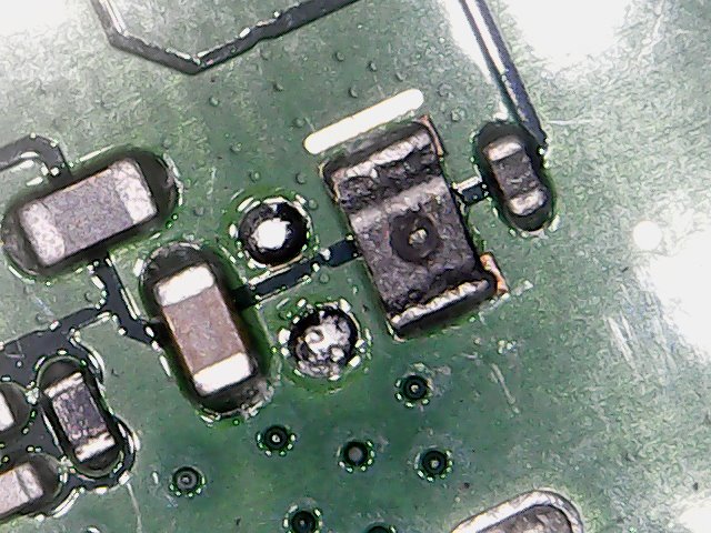

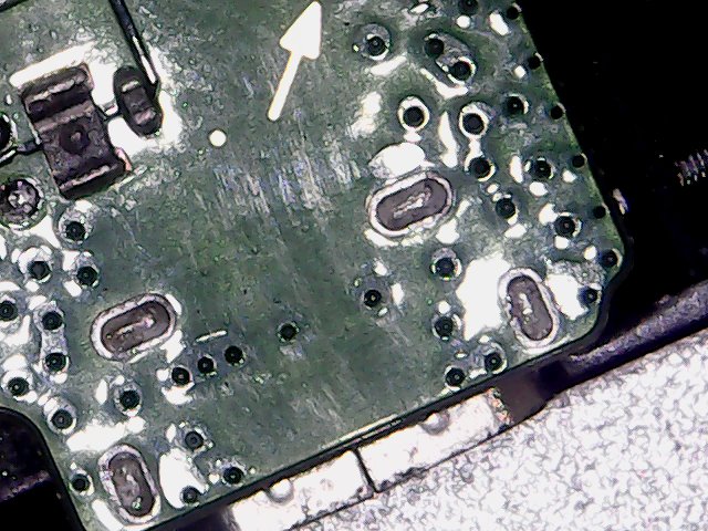

    Hi friends! I am trying to repair this tablet and I found that this zener diode (part number CDZ55C5V6S) has a hole in the middle (attached photos and schematic). I have searched on Aliexpress, to order that diode, and I can't find it.
    My question is, will there be a replacement for this diode? And which diode could replace it that is similar to this?
    Thank you very much in advance for reading my question

    What is the part # reference in the schematic for this blown (holy?) part ?
    Which connector is on the other side of this blown part ?
    Never mind - datasheet is attached. Looks to be a 5v6 zener. Let me look around.

      Re: Doubts with a diode Lenovo A10-70 Tablet (A7600-F)
      Thank you very much for answering. On the other side there are no more components and it is perfect. Nothing burnt. It's just that diode that has a big hole in it.
        Ran out of time earlier...this is an 0805 smd size zener diode at 5v6 rating. Nothing special.
        100PCS SMD Zener diode 0805 0.25W BZT52C10V 3V 3V3 7V5 6V8 5V6 5V1 4V7 12V 10V 15V 16V 18V 20V 24V SOD-323
        https://a.aliexpress.com/_mKycjrW
        Select the 5v6 rated part.
            No worries. One extra comment is that the original part appears to be a 500mW rated part = 0.5W.
            The one I have linked is 250mW rated = 0.25W.
            Ask each vendor if they can supply in 0805 size, the 500mW part at 5v6. Certainly supply the original part # from the above datasheet. They should be able to find it.
            Good luck!
