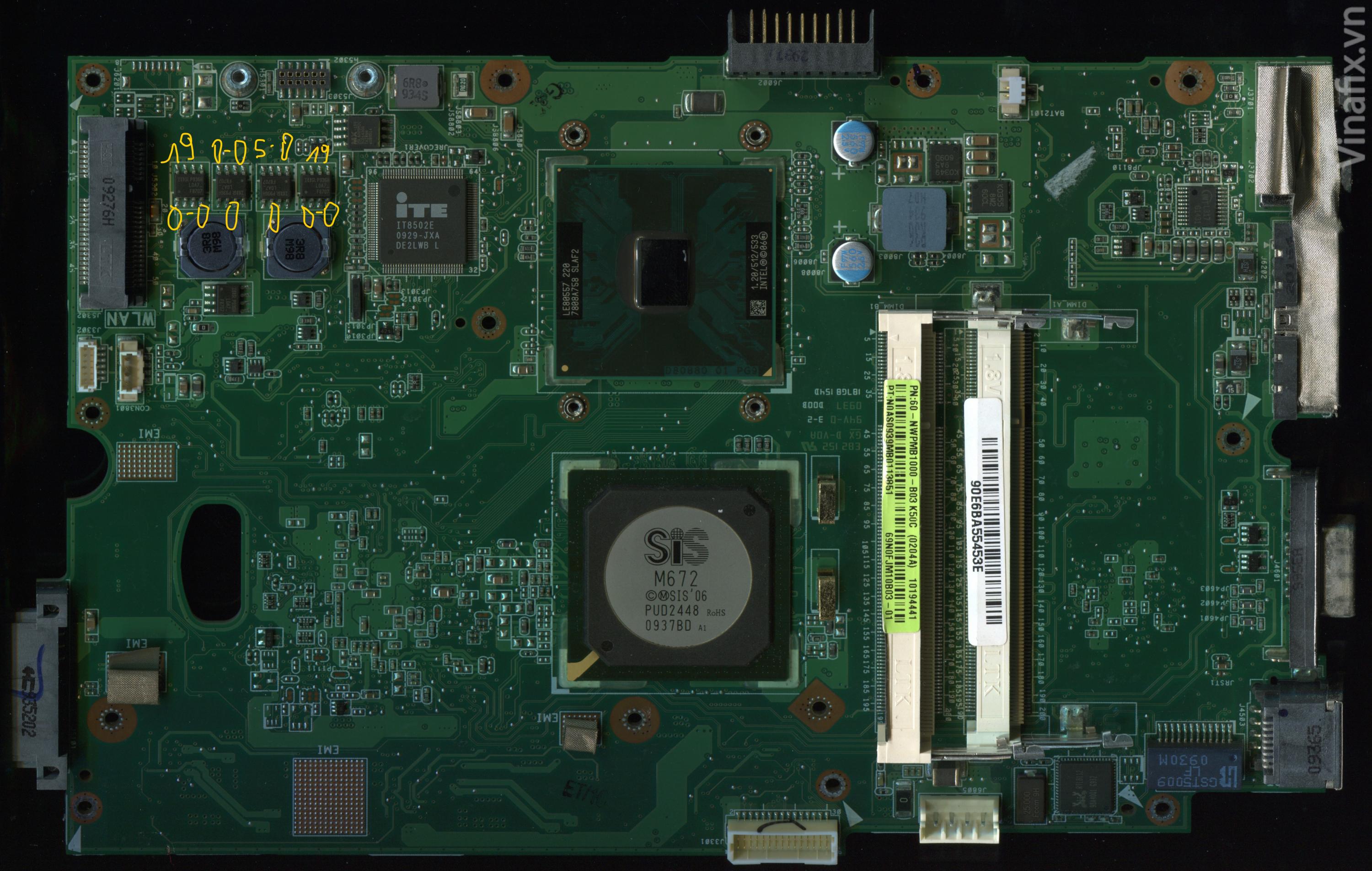

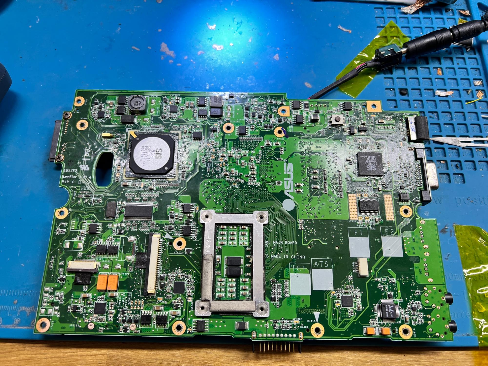

    Hi to all! please help me! i'm a newbie
    motherboard k40c rev 2.1
    i've voltage on bios, on power button, and battery connector but when i push the power button nothing happens: no amps abdsorbed by power supply
    can you help me thanks!
    p.s i've tried also to reflash the bios

              schematic and boarview....

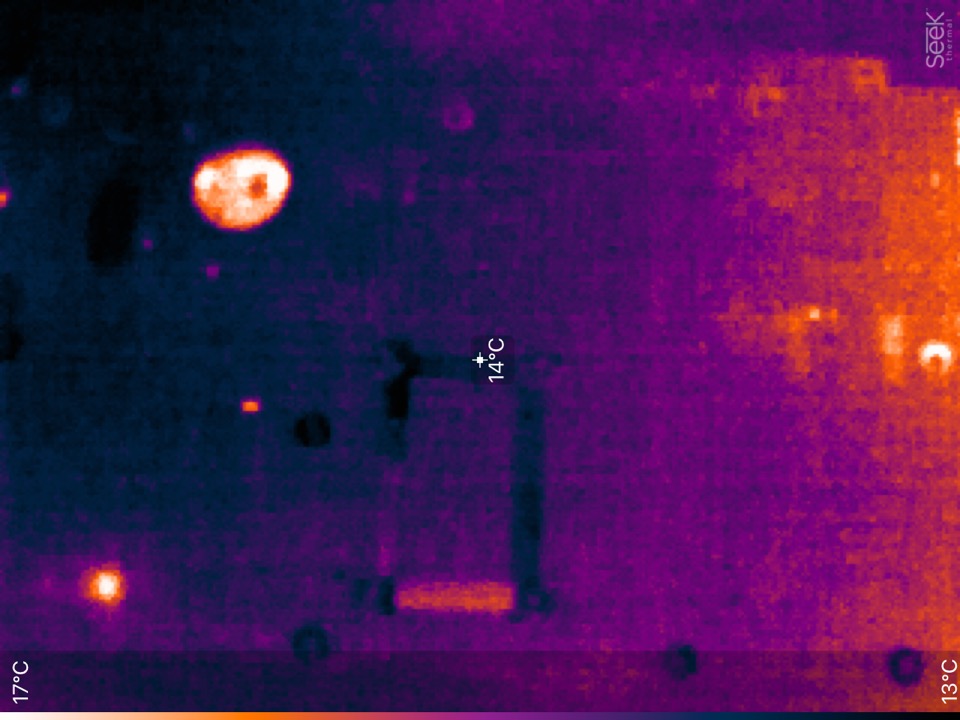

              using thermal camera, i've seen that as soon as i connect the power supply, u8101 (RT8206B) become hot, but i've checked all pins and i have not shorts

                          voltage of u8101
                          1=2v
                          2=2v
                          3=4,98
                          4=5,11
                          6=19,32
                          7=4,98
                          8=0
                          14=3,2
                          19=5
                          20=0
                          about mosfet: i don't know how to test it, but i've write on the picutre, voltage that i've measured

                            can you uplode pic from using thermal camera

                              P.s eveni u8102 become hot (hot only with camera..impossible to see with alcol or rosin)
                              when i power on the psu, it absorb 0.006 amp with u8101 and u8102 hot.
                              if i remove u8102, i have no amp from psu and u8101 don't become hot. but on u8102 i have right voltages
