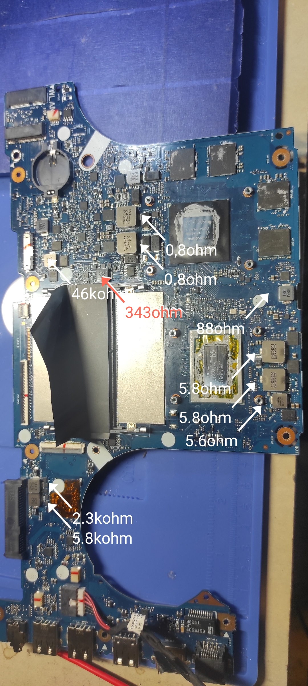

    In the laptop, after connecting the power supply, only the keyboard is illuminated.
    No reaction to the switch, no diodes light, no battery charging.
    Current consumption after applying voltage 0.04A without frames and batteries. Slightly warm CPU.
    In my opinion, coils without description have good resistance to ground, so I did not select it.
    Transistors checked. No short circuits.
    What else can I check? Please note that I do not have extensive experience in repairing plates.

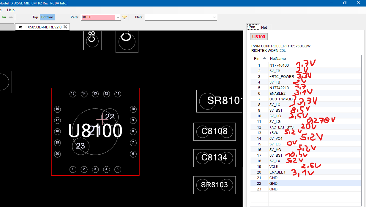

                  • alb3rt121
                    • Feb 2022
                    • 15
                    • Poland
                    Re: ASUS Tuf Fx505dd rev2. Does not start up, does not charge the battery.
                    I found a pwm controller.
                    Measurements in the attachment
                    • mcplslg123
                      • Jun 2015
                      • 7262
                      • india
                      Originally posted by alb3rt121
                      Measurement
                      CLR +19v- Present
                      LDO +3v - Not preset. I can't find where it comes from
                      Pin3 of RT6575B is your 3V LDO. Going by your measurements, its present.
                      • mcplslg123
                        • Jun 2015
                        • 7262
                        • india
                        Is your dc supply 3 digit or 4 digit?? If it's 3 digit, then consumption is 40mA-so something must be slightly hot.As per your observation, its cpu which is getting hot-not a good sign.
                        Measure resistance on each and evry coil .
                          My power supply is 4 digit (0.000). After put voltage to motherboard 0.045A
                          The measurements are in the attachment.
                          Coil at CMOS battery - 122 ohms. I forgot to add in the photo

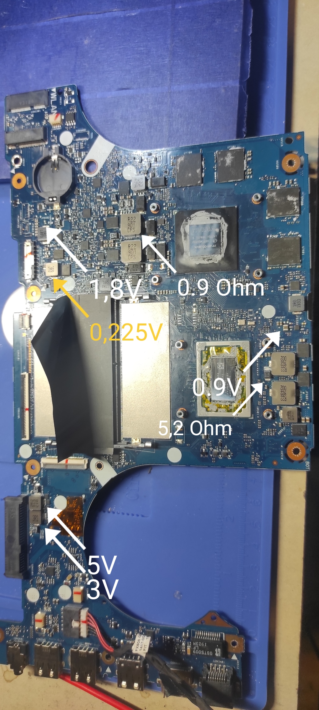

                            Locate the dc-dc converter ic for +3V/+5V to +3VS/+5VS and check resistance on ALW as well VS side of this converter. Something is not hot?? Consumption at 45mA is abnormal in standby. I doubt mb is perhaps partially switching as u got kbd backlit which is not powered by ALW rail.
                            • alb3rt121
                              • Feb 2022
                              • 15
                              • Poland
                              The CPU is slightly warm, as I said, but not hot.
                              I will check the converters as soon as I can. I will let you know about the results.
                              I would like to know why there is a low resistance of 0.9 ohm on the GPU power supply. This is normal?

                                • alb3rt121
                                  • Feb 2022
                                  • 15
                                  • Poland
                                  Can such symptoms be caused by a damaged SIO?
                                  I noticed that on IT there is no 3.3V on legs 11, 83.

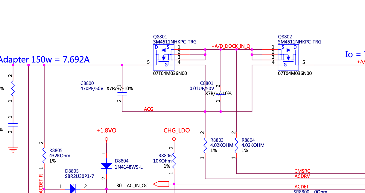

                                  • mon2
                                    • Dec 2019
                                    • 14660
                                    Unable to locate the schematic for the FX505DD but have the FX505DU in the (paid) locked database.
                                    1) Is FX505DU similar to your logic board ?
                                    2) Are you using the recommended 150W power supply ?
                                    3) Remove all power. Meter in resistance mode.
                                    Check if the first 2 mosfets are damaged or not with resistance checks.
                                    Meter in 2k scale (or similar).
                                    Check the resistance of:
                                    source (1-2-3) & drain (5-6-7-8)
                                    source (1-2-3) & gate (4)
                                    gate(4) & drain (5-6-7-8)
                                    Post the readings. Checking for low resistance readings = defective mosfet.
                                    Check both of the first 2 mosfets - see attached.
                                      Thank You for help.
                                      1. The schematic of the Fx505DU is the closest to the DD.
                                      2. I use oryginał 150W power sipply.
                                      I will let you know when I take the measurements.
                                      I am attaching the diagram of the FX505DU board

                                      • alb3rt121
                                        • Feb 2022
                                        • 15
                                        • Poland
                                        I just found out how MOSFET works using diode and resistance mode. lol. By the way, I found a MOSFET with a low resistance between G and S. This is the VVT and DDR power supply (I don't know what VVT is) After the measurements, it turned out that the U8300A chip
                                        RT8231BGQW legs 16, 17 are mosfet controlled. The IC didn't look very good, it had changed color like burnt. I have ordered parts so I will reply soon. May it work.
