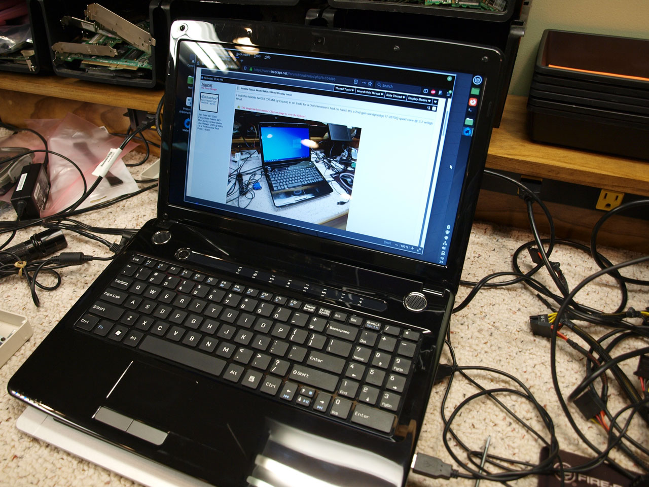

    I took this Nobilis N4051 (OEM'd by Equus) in on trade for a Dell Precision I had on hand. It's a 2nd gen sandybridge I7-2670QM quad core @ 2.2 w/8gb RAM.
    It had Win7 on a spinning drive. I dban'd the spinner, and tossed a SSD in it and installed 10. Here's where it gets weird. When rebooting (soft reboot/restart), when it gets to the point it would load the graphics driver, the screen goes black; backlight is still on but nothing on the display, yet the system is still running/functioning. If I press power and put it to sleep and wake it back up again, the display returns & functions as normal. If I cold boot it, it does not do this; everything is fine.... It is not a power management thing....it feels like a firmware quirk to me...or maybe a driver quirk... It's running the driver version 9.17.10.4459, right from M$ update, and there doesn't seem to be anything newer (Intel HD3000). There's very little information out there about this system; apparently they're quite obscure.....so no BIOS update for it that I could find.
    FWIW, If I plug in an external monitor (either HDMI or VGA), the ext monitor works fine no matter what.

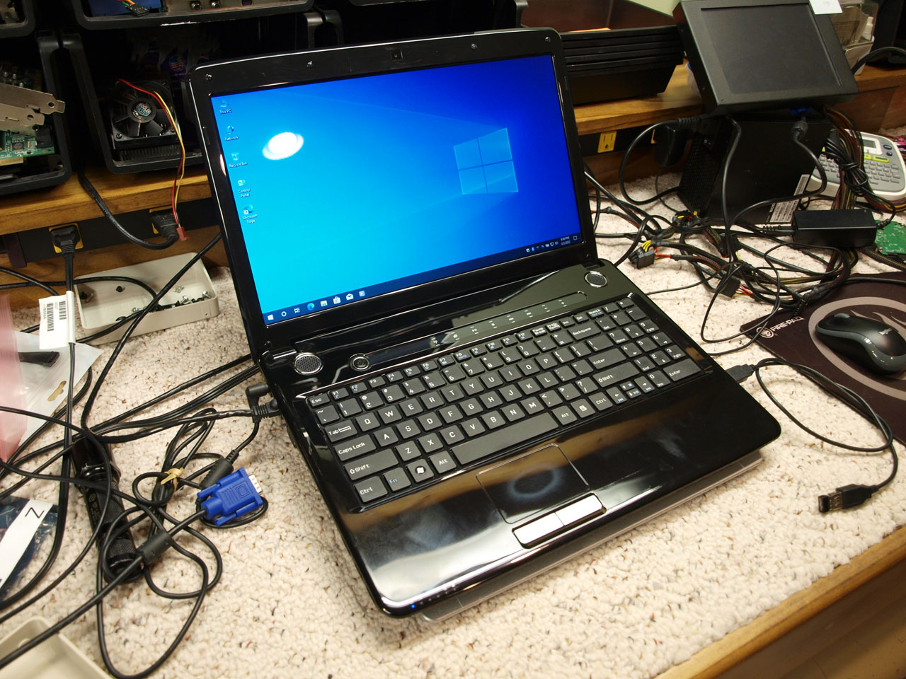

        I played around with this some more this morning. I never tested it under 7, only 10. It appears to be a driver issue; the HD3000 never had official driver support from Intel for Win10.
        Test # 1: Go to start and tell the system to restart. When the system cycles; at the POST screen, shut it off. Pull battery, completely dead.....so the next startup will be a cold boot. When I booted it back up, it went to the black backlit screen....seemingly because I told it to restart at shutdown; not actually shut down. Not sure if it makes any difference, but it's legacy booting, not UEFI. Telling it to shut down and powering it back up, it boots normal, display is fine. The only time this quirk arises is if it's told to restart in Windows.
        Test # 2. I put the I3 CPU back in, which I believe is the same GPU. The issue is still there.

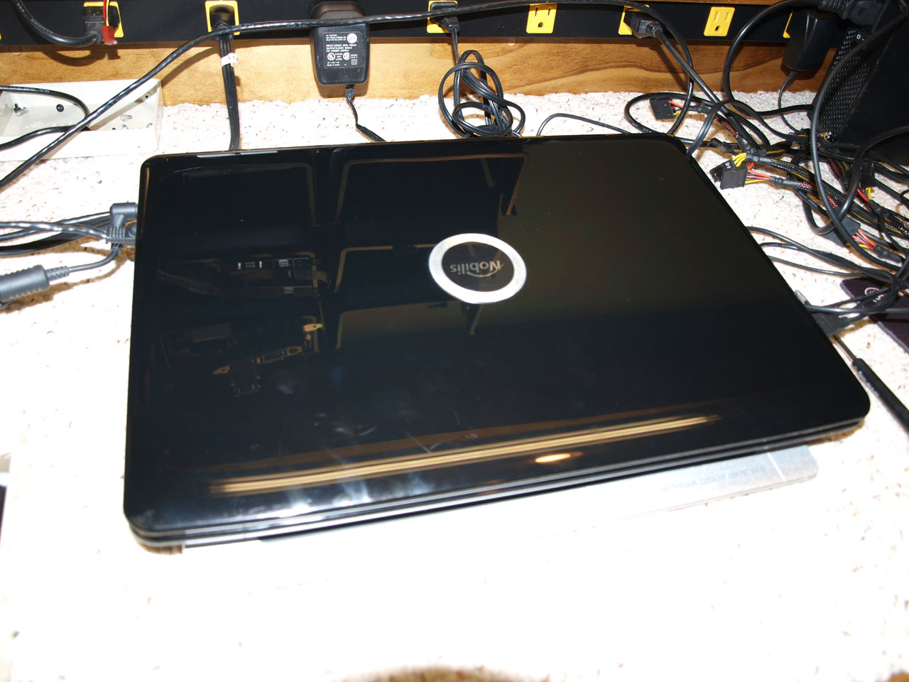

            Here's what was attached to it...these were on the bottom:
            The top.

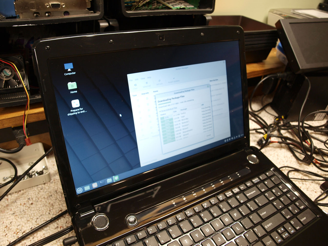

            Then test # 3. I pulled the drive and stuck another in for testing purposes. I installed Mint 20.3. The issue goes away.....so it's definitely a windows thing....but still rings out firmware glitch. On Mint, I could reboot it 'till I'm blue in the face, always came back as it should.
            Yea, leave it to me to find a weird one!

                      Just a happy ending to this issue & thread...
                      The laptop had BIOS 210 on it, I updated it to 303, and the black screen upon restart is fixed!! The seat of my pants from the original post just felt it was a firmware issue....it's now cured, and also learned the true make of this goofy laptop.
                      It's always great when I can ask my own forum for assistance, you fellas are the best!
