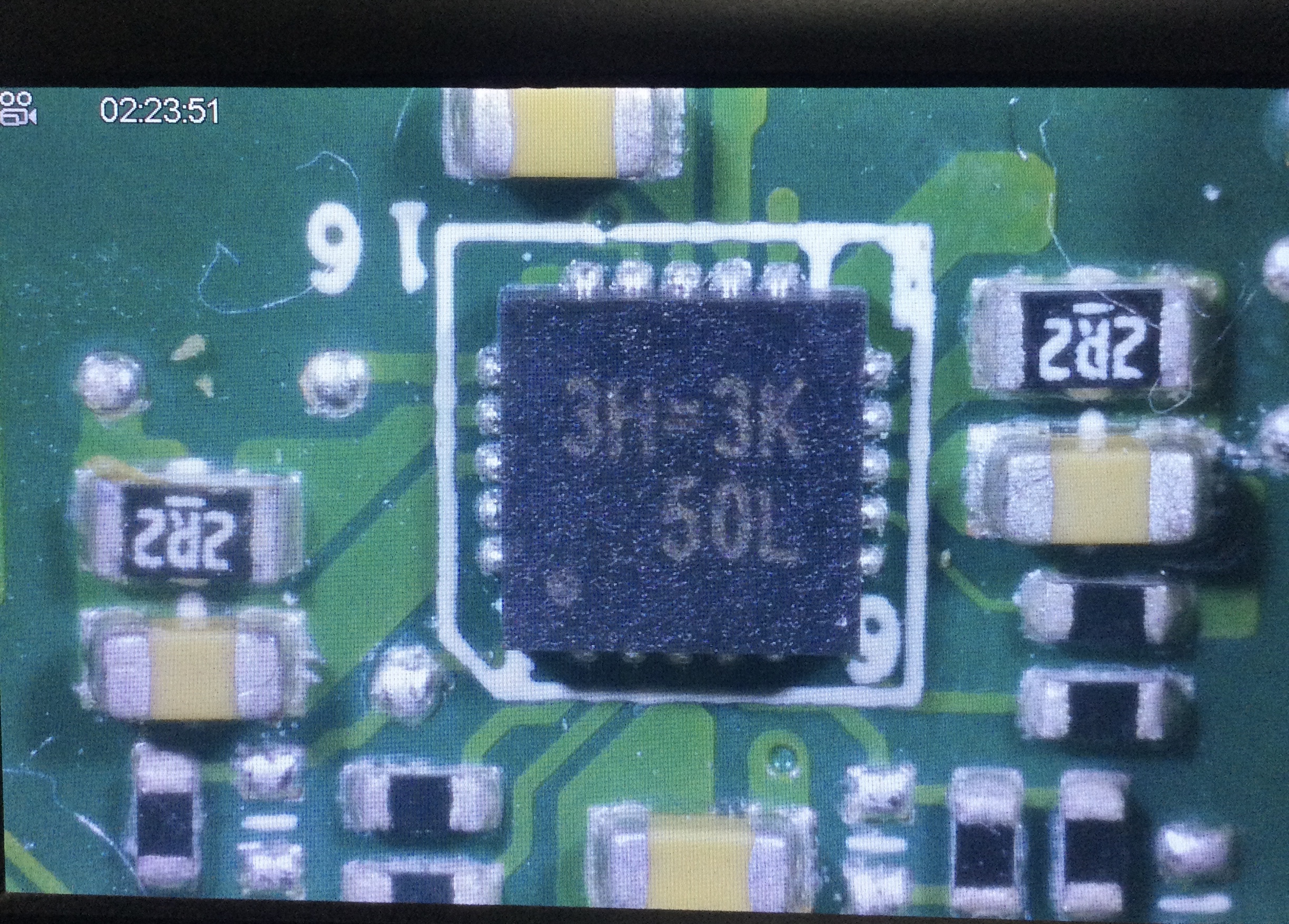

    Hi guys gooday. I need some help in identifying an IC on a Dell OEM Latitude 12 Rugged (7202) labtop. No Schematic available and the IC is making very hot. I have put a picture of the markings on the chip below. Can anyone tell me what IC name this might be? Is it a TPS 3v/5c IC or one of those Ricktek models? Wanted to buy it off aliexpress or ebay thanks.Help will be greatly appreciated.

    Hi. See attached.
    p/n RT6585BGQW

      Thanks again mon2 for this information. You are on a roll. lol
