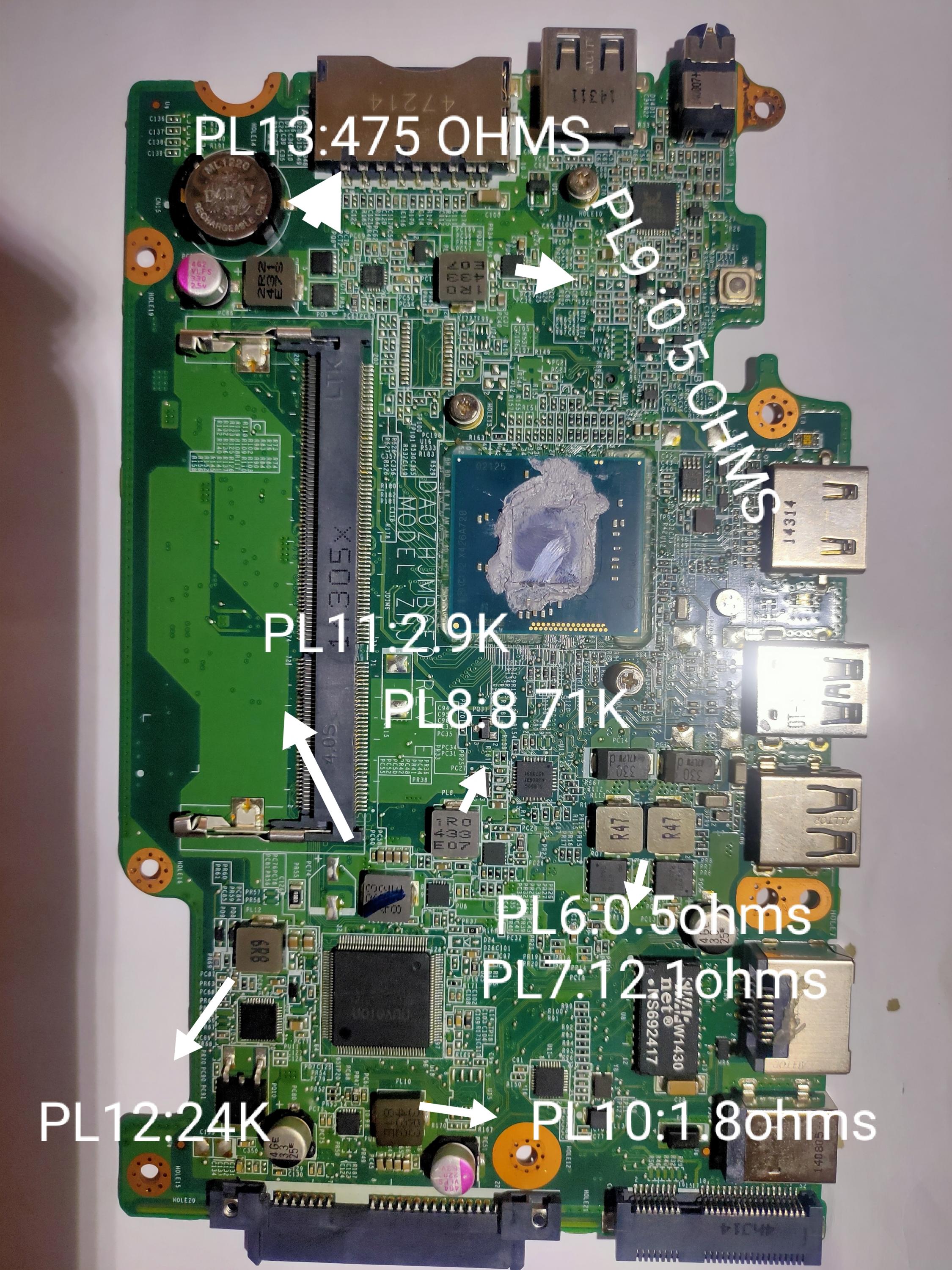

    need help..acer DAOZHJMB6E0 REV E MODEL ZHJ
    gud day ...
    i have a acer laptop board # DAOZHJMB6E0 REV E MODEL ZHJ
    3VPCU and 1.8VPCU is present when the power adaor is inserted to the jack....
    and when the power button is pressed RSMRST and S5_ON 3.3V is present
    5VS5 is missing....

    Re: need help..acer DAOZHJMB6E0 REV E MODEL ZHJ
    You need to give PU10 Pin voltage measurements.
