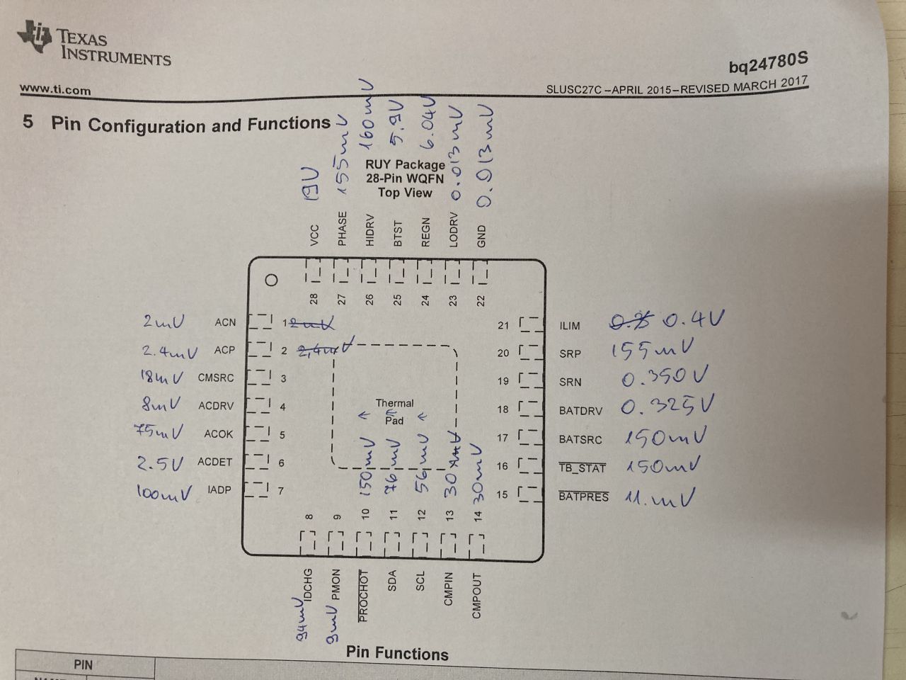

        BQ24780S

          Carefully, very carefully, measure and post the voltage readings of each pin of the charger IC. Do not short pins with the meter probe which can damage the charger IC.
          Meter in DC 20v scale.
          Red meter probe on the pin to measure, black meter probe to ground (shield is ok).
          Post the voltage readings.

            Is the charging IC still without voltage? I'll continue soon.
            • zolie
              • Jun 2015
              • 52
              • Hungary
              Re: Asus x541UV no power
              I could only measure it now.
