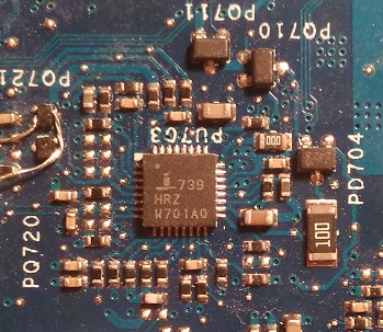

    Hello.
    Have this Acer ACER LA-H901P that have burning charger ic. not chatging 0V after first nosfet. On battery works normal.
    Anybody knows Interchnange for ISL88739A ???

    No substitute for this IC. YOu can ry same ic without suffix "A" but no other IC.

      u mean this ic?

        replaced and show charging even charging light comes on but not charging
