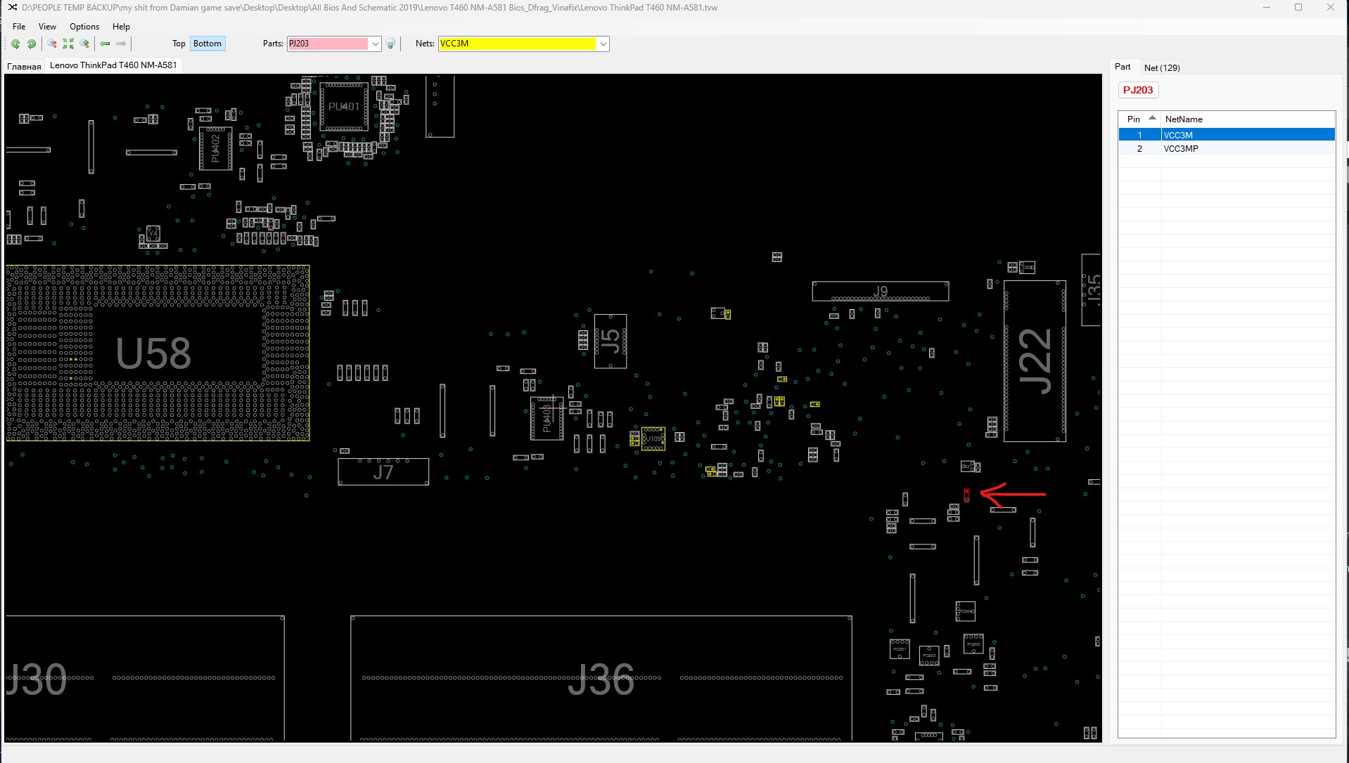

    Lenovo ThinkPad T460 when i plug the AC Adapter, the board is only for few seconds on, after that is dead, no 3 + 5V presents.
    First + second mosfets have 20v, Systemrail 20v too.
    had someone such problem? i have this problem with few Lenovo Boards, T460, T460s, X260...

    Hi my friend. I have the same board and same problem. As soon as you plug the adapter if you check with multimeter you will see that the 3v and 5v is present for 5 seconds and never comes back. But if you remove the PJ203 Pad that joins VCC3M from the 3v/5v rail directly into the CPU you will get 3v/5v voltage staying constantly. A Friend told me that it is a bad SuperIO which is common on these models that causes this. Difficult to confirm because the SuperIo is programmed and it has glue and balls under it.

      3V & 5V is supposed to be present for 5-10 seconds only after pluginng ac adapter. this is how newer mb are designed coz of Deep Sleep Well feature. These rials will come back only when you press power button.
        Re: Lenovo ThinkPad T460 NM-A581 power on only for few seconds
        Okay Yes you are right mcplslg123. When i press the power button it comes and then goes. When i press the power button i get like 3 blinks on the power button LED .But the board doesn't like turn on.
