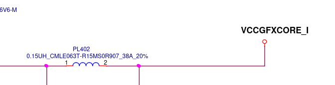

    I have lenovo laptop which has all voltages on coils except PL402 near CPU 0V. when i power on keyboard lights comes on and then off but no POST.
    I reprogram Bios but nothing.

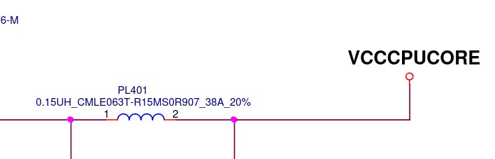

                                  i noticed on board there are 2 ic's and 2 coils for VCCGFXCORE.
                                  PL401 has output BUT pl402 has no output.
                                  PL402 resistance to ground is 0.07 OHMS (0V) and the other coils has 0.10 OHMS (1.0V)
                                  The processor is solder on board.
                                  is it a problem with BIOS or CPU. i flashed Bios but i do not no if file is good.
                                  No beeps during power on.

                                      Re: Lenovo x270 no post problem help!!
                                      Thanks Piernov for your reply
                                      i am using x270 nm-b061 rev 4.0 schematic instead of rev:1.0
                                      there are 2 NCP81382MNTXG ic's one connected to PL401 which is ok but the other
                                      ic does not send output to coil. there are no mosfets.
                                      BUT
                                      when i connected everything the laptop show LENOVO logo, i press F1 to go to setup but nothing on display.
                                      is it a problem with ic NCP81382MNTXG for pl2!
