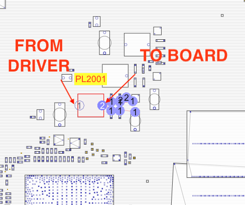

HP Omen 17-w104no dead PCH? Second opinion

    Unsolder PL2001 (3.3V coil) and measure resistance to ground at 200 ohm mode on multi-meter. do you have equipment and skills for it?

    When PL2001 will be de-attached, measure resistance to ground of +3VS5_S and SY8208BSW pins
    Also before desoldering measure all caps and resistors near PU2001 for a short. It seems that this motherboard doesn't have overcurrent protection, so PU2001 could be dead

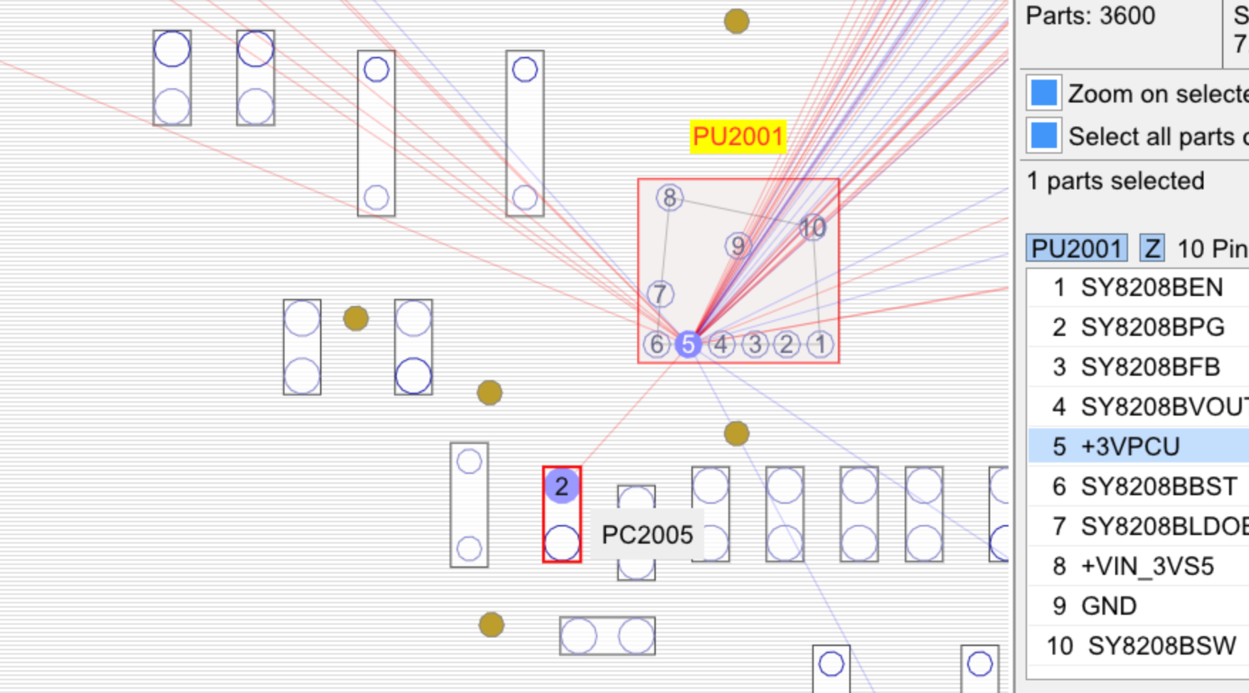

      OK I've checked these and they all seem fine, beep on the correct side etc. Also I found 3.3V on pin 5 of the PU2001 where it's supposed to be and also in some connections out from it like PC2005, see attached pic.
      Should I go ahead with the desolder of PL2001?

        Does PL2001 have 3.3v? If not, then the 3.3v driver is dead, or protection of the driver trying to protect the board because of a short somewhere onboard.
        Desolder PL2001 and by NOT powering the board, check resistance to ground of two pins (before coil - this part comes from voltage regulator driver and after coil - this goes to the board)
          Re: HP Omen 17-w104no dead PCH? Second opinion
          3.3VPCU is ldo generated voltage to power logic when laptop is not powered on. So good news - your Embed controller is alive
            Ok finally got around to it:
            From driver: ~4 MOhm
            To board: 0
                  A lot of weird suggestions here. There is obviously a low resistance reading both on the 3.3v and 1.05v switch mode coils. It's a dead PCH with almost 100% certainty. Inject 3v on the 3.3v coil and feel the PCH heat up if you want to confirm it.

                    Here's the boardview if you don't believe me
                      3V to PL2001? Must desolder before? 3v 1a is enought?
