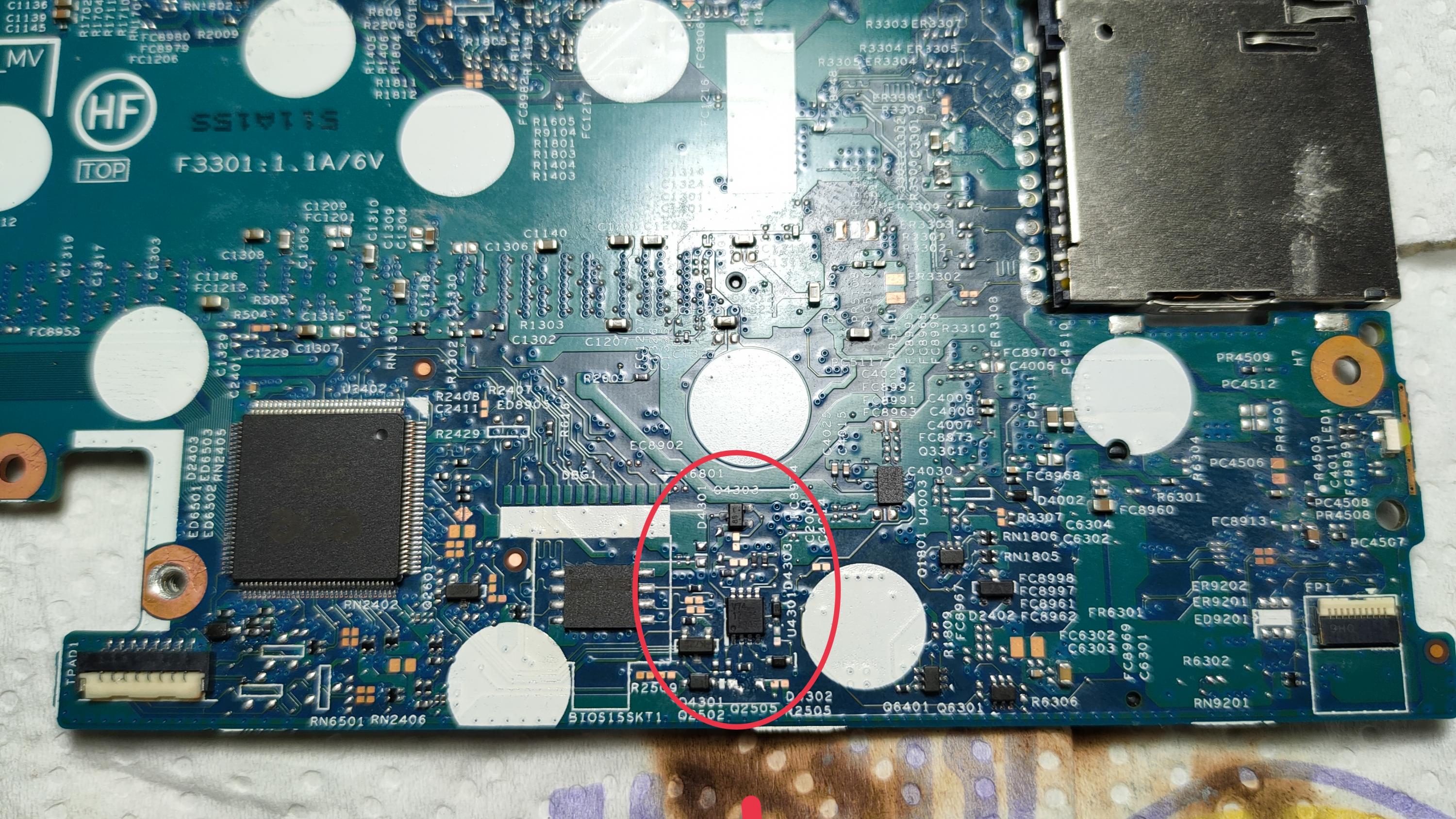

    hi all, i have this hp with faroe_dis_x32_mb_mv 18742-1 motherboard
    Virtually dead, not even the white / orange LED on the power connector lights up
    motherboard checked there is no corrosion, all mosfets are ok, there are no shorts
    I find only
    19Vcc
    ADP_ID 0.35v
    i can't find the wiring diagram
    what you can check, any suggestions are appreciated
    thank you

          the adp id signal is around 0.45v,
          i found 2 ic:
          SY8288CRAC which manages the 5v
          SY8286BRAC
          gestsce i 3v
          on SY8288c I find the 19V on pin 2345 IN,
          9v pin 11 EN2
          4.80V on pin 15 LDO (+ 5VPCU)
          on ic SY8286BRAC
          19V pin IN 2345
          9V pin 11 EN2
          0.2V pin 17 LDO (+ 3vpcu)
          replaced ic SY8286B to get + 3vpcu
          but the situation does not change, I always measure 0.2 / 0.3V
          advice?

            Re: HP Pavilion 14-DH no power no led faroe_dis_x32_mb_mv 18742-1
            i isolated the 3vpcu line from the source IC from the other components, this is connected through a 0 ohm resistor,
            now i get the 3vpcu, from the ic source side,
            this signal powers many components including diodes and kbc,
            strange thing I raised two diodes that are crossed by 3vpcu, now the led lights up I measure the charge at 12v, the button if I press the power led lights up for 10 seconds and then turns off, if I apply the diodes I lose the 3vpcu
            working diodes

              What is the resistance on both pads of that 0 ohms resistor??. One of the pad(output side) is having low resistance. U need to inject 1V on the pad showing low resistance(assuming u have a dc supply). Most likely kbc chip will heat up. Put those diodes back as applying power with missing components can be risky. However, test the diodes out of circuit before putting them back.
                Diodes are good,
                measured resistance on the pads res 0 ohm,
                side ic source
                red tip to ground I measure 130 kohm
                black tip to ground
                I measure infinity
                kbc component side pad
                red to ground I measure 8 kohm
                black to ground I measure 4kohm
                tomorrow i try to inject 1v kbc side to see how it behaves
