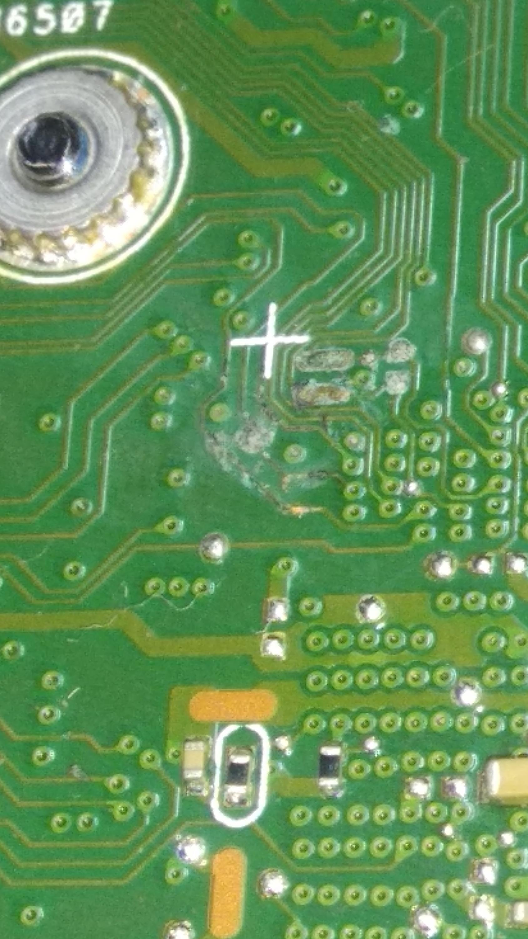

    Hi any here working on this board I need image of back of Board near cpu screw hole H6507 .
    Recived corrosive case

    This area

        Re: Asus x507ubt rev2.0 image
        The tracks are clearly visible. Just clean it, scratch a bit and check continuity. Rebuild tracks if needed. A simple usb microscope will even help.
          It's done,tracks as visible, problem 2 junction joins were there. Thanks
