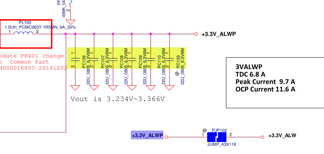

    A Dell lattitude 5480 just come from my friend. That has no sign of life even when plugged in or power button pressed.
    Found a schematic see attached.
    - Charger is on and fine when connected 19.9volt is presents
    - CPU is slowly heating up when connected to the charger
    - Checked the voltages on main rails and found that 3.3_ALWP on PL100 is 0.8 Ohm.
    I'm tempted to go straight to voltage injection but I wanted to do this the right way.
    Tomorrow I make some more measurements on PU100 pins and post the readings.

    Try the following:
    1) lift up one leg on PL100. Check the resistance to ground again on the PL100 pads. Which side is showing the very low resistance to ground ?
    Is it the producer ? (PU100)
    Is it the consumer ? (PL100, pad # 2)
    2) Locate the solder block PJP102. If present, remove the solder blob.
    Check the resistance to ground again.
    3) Suspecting that you have a bad cap in the block shown as per attached.
    Consider the above steps and even to remove the few caps mated with PL100 to find the bad (Apple? - oh the irony if this was an Apple product) seed.

          Originally posted by mon2
          Try the following:
          Removed JPJ102 and pin #2 has 0.8Ohm resistance to ground.
          I have tried to check the components that is connects to but it just too many. Any more ideas before voltage injection?

            Keep track of these mods:
            Remove blob @ PJP501. Test the resistance again after this removal. Do not power up.
            My guess is that one of the load switches that make use of this always on rail (ie. EM5209) is damaged.
            I think it is safe to try voltage injection at this time but consider to use 0v8 for starters. The risk is that some short downstream may not like higher voltages and cause some serious damage to the CPU, etc. The load switches are handling some heavy currents so my bet is on one of them being the bad boy.
            Sheet # 4 of the schematics show the location of the EM5209 devices.
            You could throw some alcohol onto the EM5209 devices and then perform the injection and look for the misting of the alcohol.
            If you do proceed, update this thread for future readers with your feedback and repair status.
