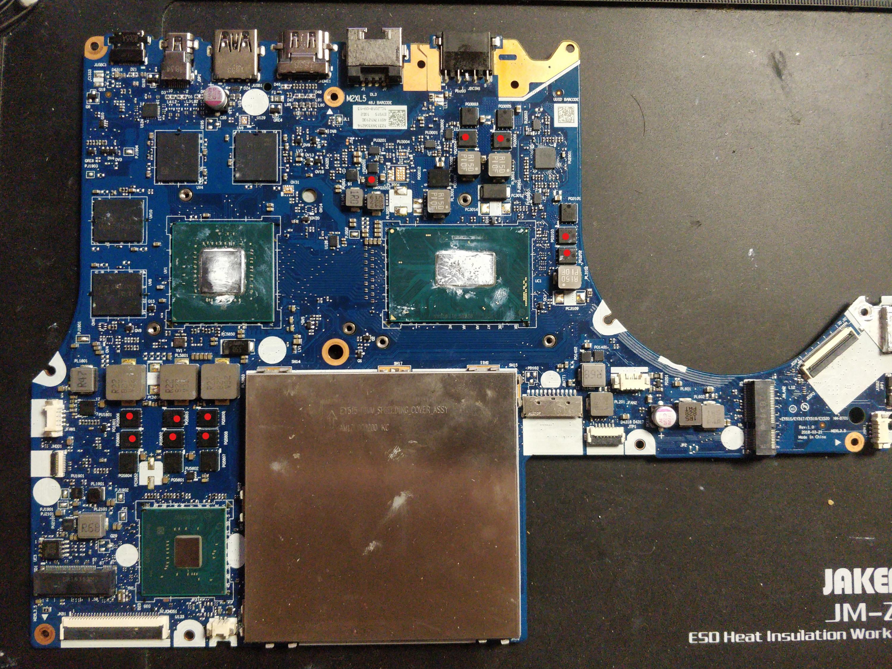

    I have a Lenovo Y530 (NM-B701 rev1) notebook with a frustrating problem.
    It's shuts iftself off after pressing the power button. I have no POST screen, only power led and keyboard light. Same symphtomes on AC and on Battery.
    Things I tried:
    - General cleaning and repasting, reseating RAM modules
    - Reset CMOS
    - Reprogram BIOS with a programmer.
    - Checking main rails with Multimeter.
    Only suspicious thing I found was that the dual MOSFET on the 20V rail had 25.5V, so I replaced this two mosfets with new ones, but the 26.5V is still there.
    Could it be the culprit?

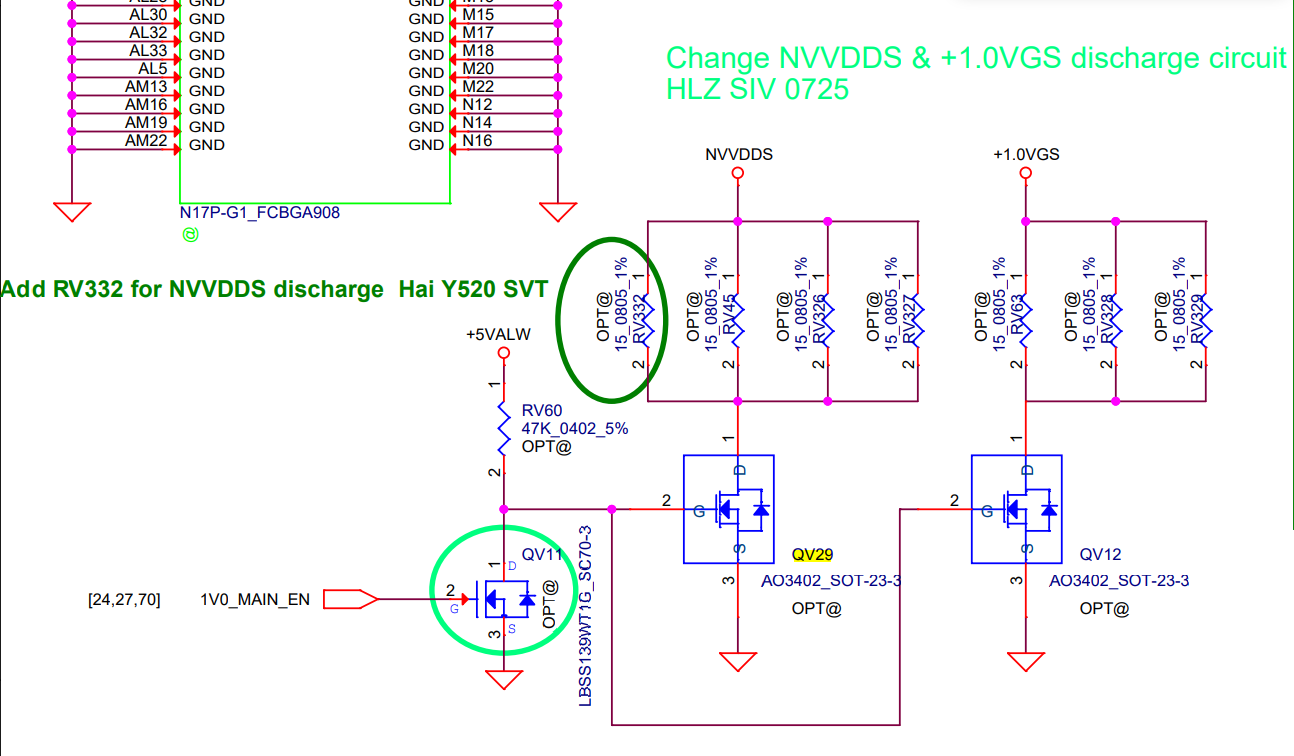

        So I tested the MOSFETs and I found something fishy on the +5VALW circuit.
        There are 3 MOSFET on this line named QV11, QV29 and QV12:
        QV11 - LBSS139WT1G - N-Channel
        QV29 - AO3402_SOT-23-3 - N-Channel
        QV12 - AO3402_SOT-23-3 - N-Channel
        I tested these MOSFETs by setting my MM in diode mode and I measured S (red probe) to D (black probe) then reversing the probes.
        First valuer is Red on S Black on D second is reversed.
        QV29: 0.010V / 0.010V
        QV12: 0.273V / 0.510V
        QV11: 0.518V / OL
        QV29 and 12 looks faulty since shouldn't it read openloop on reversed polarity like on QV11?
        I attached a photo of the parts and the circuit.
        I really hope I'm on the right track finally.

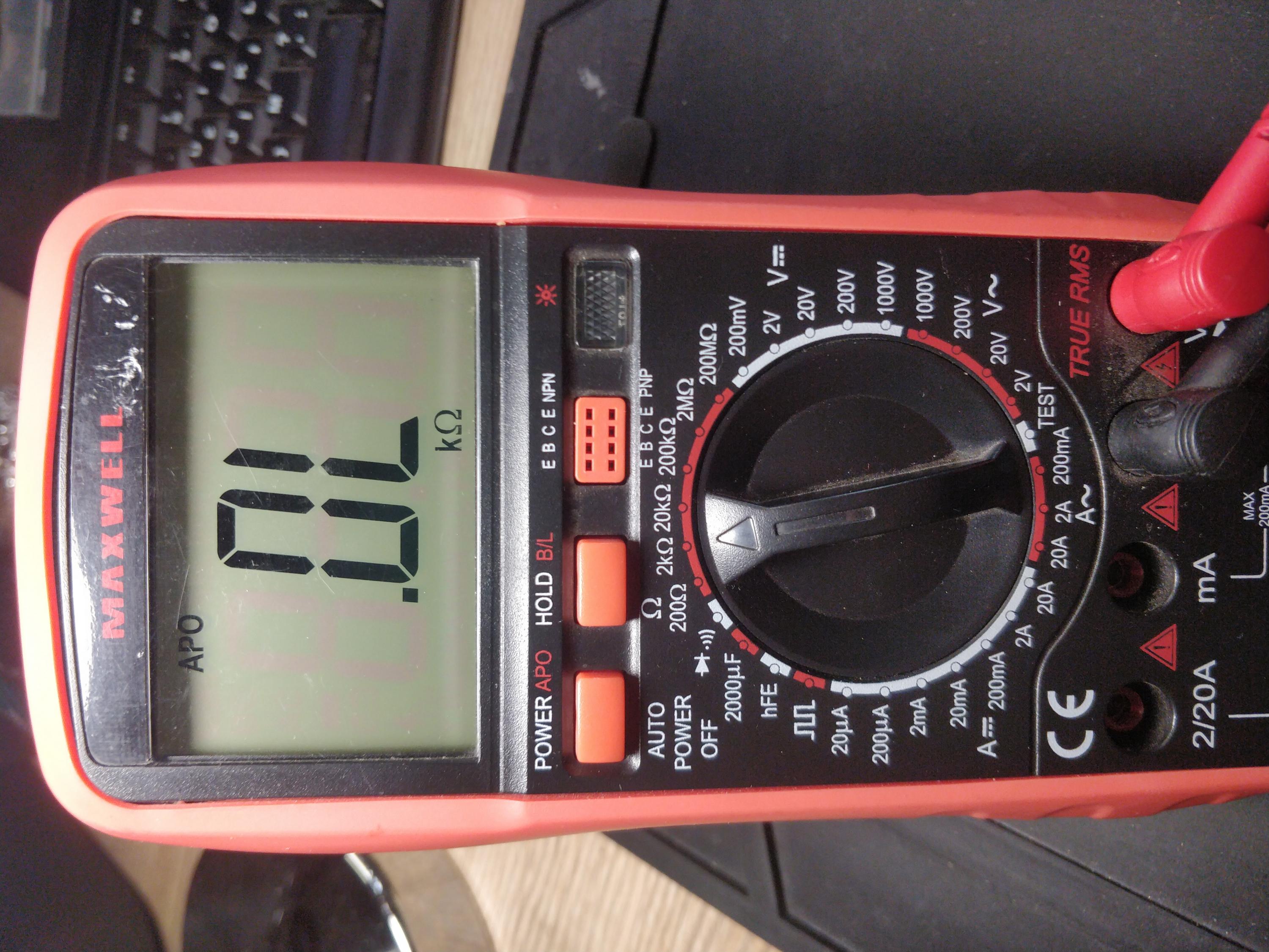

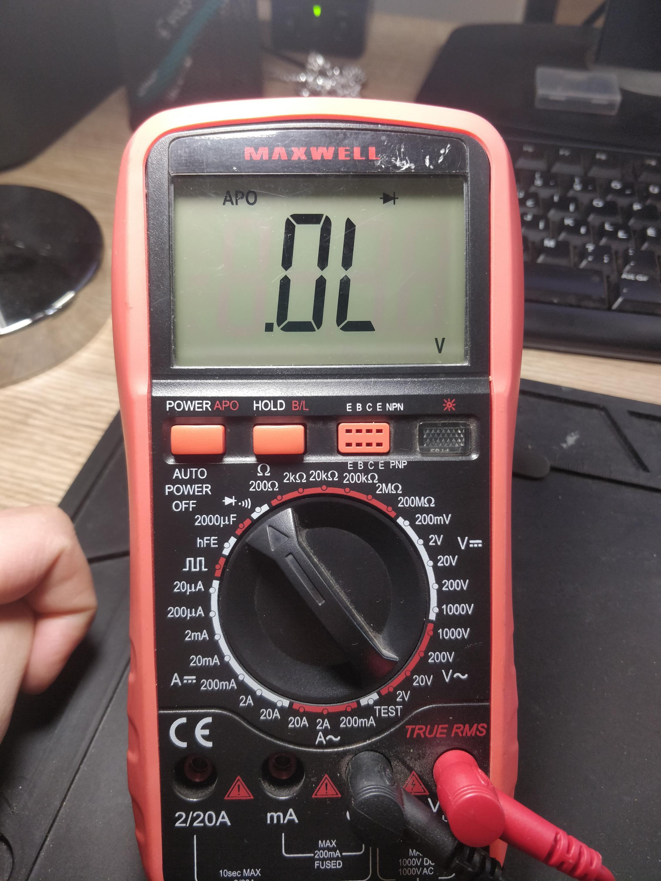

                      What are the settings for your multimeter for these tests ?
                      Can you post a pic of the multimeter ?
                      • unimatrix93
                        • Oct 2021
                        • 343
                        • Magyarország
                        Re: Lenovo Y530 shuts off after few seconds
                        Sure take a look
                        Resistance set to 2kOhm as you recommended:
                        Diode mode:
                        Continuity mode:
                        • mon2
                          • Dec 2019
                          • 14148
                          Ok - that makes much more sense. The OL means 'over limit' - not 0 ohms.
                          OL means that it is now ok to select a higher scale till you have a proper reading. Please do this and post the values.
                          This also means, as noted by @Piernov, that the mosfets are most likely OK
                          Please post again with a higher scale on your multimeter.

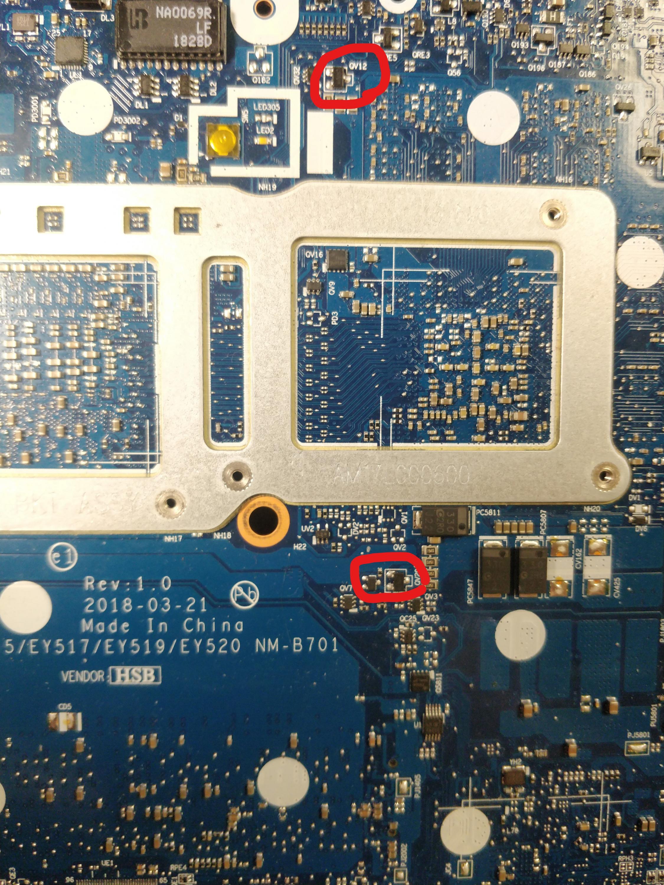

                                        Another Update
                                        I was checking the mosfets around the CPU and GPU and I found shorts on these devices:
                                        All of them has:
                                        S to D
                                        D to Ground
                                        S to Ground
                                        Resistance is very low between S - D and between S to Gound and S to Drain too.
                                        Only the mosfets that are placed horizontally have these values.
