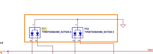

    Using the schematic found here https://www.badcaps.net/forum/showthread.php?t=97207 using page 46 as reference, I have taken the following measurements:-

    The issue is as soon as I connect the adapter PD1 blows.
    All measurments have been taken with PD1 removed.
    I have removed PQ1 and PR3 thus issolating PD1 from the rest of the circuit and it has still blown. So my thinking is there is a short between Pin 3 on PJPDC1 and Pin 2 of PD1 with the idea that PD1 is where the short is. Pin 1 goes to gnd, Pin 3 is N/C. Given that PD1 is burning out would say to me that the short goes across Pin 2 to Pin 1. 7 diodes later and I am no closer to finding the short. Law of averages will show that it cant be 3 different adapters causing the same issue.

    Hi. Which diode are you placing @ PD1 that keeps blowing ? Please share the p/n & vendor or post the datasheet.

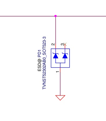

      Re: Dell Inspiron 15 5575 LA-F121p
      The details are from Page 46 of the above mentioned schmematic for pic 1 and I have used the ones from a LA-9431 PD1 & 2 as defined by the schematic for it page 41 in pic 2.
