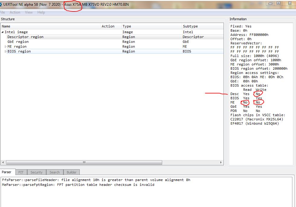

        The reason i asked for the barcode sticker is to try and ID which bios version you need.The motherboard will be silkscreened with a part number,the laptop itself has a model number on the case ,and the motherboard can have a barcode sticker or QR code with a model number.All 3 can be different part number ,see this thread - https://www.badcaps.net/forum/showthread.php?t=96604 .Its the model number on the barcode sticker that ID`s which bios it shipped with.
        A modern intel bios is split into different parts, and each part can be locked from reading/writing ,see the attached picture of an X75VD bios opened with UEFITool .The flash descriptor write and ME region are both locked from writing,software tools can`t read the whole bios,so you can`t backup the whole thing.There are a few workarounds that could work on older machines, theres a pin on the audio chip that can be shorted to unlock the flash descriptor , and another using the bios update software and grub. They`re all too much farting about though,its much easier if you use an SPI programmer ,with a SOP8 clip to backup the bios.

          Welp, pretty much had to resort to buying a CH341A. I managed to brick the laptop trying to downgrade to the first BIOS released (303 I think), so I had to program externally (no, not even the clip was useful - I wasn't getting the chip recognised with it at all. Had to use a SOP 8 socket (the one with springs), and could get the chip to flash correctly through Colibri. Both AsProgrammer and CH341A's flasher would not write the chip correctly for whatever reason, while Colibri flashed it and compared against the original fine and it worked.
