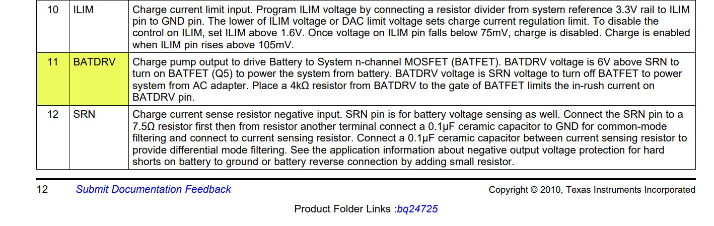

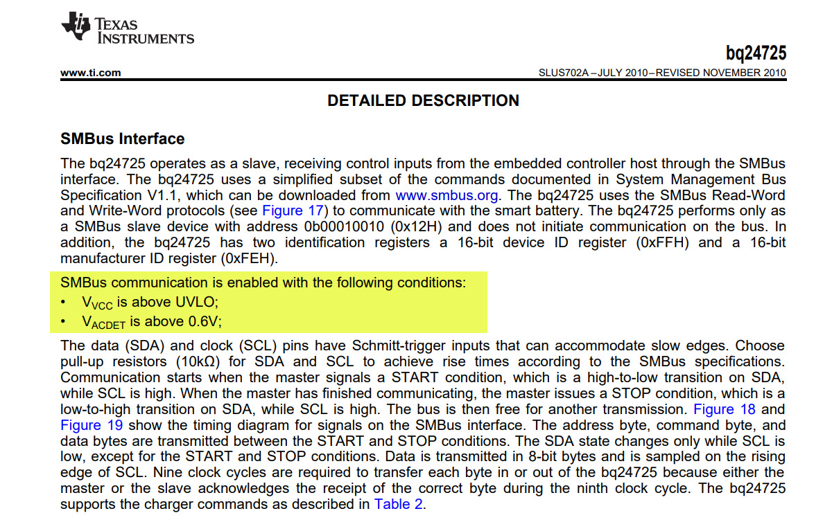

        From the posted voltage readings, the conditions should be met to enable the SMBUS communications.
        Any sign of corrosion or liquid damage? Consider to flux the PU1 device and apply enough heat to reflow the part. Make it 'dance' as Louis says in his videos. Just be careful to not blow away any support tiny SMD parts.
        The same SMBUS connections for the battery are common to communicate with PU1 so it should work if the host is initiating dialog with the slave ID of 0x12 (according to the TI datasheet).
        The voltages look good except for pin 11 & 12.
        To turn the battery mosfet @ PQ8 ON, the gate voltage (BATDRV) must be 6 volts above the SRN pin. See attached from the datasheet.
        Connect the battery - leave out the ac adapter. What are the voltage readings of PQ8 mosfet ? Is the gate truly 6 volts higher than the SRN pin of the PU1 charger IC ? Only then, the battery should power the logic board.
        Also, confirm the values of the series current sense resistors linked to the battery on SRN & SRP pins of PU1. Are they indeed matching the schematic values ?

          As far as I can see, no sign of traffic directed to the charging IC slave (address 0x12 write, 0x13 Read), whether from the Host or from the Battery acting as master (ยง6 of SMBUS data specification), however long I wait.
          Smart Battery Master Functions
          Master Functions Code Access Data
          ChargingCurrent (to Smart Battery Charger) 0x14 w mA
          ChargingVoltage (to Smart Battery Charger) 0x15 w mV
          Those function codes 0x14 and 0x15 are indeed exchanged on the bus with suitable values, but with the slave adress 0x16 / 0x17 which correspond to the battery (?)

          BAT_DRV looks low (~SRN/SRP) as I suppose PU1 disconnected the battery from the system, which is powered from the AC adapter (even though Windows says otherwise...), as B+ is at 19,3V. Hence no current is flowing in (from the charger) or out of (to the system) the battery - which happens to be what the Battery says on SMBUS.
          Now when the AC adapter is disconnected (and system off) I have the following readings:
          [11] BAT_DRV 17V
          [12] SRN 11V
          [13] SRP 11V

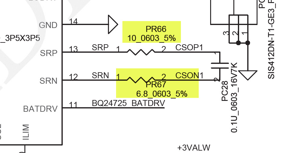

          and 11V on either side of the PQ8 mosfet hence on B+
          PR66 and PR67 read respectively 10,3 and 7 ohm which seems to match the schematic
