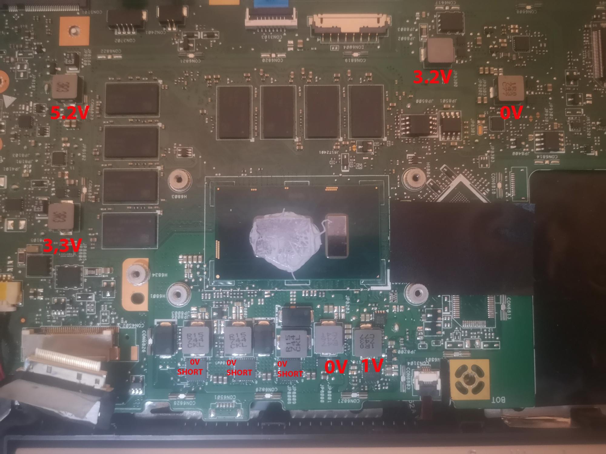

    i face a problem with that laptop. The laptop dosnt power up. when i insert 19v a blue led stays solid, pressing the power up button and nothing happens. I make the reset method and still nothing. I disconnect the battery the same. So according previous post i took measurments on the board. I am attaching the photo with the measurments. i noticed that 3 conductors are shorted to ground and this may be the problem. If anyone can help to find the short , or to give me some advice on how to find it , i would be grateful.

    how much ohms, these coils are on cpu core rails and shorted regulary?

      Re: Acer Swift 3 SF314-51 no power up -shorted inductors
      I measure 0 ohms. I downloaded the schematic but I am not so familiar. Maybe they are cpu core rails.
        0.0 ohms between coil and ground? desolder coils and/or mosfets and measure again on cpu AND mosfet side
          No my bad. The resistances are 7 ohm, 10 ohm and 7 ohm at the point That voltaze is zero. The other coils have bigger resistances. I measured the two mosfet of DC input. Both of them have source and drain at 19v and gates 24v.
            resistance sounds good. you have to check the core enable signals via schematics. maybe you should desolder those mosfets and check resistance between gate-source, drain-source, drain-gate. often pch has logical error, maybe ram is bad or there are missing enable signals. show me schematics please (upload). check the power block and data-clock tables and reconsider them by measurements. often there is an overview which power rail is enabled by which ic and vice versa etc.

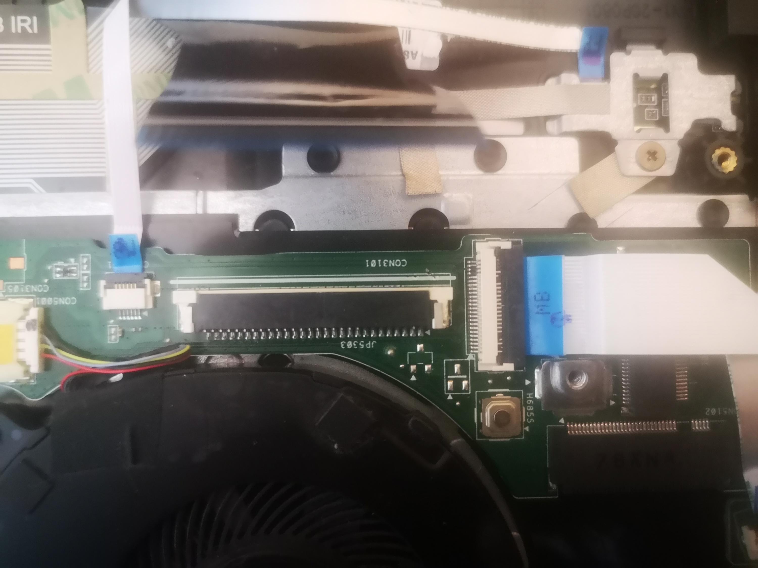

                      one advice: acer machines have the power button integrated in the keyboard... these often go bad. try to power up the machine via tweezers or did you already? sheet 31. short PWR_SW# with ground and take a look. also measure PWR_SW# and post reading
                        OK, well according to schematic we have problem. The con3101 at pin 27 without the ribbon has 200milivolt. I shorted to ground nothing. Pin 1 3.3volt. Pin 2 ground. Pin 3-10 3.3v pin 11 - 26 0v pin 28 0v
                          are you sure you shorted long enough? try without battery and disconnect cmos battery. disconnect everything except screen. don‘t get confused with left and right side of the connector
                            Pin no. 1 is on the right?? As we see the picture??
                              ok, that means we are missing +3va. just give me a moment
                                the arrow is indicating pin 1, thats fine
                                  OK so the measurements Tha I posted are right!
                                    check TPS51225CRUKR-voltages, +3 va +5 vao and generated singals +3 vs +5 vs (i doubt they are present but check), check susc#_pwr, vsus_on, force_off_pwr and sus_pwrg. refer to power table page 94
                                      mainly check all signals for 3V/5v-regulator. especially the enable signals, page 81
                                        OK so from the measurements I took we have problem with the TPS51225CRUKR. And in the try to measure again I made a short and now the chip is dead some pins. I checked for the chip but is unavailable at ti and mouser. Any suggestions?
