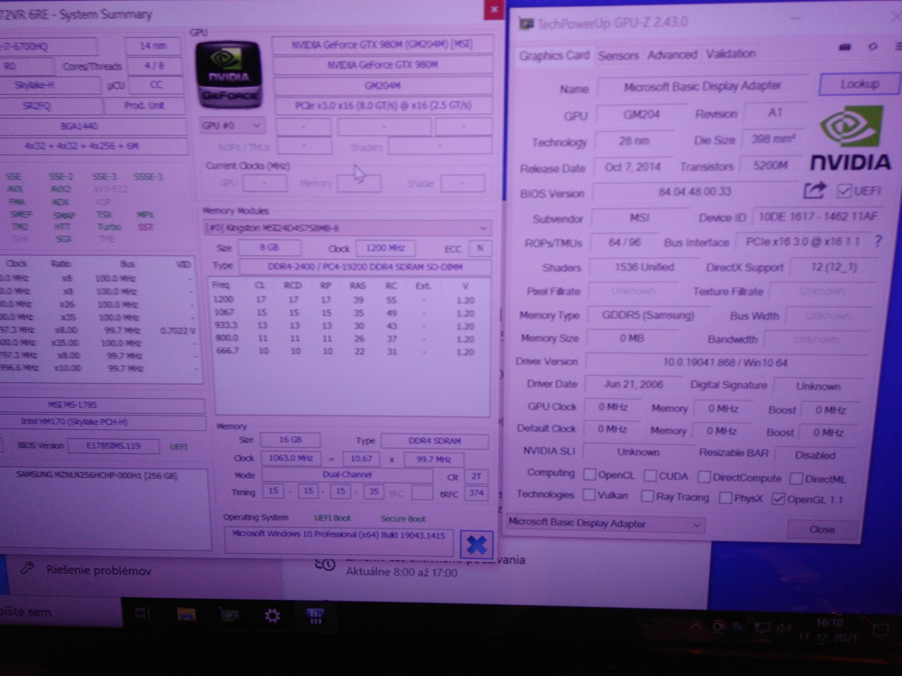

    Hello.
    I have this MSI GT72 ms-1782 that not detect MXM GPU after GPU phase shortage
    I remove one of three dualmosfets to remove the short and replace bad mosfet who swithes 19V to card. card is in MXM slot.
    on this board card is not detected, but when i put card to ms-1785 it detects it but not work ok/see picture/
    i try to put working gtx1070 to this board but it not detect it. so there must be something bad on this board and something on card.
    with any mxm card it start all voltages on card is present but it will three time restart and put voltage on card down
    anybody knows what is needed on mxm slot to have it working?
