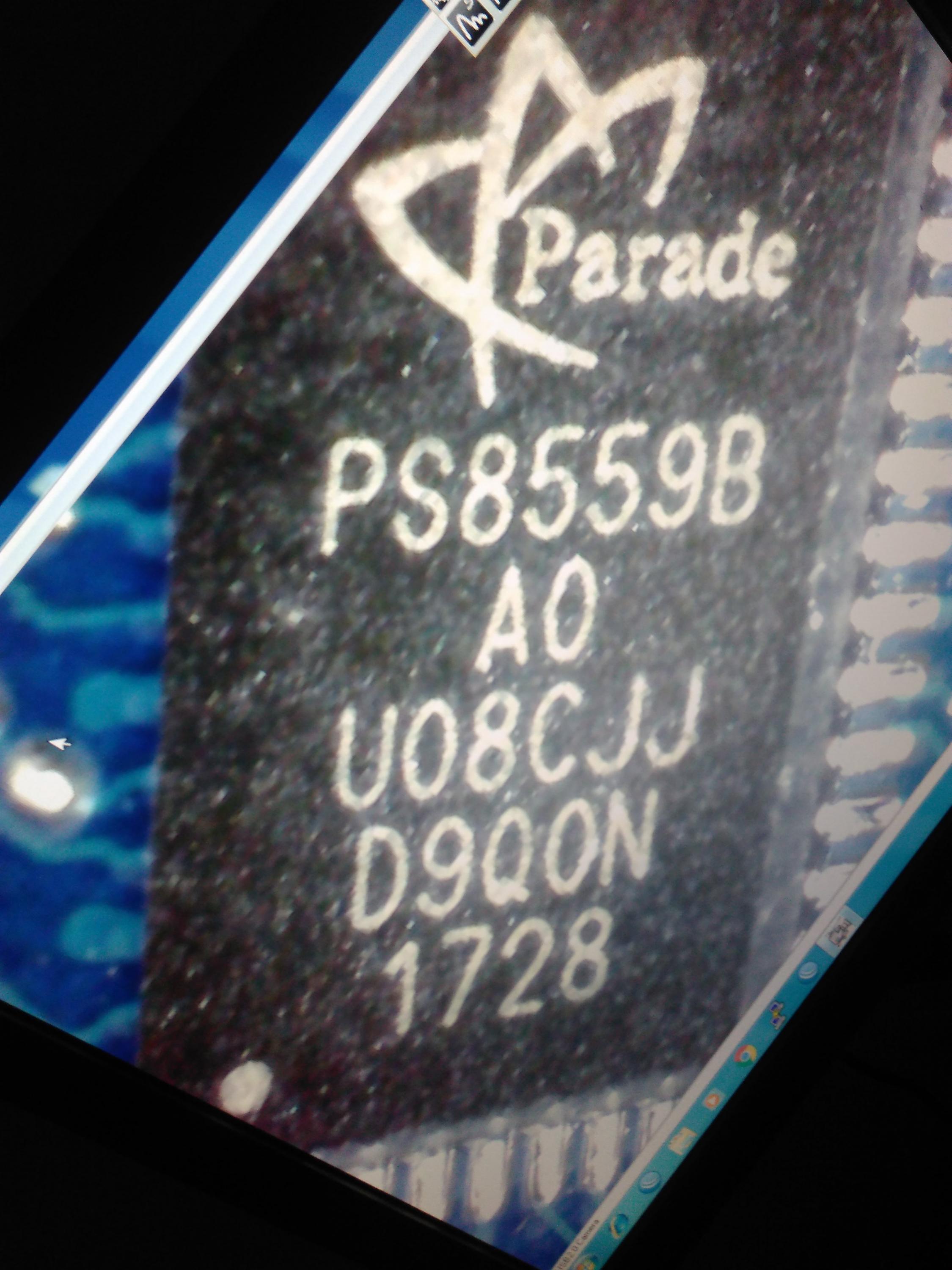

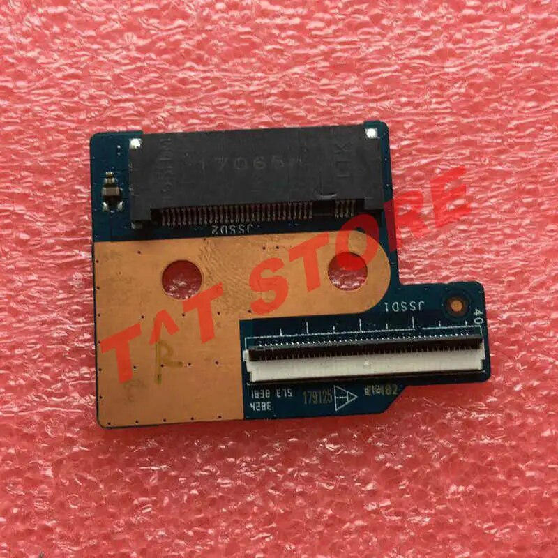

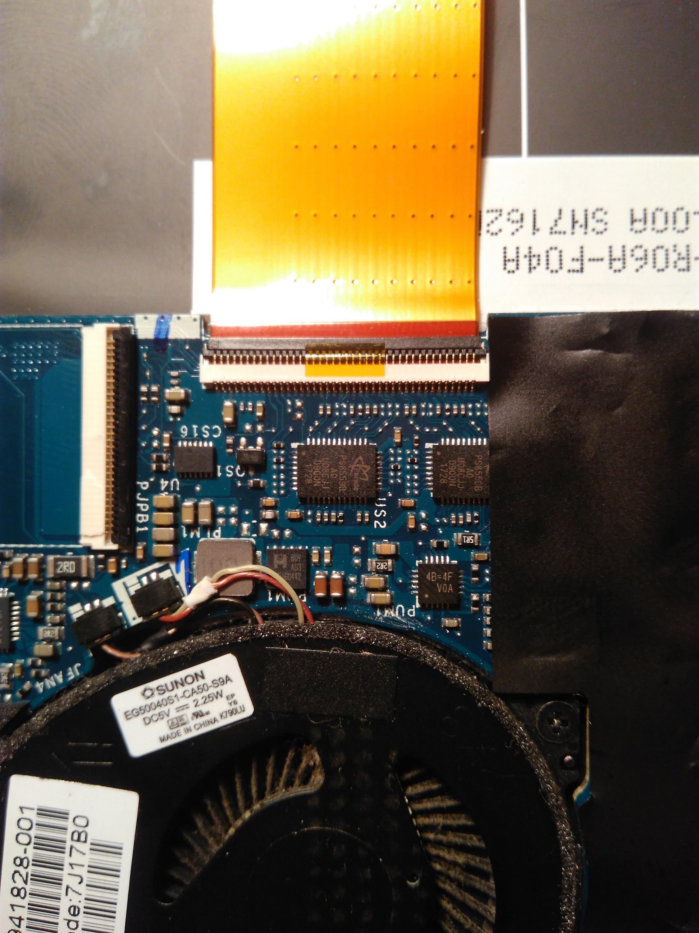

    Hello.
    I have this HP x360 La-F013P not detecting NVMe disc
    i measure voltages on it, but not detecting. i try to swap vith another disc but still the same
    SSD is under touchpad connected by flex with board. o ic on converter board and all looks mint.
    or have anybody some schema of m.2 nvme connector?

    Re: hp x360 La-F013P not detecting NVMe disc
    They report on Vinafix that this has been found to be a faulty flex cable for the SSD. So try swapping that out.
      i control the whole cable and it is in mint condition. maybe i should do resistance check on it
          Finally I solved my problem. It was not a bad connection on the sata cable but a bad soldering of the connector on the small electronic disk connection card.
