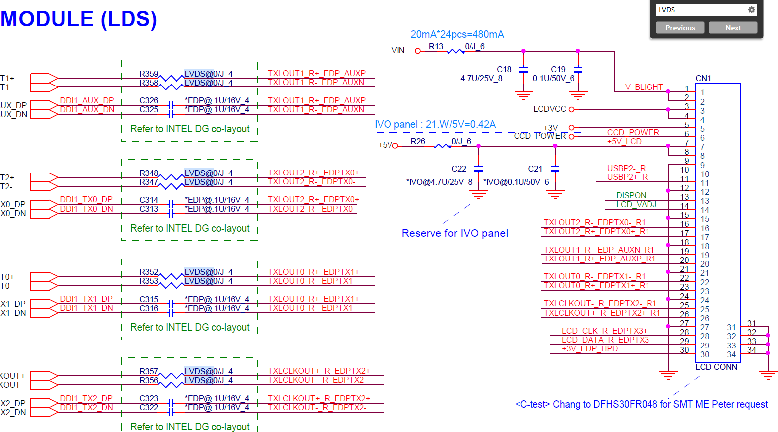

    I have Packard Bell - DA0ZE7MB6D0 - that have all voltages and signals, but no video. i go through schematic where is starting diagram. all works but stil no video

    1) Check and post the voltages on CN1 (LVDS connector).
    2) Be sure that none of the series caps on the LVDS interconnect are not missing.
    3) Do you see a backlight on for the display panel ? If not, the display is not enabled or the backlight voltage is not high enough.
    Post the voltages on CN1 for at least:
    a) Pins 1&2 V_BLIGHT
    b) Pin 6 CCD_POWER
    c) Pin 7&8 +5V_LCD
    d) Pin 13 DISPON
    e) Pin 14 LCD_VADJ
    4) Is the display that you are testing a known good display? Is it the proper and compatible one for this logic board ? The schematic notes EDP and LVDS style of display can be supported by this design - which one do you have?
    Can you post the markings on your display ?
