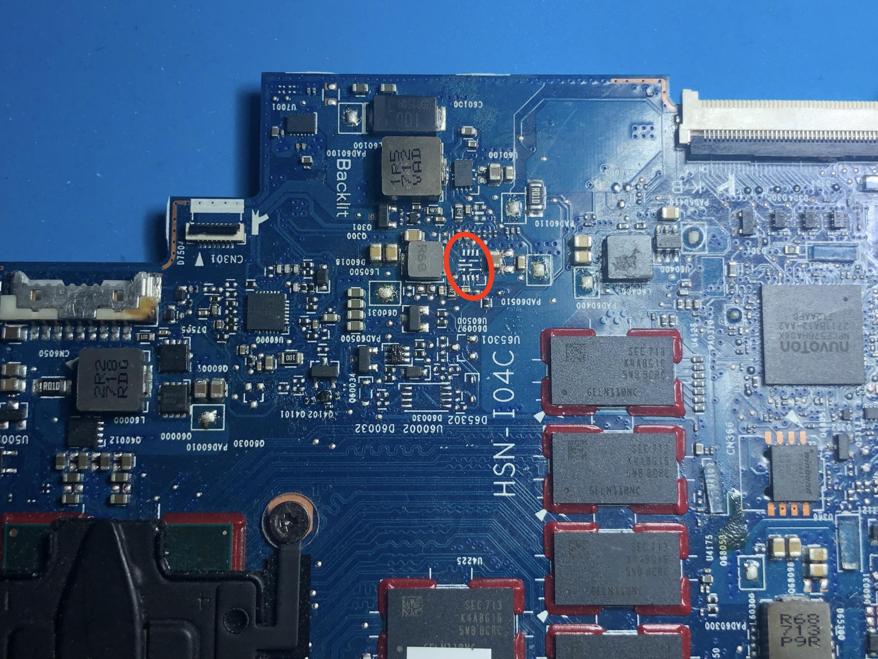

Unknown ic hp eliteBook x360 1030 G2 OLDMAN-6050A2848001-MB-A01
  • xocao
    • Sep 2021
    • 10
    • andorra
    Plz someone knows what chip is at this location.
    Thanks in advance
  • Fuzer
    • Jun 2015
    • 11
    • Portugal
    Re: Unknown ic hp eliteBook x360 1030 G2 OLDMAN-6050A2848001-MB-A01
    I there
    That component is very tiny but i think it has the following inscription on top:
    AKVH
    949
    I think that is the correct inscription.
    Compliments
    Fuzer
    • WesleyChishakwe
      • Mar 2024
      • 5
      • Zimbabwe
      Thanks in advance
      Hi, the one on my board is labelled
      "AKVH 158"
      • mon2
        • Dec 2019
        • 13830
        MPS # NB681GD
        NB681.pdf
        • WesleyChishakwe
          • Mar 2024
          • 5
          • Zimbabwe
          Originally posted by mon2
          MPS # NB681GD
          [ATTACH]n3642210[/ATTACH]
          thank you mon2. Thanks to you, I now know that mine is shorted
