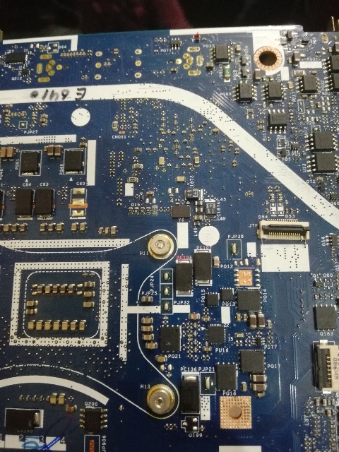

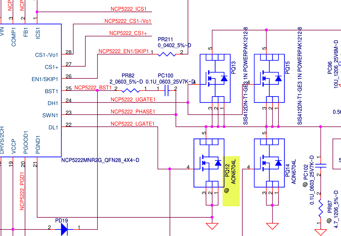

      Moreover PQ12 seems to be missing, is it OK or not?

        PQ12 in the schematic is marked with a '@' prefix which often means DO NOT STUFF during the PCB assembly process. So I think you are ok with this part missing.
        Based on your details, believe that the bios should be reflashed but personally do not have experience in this area. Wait on additional feedback.

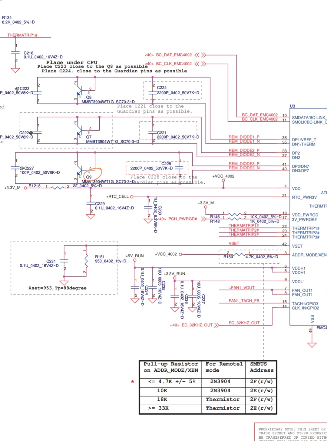

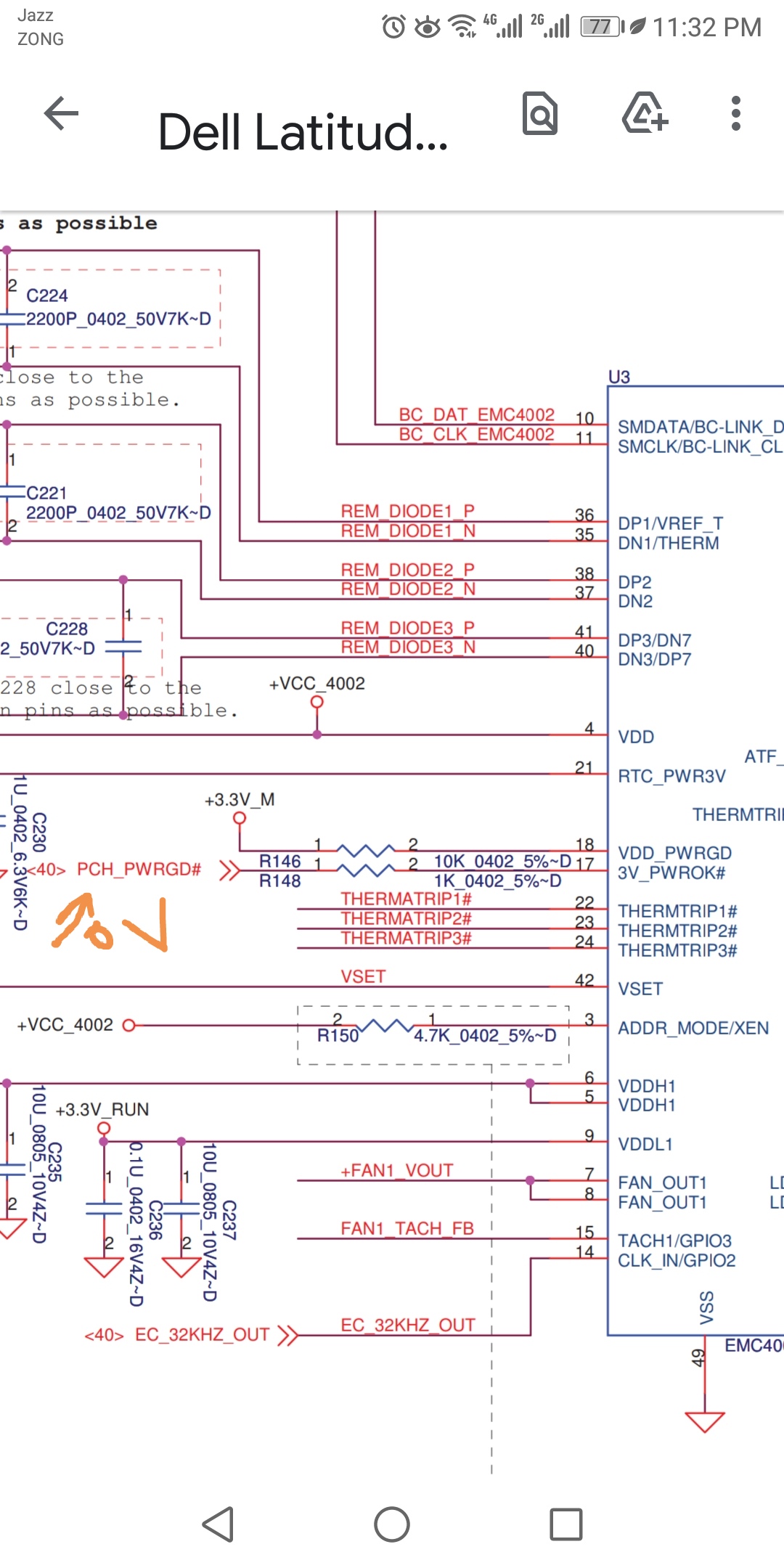

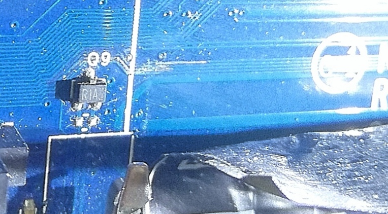

            I checked and found this transistor, Q9, short (2 pin beep), pic attached
            2ndly, tracks seems to be looking like this, what should we do in this scenario.
            Moreover, for knowledge purpose in the attached pic, I got about 0 volt on pin
            17 of U3 (ic of fan and thermal sensor)
            Should not PCH_PWRGD# indicate 0 means # or low but m getting about 3.3 on this pin?

              Any body, if I remove Q9 should I replace it or just jumper or no issue if I left it open
