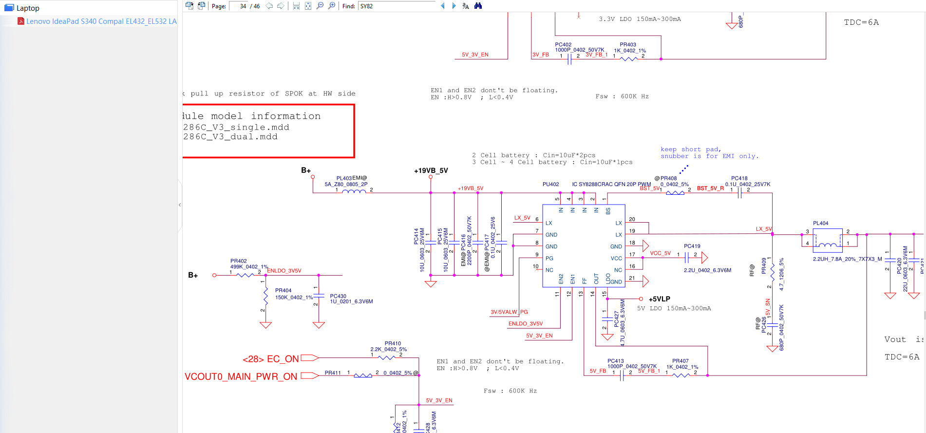

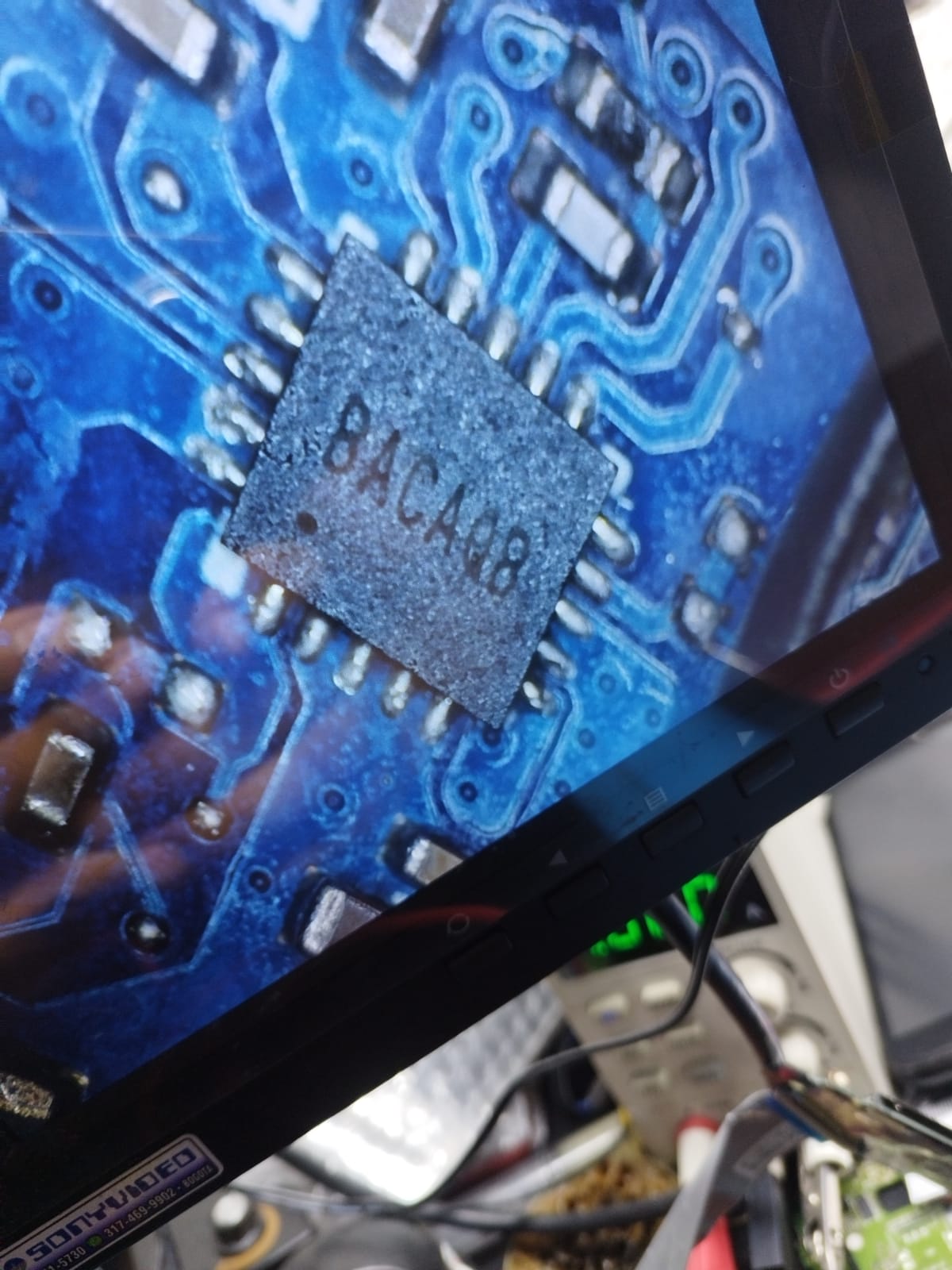

I need this reference of this ic please

I need the reference of this ic please

See attached.

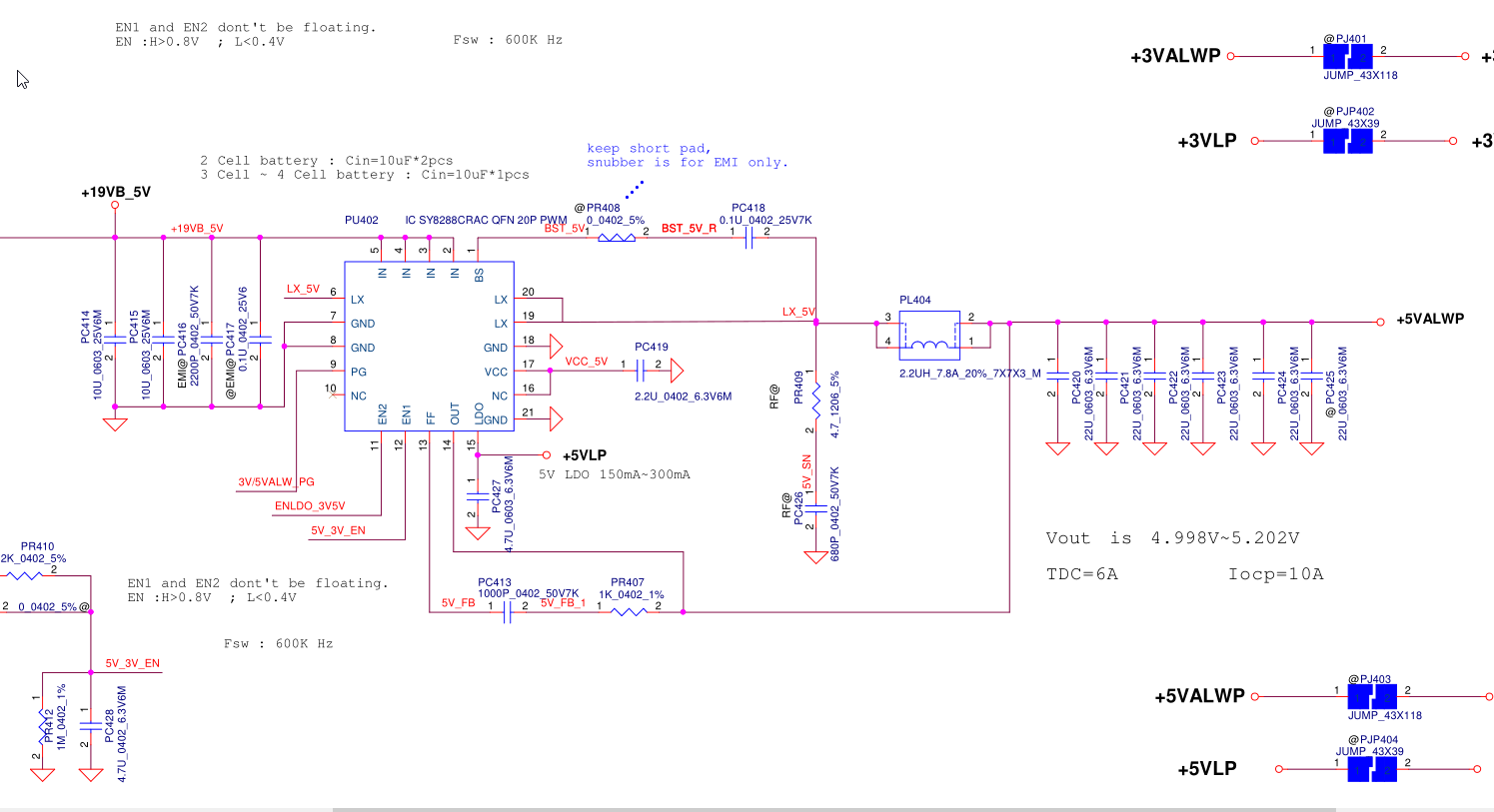

Lenovo s340 15IIL FL5C5/FL535/L435 LA-H103P REV 1.0 pl 401 there is no coil here can you tell me the ohm

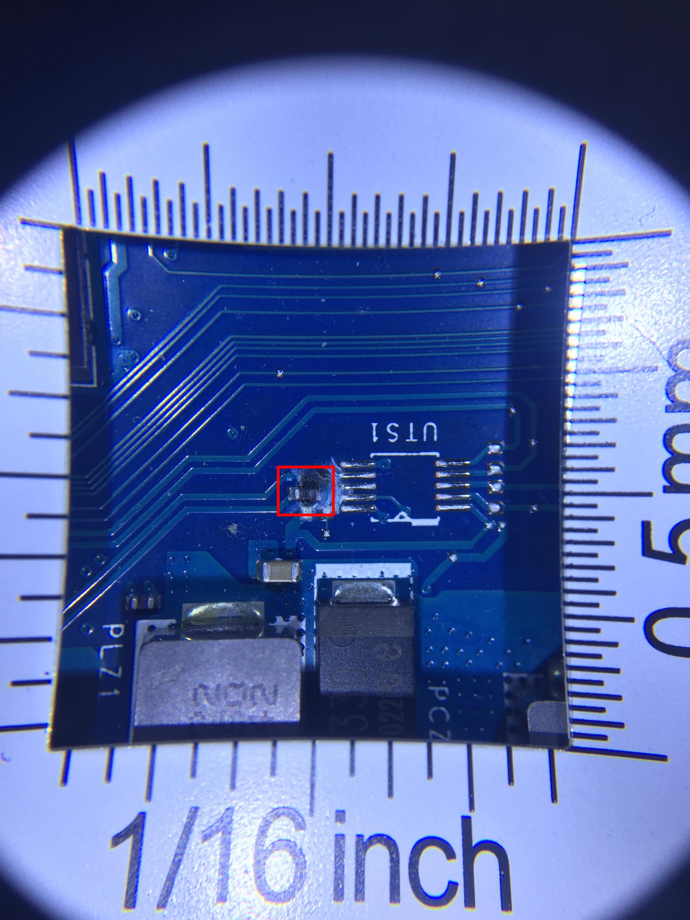

Dear all,
Could someone please help me to identify the value of capacitor located near UTS1 location (which should be empty). I'm attaching a photo:
Thanks a lot && Kind regards.

I mean this one:
