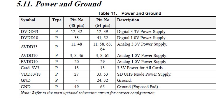

    I measured the voltages on the IC controller RTL8411b. Voltages missing in pins 27 and 13.

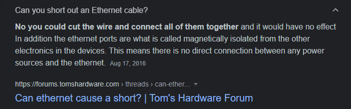

    1) Very surprised that the USB key inserting into the RJ45 caused this fault. The RJ45 is essentially a transformer and is isolated from the 'hot' voltages of the LAN interface. That is, you could short all of the RJ45 pins together without an issue.
    See attached.

      the LAn IC was changed by a new one bought from aliexpress. the orientation has been respected and the ground also, because most of the voltages are present except the power supply of the sd card and the VDD33 / 18 (please correct me if I'm wrong).

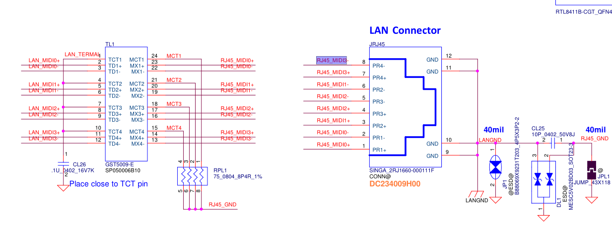

      Schematic -> https://www.badcaps.net/forum/showthread.php?t=123071

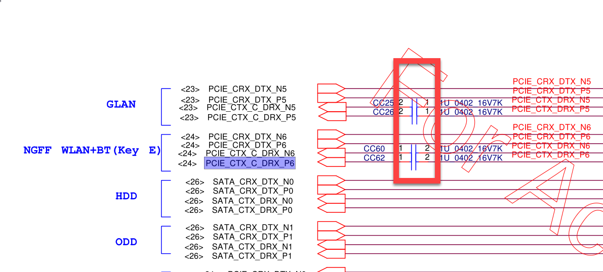

                Both, the wireless adapter & LAN are PCIe devices.

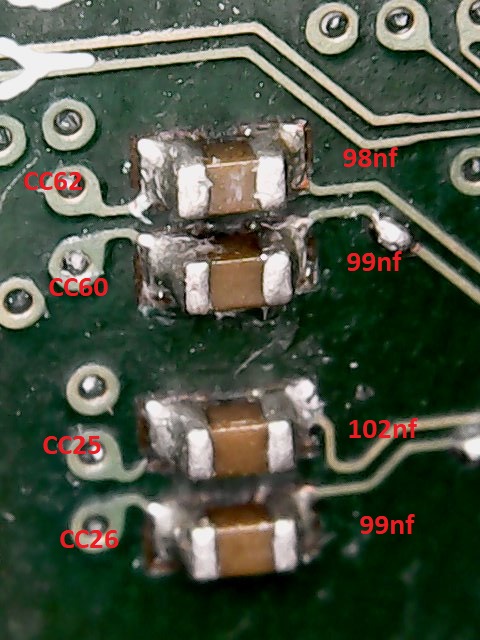

                Confirm that the attached caps are present on your board. They CANNOT be shorted or missing. Both cases will cause the observed faults.
                Consider to flux and reflow each of these caps but do so with ample flux, high heat but low air pressure so that they do not go flying of the logic board.

                  I haven't reflow the components yet, but I checked caps values on board.

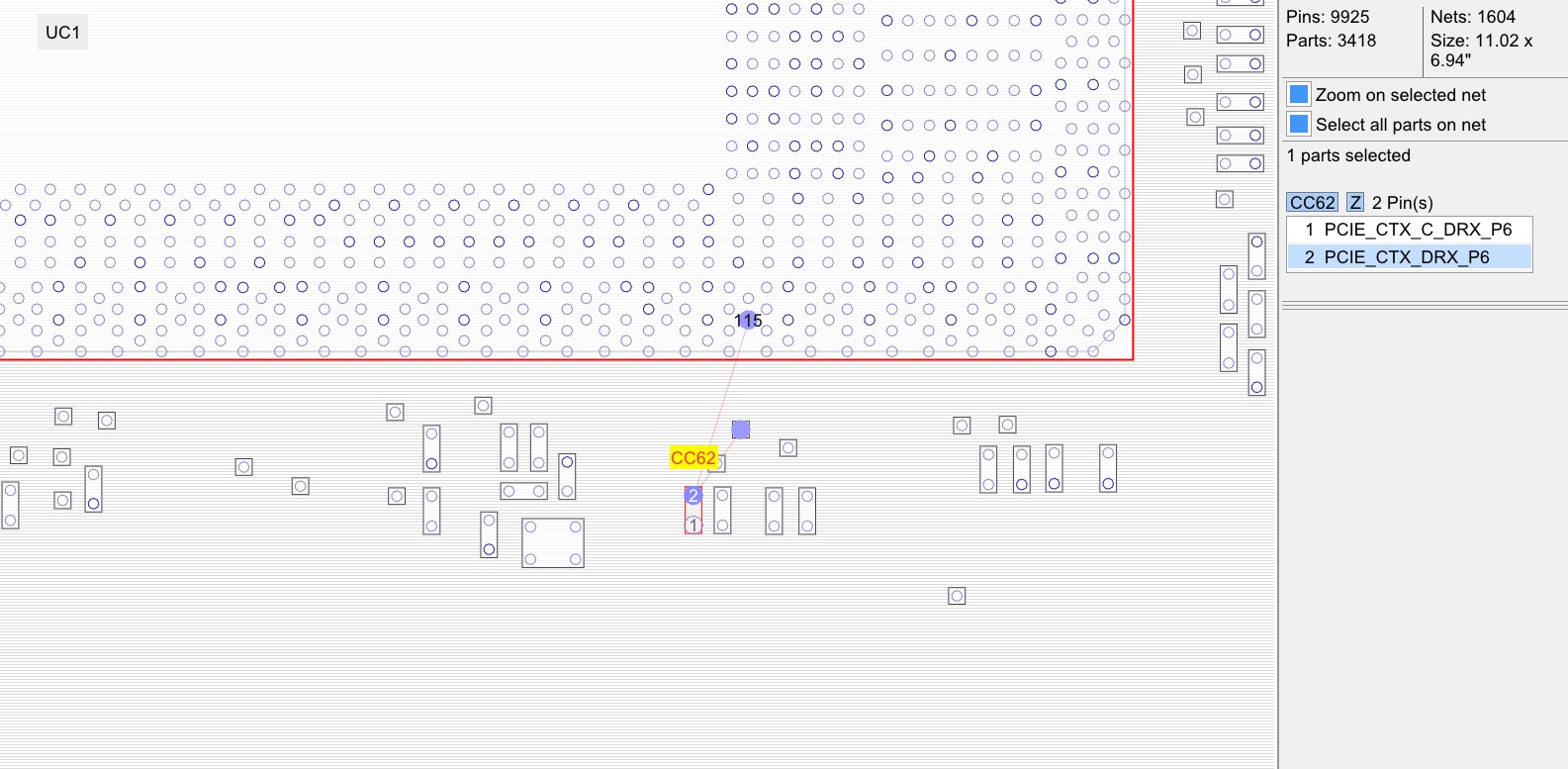

                    The caps are required for proper PCIe communication with the host (PCH) and the target devices such as the PCIe flash, wifi, BT, etc.
                    The cap values look ok for 0.1uf caps. Just be sure that the traces for each cap makes to the target connections. The large BGA device is responsible for the PCIe communication to assorted devices. Effectively, the laptop has multiple PCIe 'slots' like a motherboard would but for this logic board, some of the physical slots are directly connected to the chips themselves. Either way, the interface lines for data flow & clock along with the DC blocking capacitors must be present as per the PCIe specifications. They appear to be ok.
