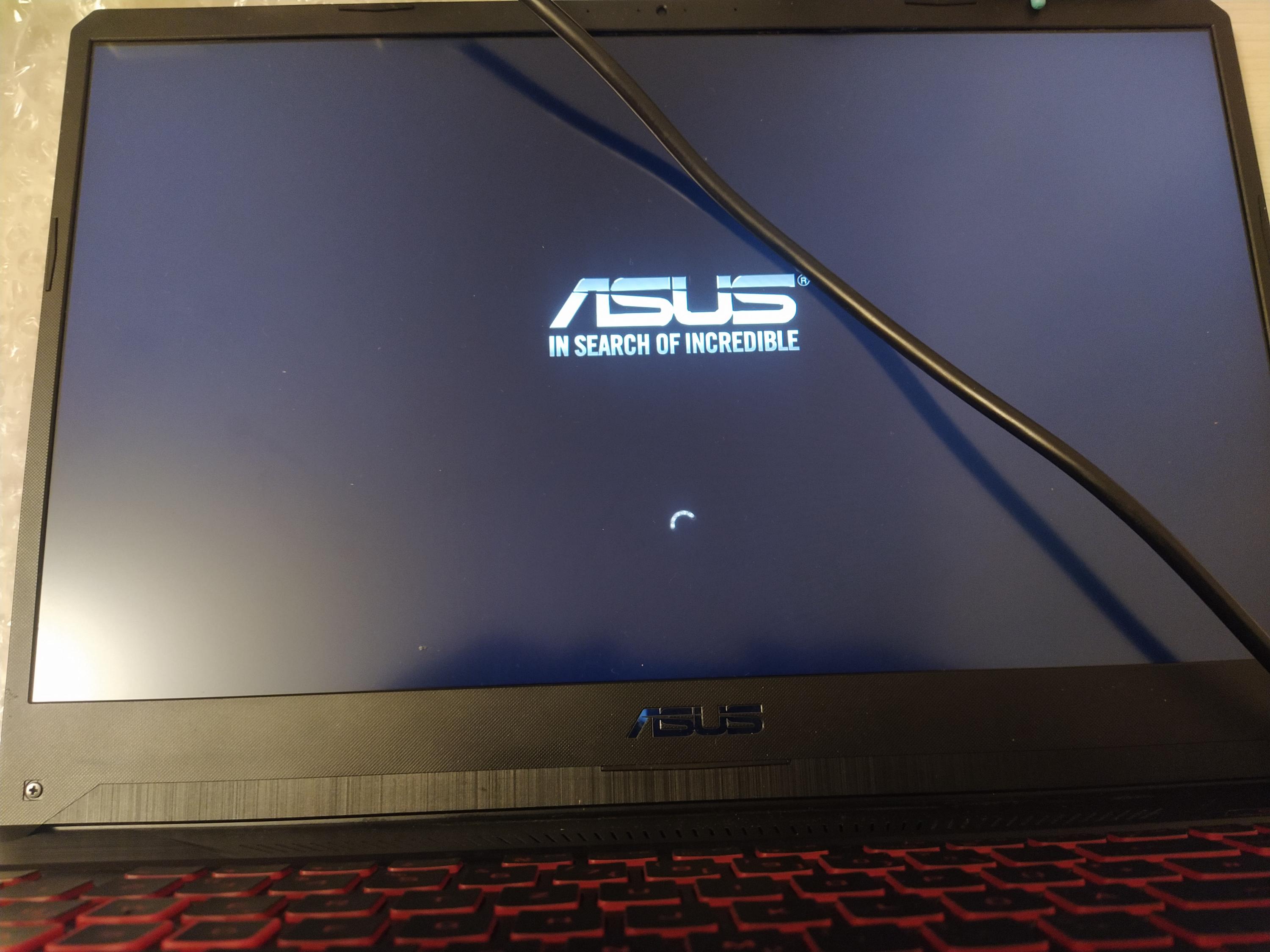

    Any try of Windows 10 boot or USB installation are followed in few seconds try of boot (loading circle visible) and then system reboots. This is reapeated multiple times.
    Sometimes it reset during "recovery mode" and sometimes it is possible to go into recovery. Any try of "Windows in safe mode" or other choice occurs in reboots in loop.

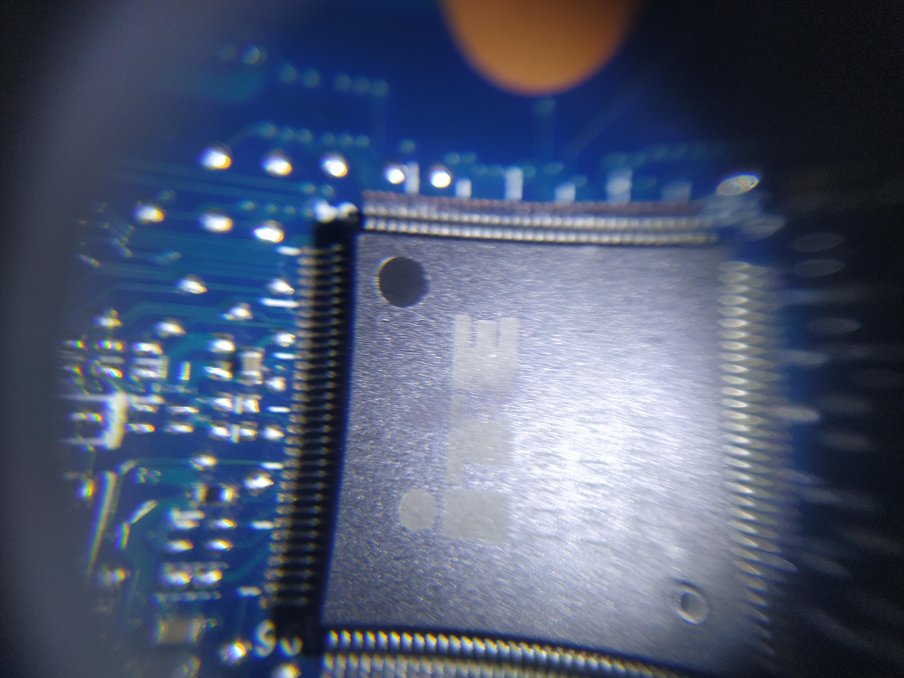

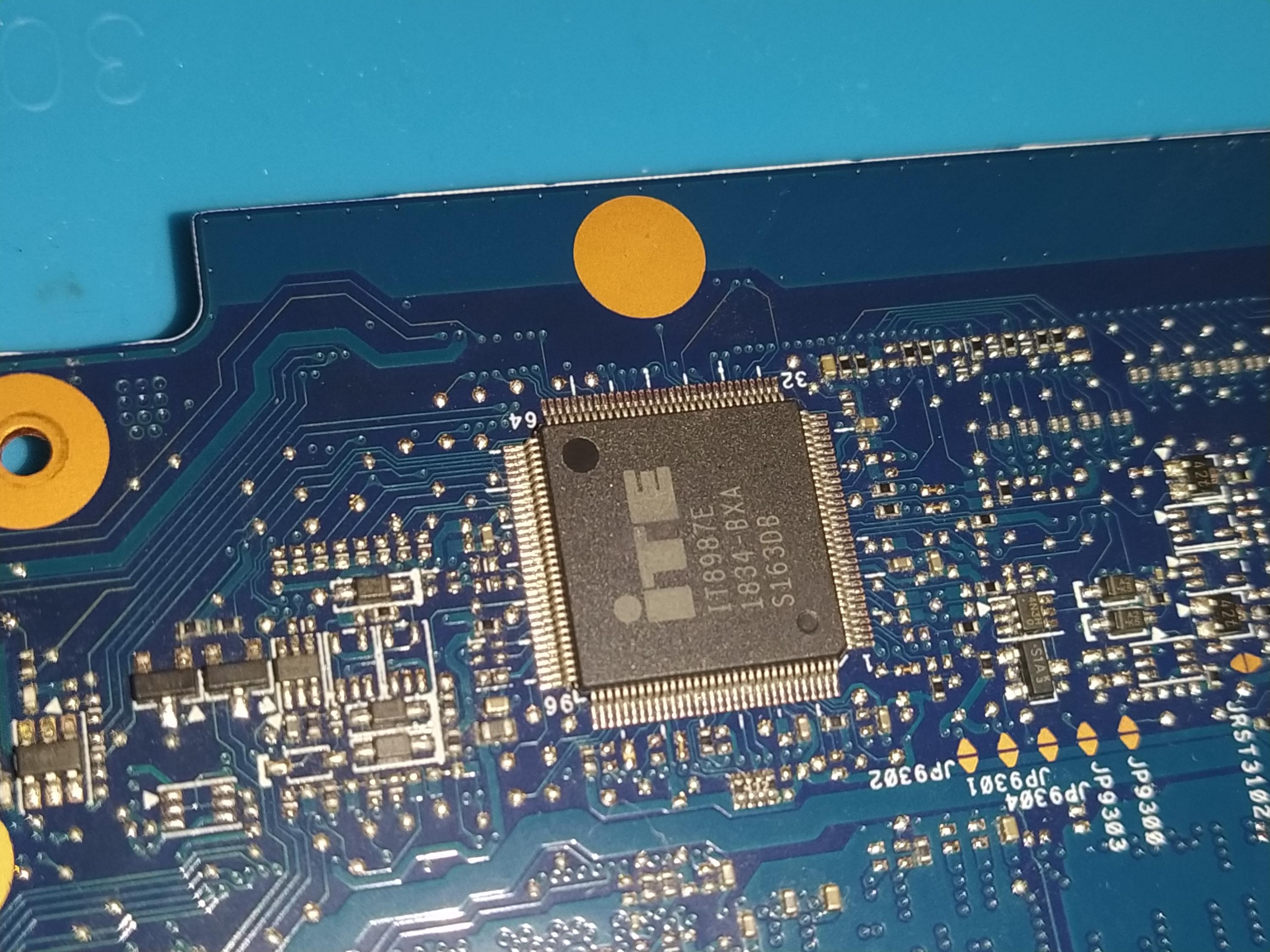

    I found that on MB there is 8 pin keyboard ight/RGB socket, however keyboard have 4pin cable. Looks like palmrest was replaced in past. Maybe someone connected this cable to socket and made some short circuit?
    KBC has very slightly discoloured area near TE letters, so maybe this could be KBC fault?
    Please kindly help in next measurements/tests, as i never diagnose KBC and PCH communication.

        Sometimes the win10 logs can help, have you remove the rtc batt after a bios reprogramming ? about kbc you can check if it's works well with vertyanov (make a backup and erase and power the system after that check if the firmware is present) and adapter (the cable from keyboard is 0.8 and not match directly with vertyanov)

          During programming RTC battery was took out. I run laptop without battery.
          Don't have KBC programmer - i buy if need already programmed one in store (i repair from time to time, so 100USD is a bit too much for that).

              Sounds like Windows keeps crashing and rebooting itself. If this is with a USB drive, most likely a stop error code caused by a USB I/O error.

                But same crashes and reboots are on Windows preinstalled on M2 and on SATA 3 drive.
                Will try wirh linux. I have peppermint version. This will be ok? Use usb-boot or preinstall?
