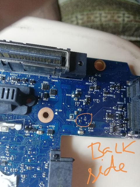

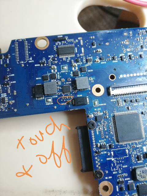

    Hi to all
    Hp Elitebook 8470p restart with ram installed, or if I touch on the step down 3v/5v section (pic attached)
    However if I remove ram or any ram, it continue to carry on.
    Readings on charger IC (U6000 on page 4 of attached schematic) are as folows: when laptop off and charger connected only;
    1... ACN...... 19.85v
    2... ACP..... 19.85
    3... CMSRC..... 19.75
    4... ACDRV..... (1)
    5... ACPRESS ..... 3.25
    6... ACDET..... 2.67
    7... IOUT..... 0
    8... SDA.... 3.30
    9... SCL..... 3.30
    10... ILIM..... 3.19
    11... DLIM..... 0
    12... SRN..... 1.78
    13... SRP...... 1.79
    14... GND..... 0
    15... LODRV..... 0
    16... REGN...... 6.13
    17... BTST..... 5.93
    18... HIDRV..... 1.79
    19... PHASE..... 1.79
    20... VCC...... 19.23
    While the readings on 3v/5v step down ic are as under : when laptop off with charger attached;
    1...TRIP1..... 0
    2...VFB1..... 0
    3...VREF..... 2.01
    4...TONSEL..... 3.33
    5...VFB2..... 0
    6...TRIP2.....0
    7...VO2.....0
    8...VREG3..... 3.32
    9...VBST2.....4.50
    10...DRVH2..... 0
    11...LL2..... 0
    12...DRVL2..... 0
    13...EN0..... 1.69
    14...SKIPSEL..... 0
    15...GND.....0
    16...VIN..... 19.0
    17...VREG5..... 5.02
    18...ENC..... 0
    19...DRVL1..... 0
    20...LL1..... 0
    21...DRVH1..... 0
    22...VBST1..... 0.. 0
    23...PGOOD.....0
    24...VO1..... 0

      • mcplslg123
        • Jun 2015
        • 7262
        • india
        Re: Hp Elitebook 8470p is restart with ram and touch
        Very likely to be bios issue. When you are removing ram, a lot of S0 rails are not coming up and perhaps thats why it remains on. Try flashing bios first with an external spi programmer.
