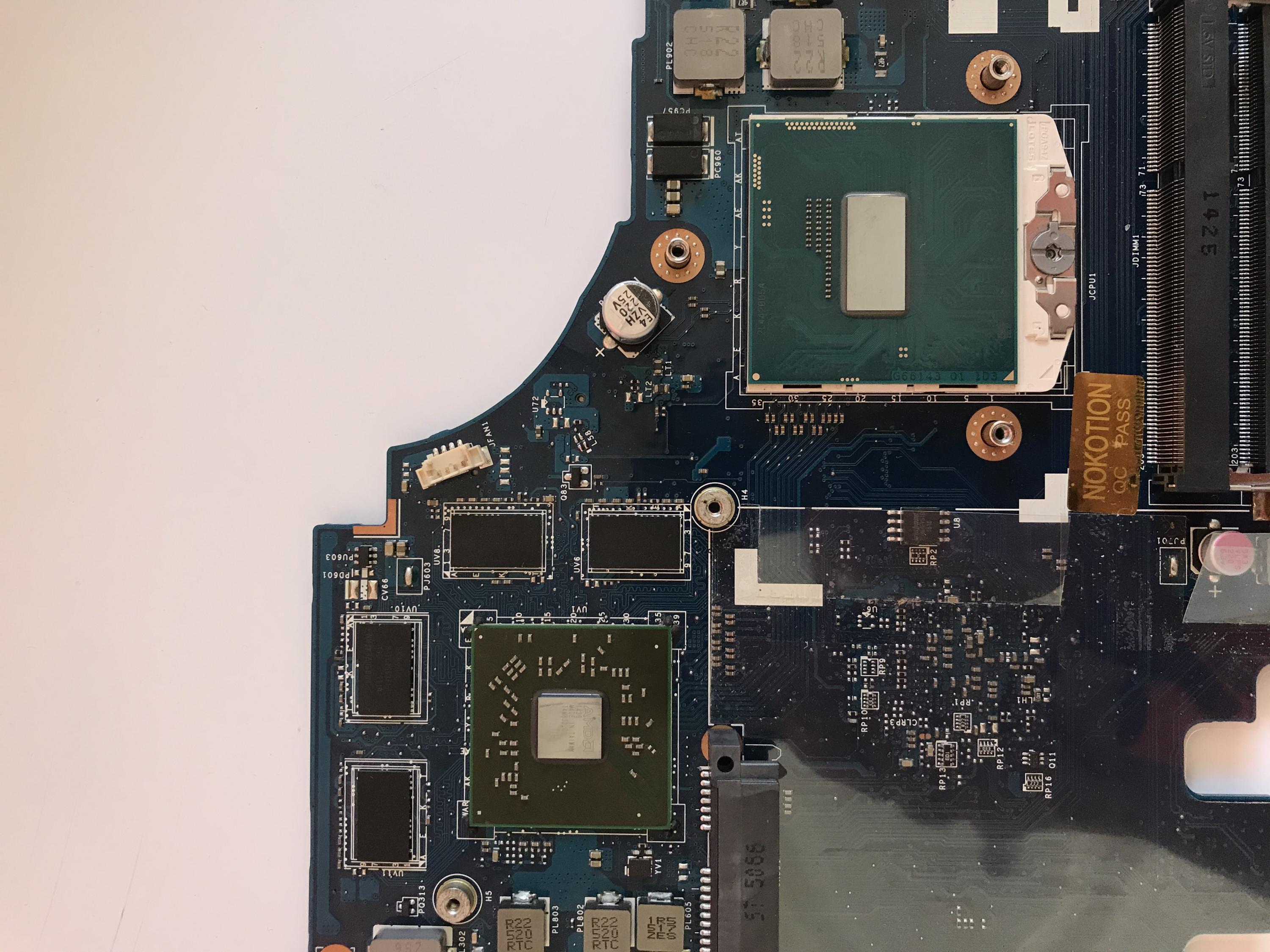

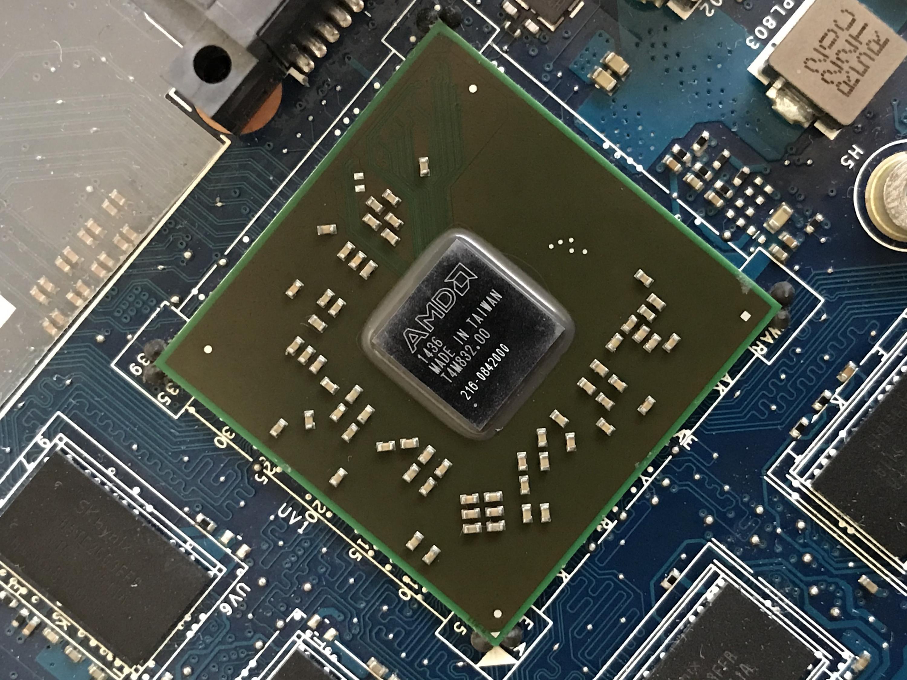

    Hi. Is it possible that the received board from AliExpress does not feature the AMD GPU on your logic board?
    Check around the logic board for the GPU. Most likely it will be covered with a heatsink but post pictures of any silk screen text on the board near this part. Do not remove the heat sink.
    The device driver follows the enumeration of the hardware. If the hardware is missing or disabled then there will be no need for the device driver nor will it be listed in the device manager tree.

      Hello there, mon2! Thank you so much for taking the time to read through my problem and offer a solution.
      Yes, I can certify that my logic board is equipped with an AMD Radeon R7 M265 Graphics Card (please see the images I attached)
      The issue is that the Graphics Card was previously visible and functioning OK, but it vanished after I messed around with the BIOS settings to get the laptop to read my UEFI USB drive containing the Windows 7 installation files.
      When I loaded a fresh copy of Windows 7 and discovered that the Graphics Card had vanished, I panicked and upgraded the BIOS to v3.09 from Lenovo's official support page, only to have it reverted to v3.07 after seeing no difference.
