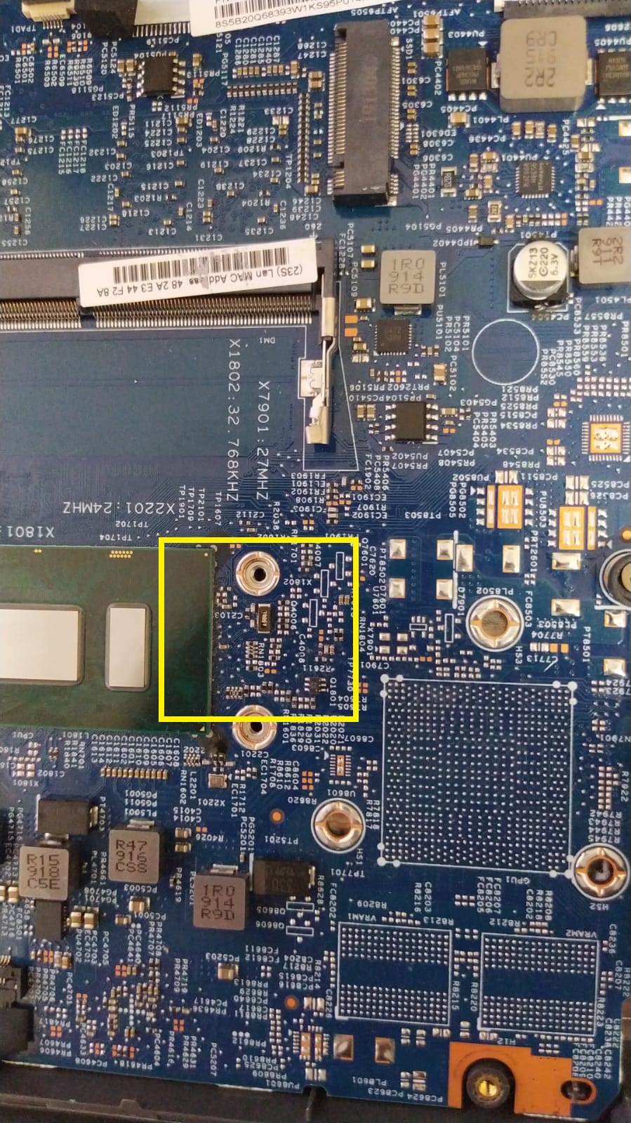

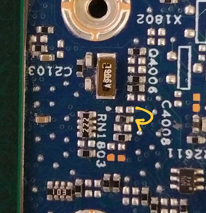

                Re: Lenovo 330s-15ikb ram disable onboard
                i am sharing the picture of resistance need to be shifted...
                works for me enjoy .....
                  WORKS, Thanks!
                    Works for me enjoy .....
                    thanks, the transaction was successful

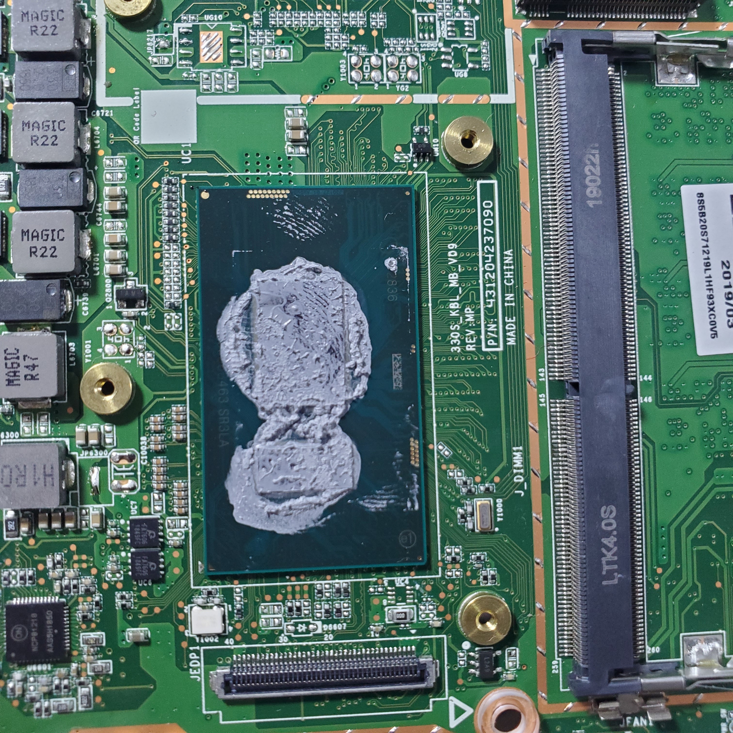

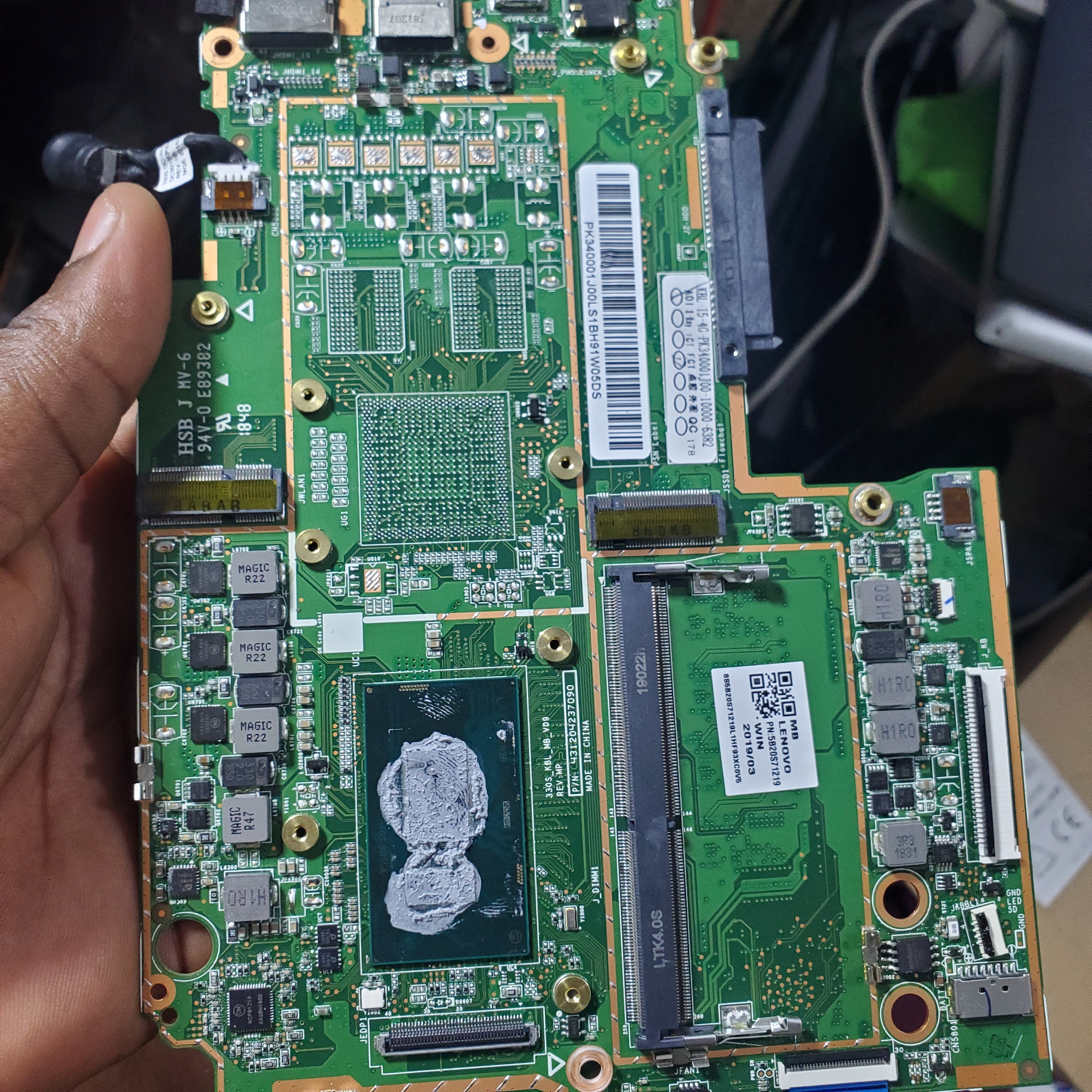

                        My motherboard looks different. mine is 330s_KBL_MB_V09 REV MP. PICTURE ATTACHED. can any one help be disable the onboard ram
                          Pls i need help someone should help me. Pls

                              Originally posted by mon2
                              I did find the board view file for the original board in this thread so will share the details of this bypass later today. Not sure if the method is applicable for your version of the logic board.
                              do you have any schematics or board view files for your version of the board?
                              Pls find schematic and board view below
                              [MOD EDIT] Link to Schematic & Boardview -> https://www.badcaps.net/forum/troubl...atic-boardview
                              Reminder: rules and organization of this section -> https://www.badcaps.net/forum/troubl...f-this-section
                                looking bad. on page 8 is onboard ram straping, but there is no option for no ram
