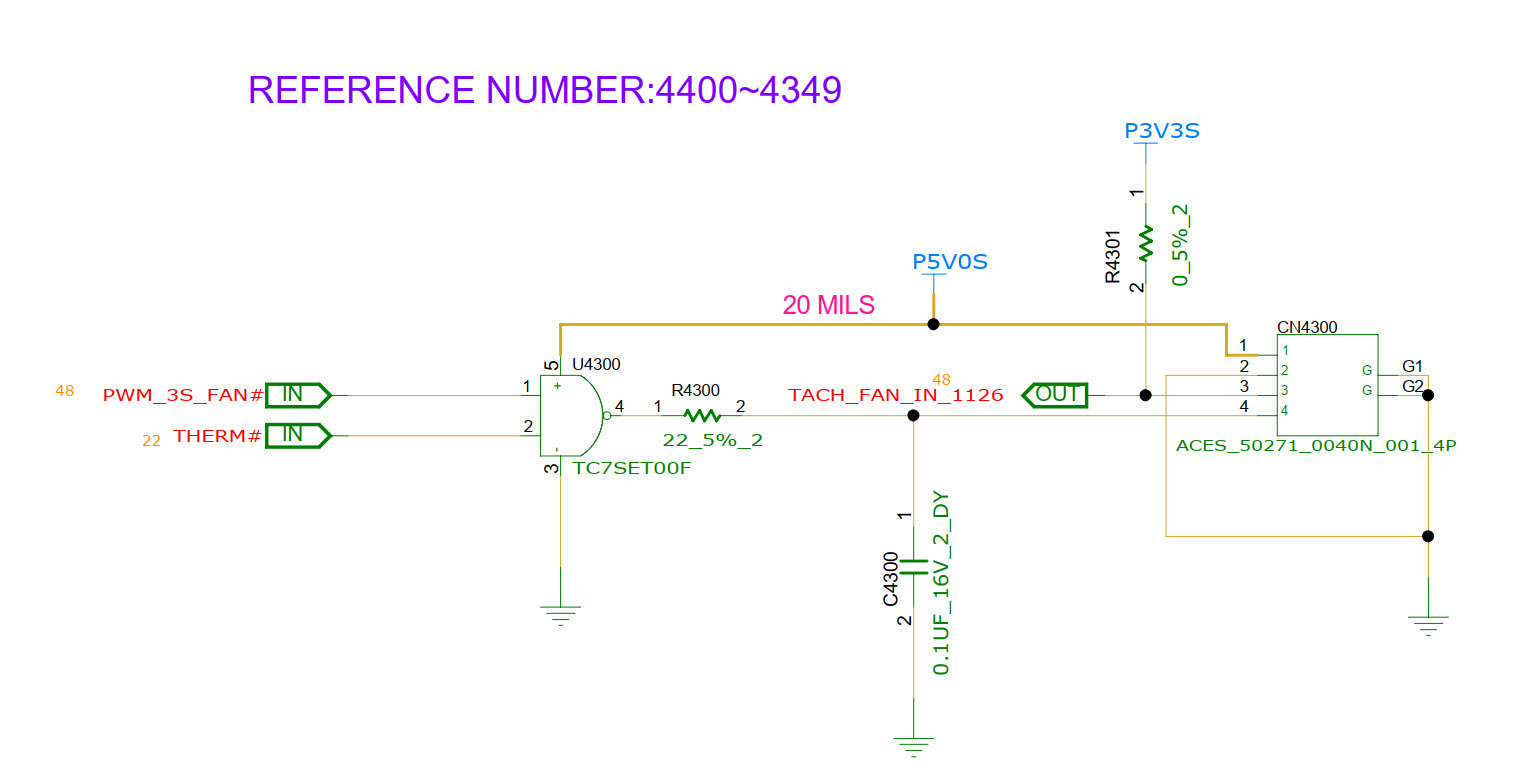

    Someone pls help. I have Elitebook Folio 9470m laptop that its fan has been tested okay, even on other motherboard, but it continued showing same error and fan won't spin. System shuts down when hot. What chip can I check for this error?

    Re: ELITEBOOK FOLIO 9470m System Fan (90B) Error
    Fans are controlled by KBC
    There is some small stuff creating data lines you can check.
    How did you test the fan? -oh i see on other board - that sux means its board fault. Check page 22
    here - have an schematic :P
          Not that simple if its kbc.
          First off check if thats your motherboard i gave you schematic for. There should be string of numbers on 1 side printed on mobo.
          But it should be simmilar in general. As you can see on schematic page 22 :
          - TACH_FAN_IN_1126 goes directly to KBC
          - PWM_3S_FAN# comes from KBC
          - THERM# comes from U4450
          Lines with # mean they activate when they are low
          Lets say U4300 has 5v on pin 5 and pin 1 and 2 have around 3.3v ).
          Then the logic gate will stay closed and you will have no voltage on pin 4.
          In reality 1 and 2 will or should stay above 1-2v for gate to stay closed and if you reach 0.8v - 0.0v on both then gate will open and fan will get its "power"
          This is all theory.
          Check resistors R4300 (22ohm) and R4301 (0 ohm)
          If nothing of this works or is too hard for you :
          TBH if thats your laptop and you do not care too much about noise just create a jumper between pin 5 of U4300 (if there is 5v) and pin 1 of R4300
          Fan should start spinning full blast (i hope its a 5v fan )
            @reassor. Thanks alot, board is 6050A2569401-MB-A01. Yes, it is a 5v fan, but most of the time, I get either 5v or 5.1v on pin 1 of CN4300 (FAN connector). Pls, is that fluctuating voltage okay?
              @reassor. U4300 pin 1 has fluctuating voltage of between 0.5v to 1.3v, pin 2 has around 2.8v but sometimes goes up to 3.1v, pin 3 looks GND, pin 4 has no voltage at all. Regards.
                @ reassor. Thank you a million times. I created a jumper between U4300 pin 5 and R4300 pin 1. Fan now spins, though steady. I am so grateful, but please always feel free to assist me some other time(2). I am a newbie. Cheers, Mentor!
                  R4300 is there to lower that incoming 5v alittle im guessing to something like 4.8v
                  Pin 4 did not have voltage cause THERM# didnt get into "low" state to open the logic gate.
                  You by creating that jumper just bypassed the whole thing ;p
                  no speed control but atleast its cooling right?
                  I'm begginer as well even tho im 40y old ;p - so always check my thinkin - i can be wrong (im most of the time - its called learning)
                    if you want to experiment alittle i would suggest lifting up pin 2 from U4300 (desoldier this pin only and bend it up) since it seems like this line is blocking the gate - there might be something wrong with U4450 or R4453. Before doing that get rid of the jumper.
                    By lifting pin 2 of U4300 you making that line low always so only pwm line will have actual impact on the gate. Since you wrote that its going "0.5v to 1.3v" - it should trigger the gate - its just for sience
