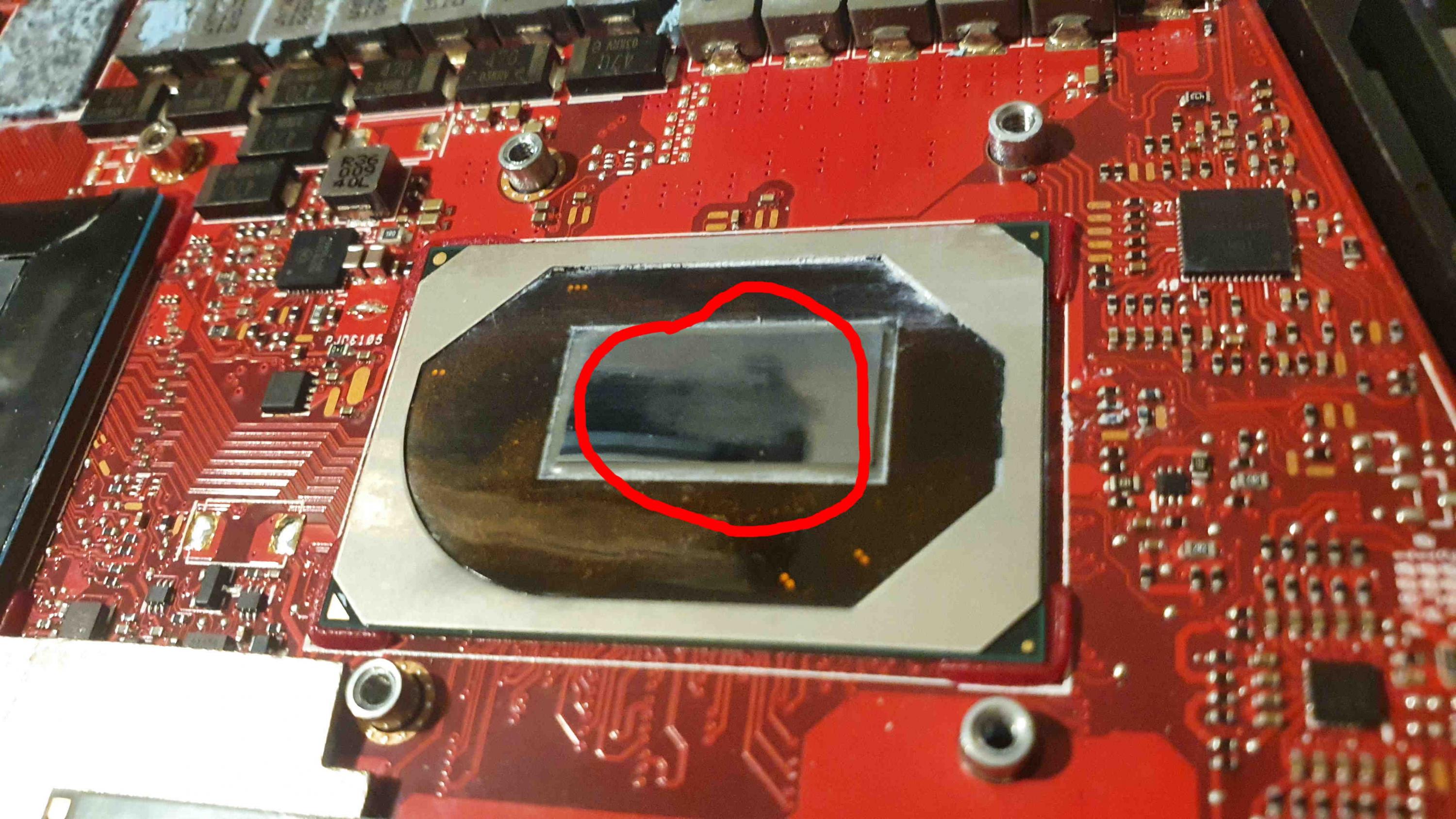

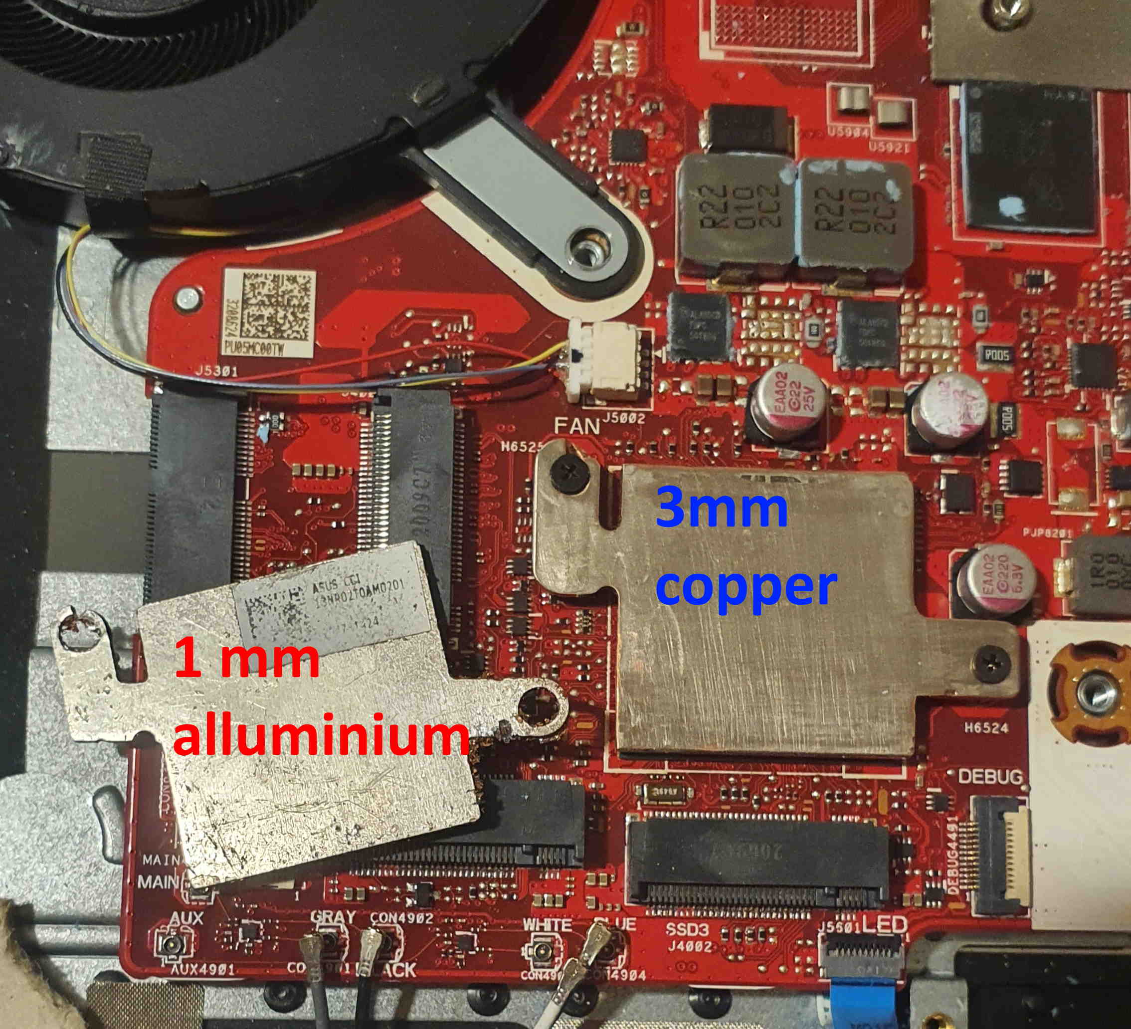

          Another problem concerns the pch which is really hot even if it works correctly, I replaced
          the original heatsink with one made by me hoping the problem will not recur (on some Rog
          the pch in this case an HM470 is always very hot ...).
          Thanks for the answer and I ask a question about the correct dissipation.
          Asus now appears to be using on 10th cpu liquid metal instead of the classic heat-conducting paste (https://youtu.be/pbCw1FD22Bo).
          In the past I have used liquid metal (Thermal Grizzly Conductonaut) for the dissipation of only the gpu but from
          what I read asus uses it only for the cpu (I think it's true because in my photo you can see the surface of the
          cpu corroded while the heatsink is not even if it is not copper). I wanted to hear other people's experiences
          about it on high-end laptops. I thought about using:
          1) Pads -> K5-pro very low viscosity
          2) GPU -> Noctua NT-H1
          3) CPU -> Noctua NT-H1 or Conductonaut ??
          Strangely, some technicians recommend repaste also on new laptops and then remove the liquid metal ...
