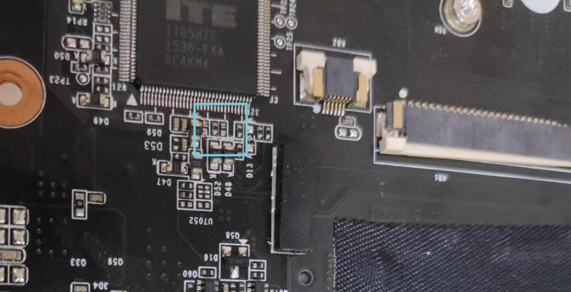

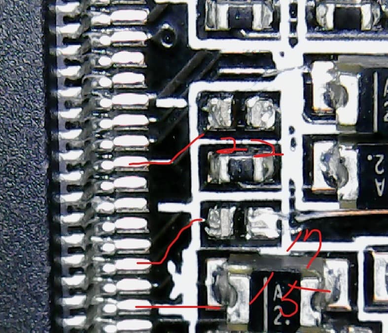

    Gigabyte GA-RP55W5 no display
    What is the resistance value shown in Figure?
    It's gone due to damage
    I/O IC IT8587E 22pin & 17pin
    17 pin 10k ohm
    In case of pin 17, a voltage is transmitted to the memory using 10k ohms
    22pin ?? ohm?
