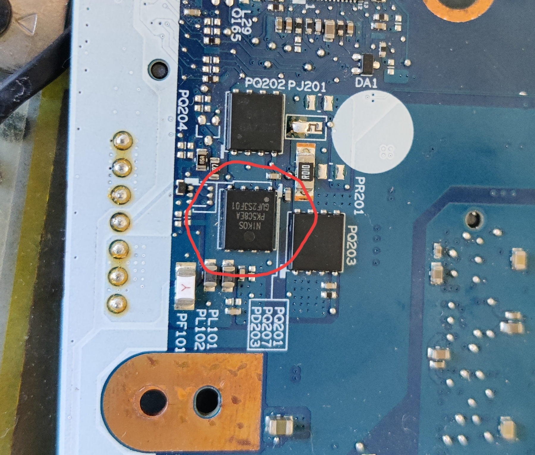

      Hey sorry to revive this post. I'm new to fixing circuit boards and am excited to learn. I just inherited a dead Y720 with what the previous owner stated. Only difference is he said none of that work and one day he opened it up and now it doesn't turn on. I narrowed down where the issue begins and it's here:
      One of the MOSFETs (circled in green) input has 20v output shows 0. And then the chip in red gets really hot. So I'm assuming that's where the short is. But I'm not sure what the name of that chip is or if there is anyway to figure out if that is where the issue is.
      Click image for larger version  Name:	IMG_20240623_221927.jpg Views:	51 Size:	4.27 MB ID:	3296380

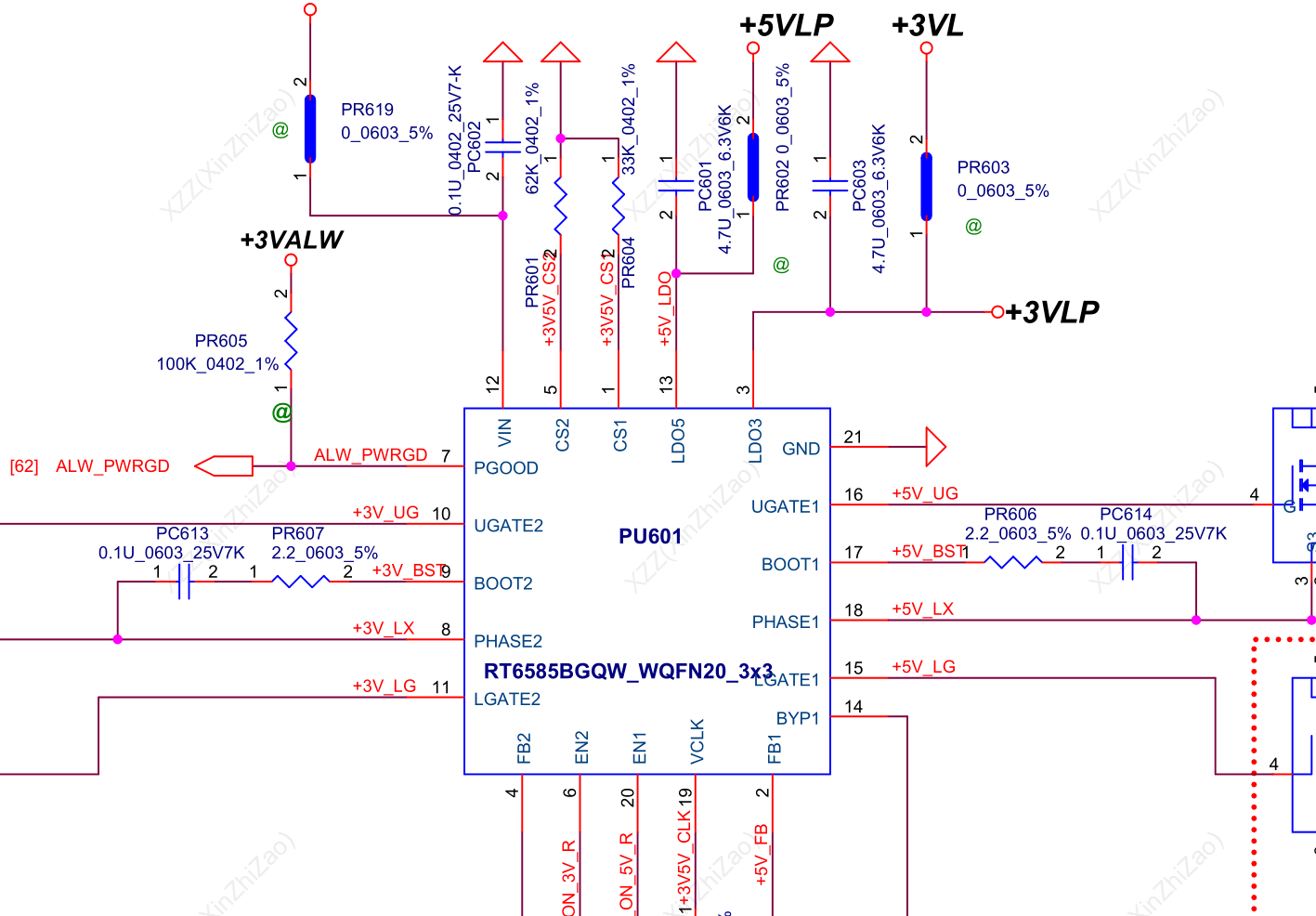

        PQ203 = AON6414A
        PU601 = RT6585BGQW
        RT6585BGQW Richtek USA Inc. | Integrated Circuits (ICs) | DigiKey
        Click image for larger version  Name:	PU601.png Views:	0 Size:	195.1 KB ID:	3296391

            PQ203 (AON6414AL) is the battery mosfet. This mosfet is acting like a solid-state switch that will enable only if the battery is the sole power source to power the logic board.
            Being an N-channel mosfet, the gate pin # 4 will have to be higher (boosted) than the voltage being passed between source and drain pins to enable this component. Once pin # 4 (gate) voltage is boosted, only then will the drain pins (5-6-7-8) offer the battery voltage to power the board.
            If the IC @ PU601 is heating up then remove all power. Meter in resistance mode. Measure the resistance to ground of each pin on this IC and compare to the datasheet for this component. Checking for any low resistance to ground which will place a higher-than-normal load onto this regulator. Do review the LDO5 and LDO3 rails which are the 5v0 and 3v3 regulators for low current peripherals onboard. Post your measurements.
            This regulator is a very critical one and is creating the 'always on' power rails for the logic board. This regulator is required to get the board to boot.

                Pin3=LDO3
                pin13=LDO5
                Check resistance to GND on both these pins of PU601.No power attached while measuring resistance to GND.

                        Set multimeter to 20K scale and then measure resistance to GND on both LDO3/LDO5.Note the readings
                        Next set the multimeter to 200 ohms scale,repeat the measurements.
                        Share measurement on both scales. However, it seems to me that your LDO3 rail is shorted to GND and not LDO5.
                        Short to GND on LDO rail could be bad news also as often the PCH part of SOC gets shorted.
                        First confirm the measurements and if LDO3 is shorted to GND, you need to inject voltage (1V/5A) on LDO3 to find out what is hot.
                        Very likely KBC and to some extent may be PCH.

                                Short your meter probes. Do you see the same measurement as in the above testing? From the posted measurement, you have a dead short on this power rail.
                                The LDO5 is ok since there is a larger resistance and is confirmed with the 'OL' on the LCD display which means over-limit for the selected scale on the meter.
                                Would you have an adjustable power supply? Ideally needs to be setup for 1 volt but be able to support 3A-5A for some fireworks. With such a setup, need to apply this 1 volt power supply onto the LDO3 rail (red lead) and black lead to ground. This process will cause the shorted component to heat up or even crack under the pressure.

                                      Hey there, so just to practice my soldering I replaced that chip. However, no power doesn't go past the first mosfet (as shown in picture) one end has 20 v coming in but 0 v coming out I checked the resistance on it using diode mode I get .300 and the mosfet after that I get 1.700. is one of these shorted now?
                                      • mcplslg123
                                        • Jun 2015
                                        • 7262
                                        • india
                                        Why un necessarily keep changing components when its crystal clear that you have dead short on 3V LDO? This will make situation even worse.
                                        You need a adjustable dc power supply to inject 1V/5A on 3V LDO line to find out whats hot.
