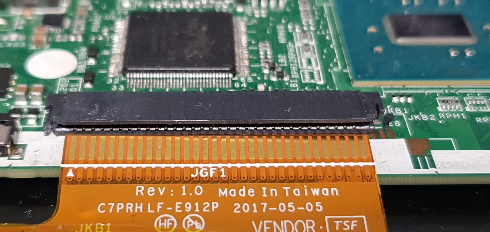

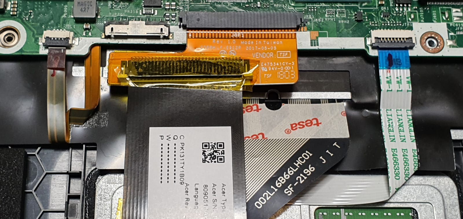

working on this machine - dead but has 5v and signals on the EC. There is no +3VALWP - no 3V_EN - the bios/EC area are fluxed. Looking at the keyboard connector, the pitch looks off and the flat cable fits very loose. What do you guys think?

It seems the kbd connector lock is missing. U can try by cutting some extra tape(remove from bad kbd) -

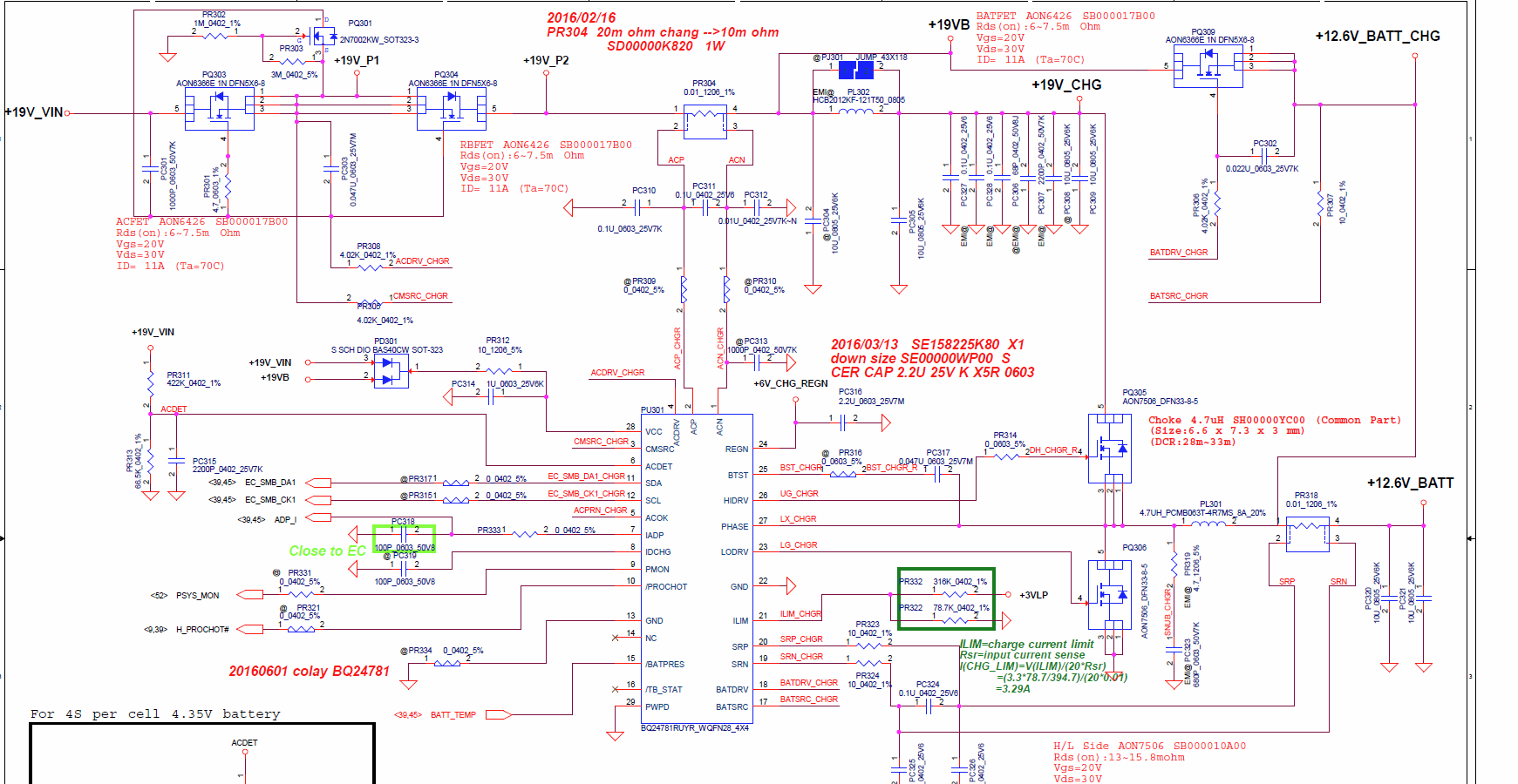

I tried that but got nothing. So I removed RB14, RB15 and DB1 (then bridged). I've now got +3VALWP but doesn't switch on. I then looked at PU301, all voltages seem ok apart from:
pin 10 /PROCHOT 0v
pin 26 HIDRV 200mv
pin 27 PHASE 200mv
Is it time to change PU301?Comment
