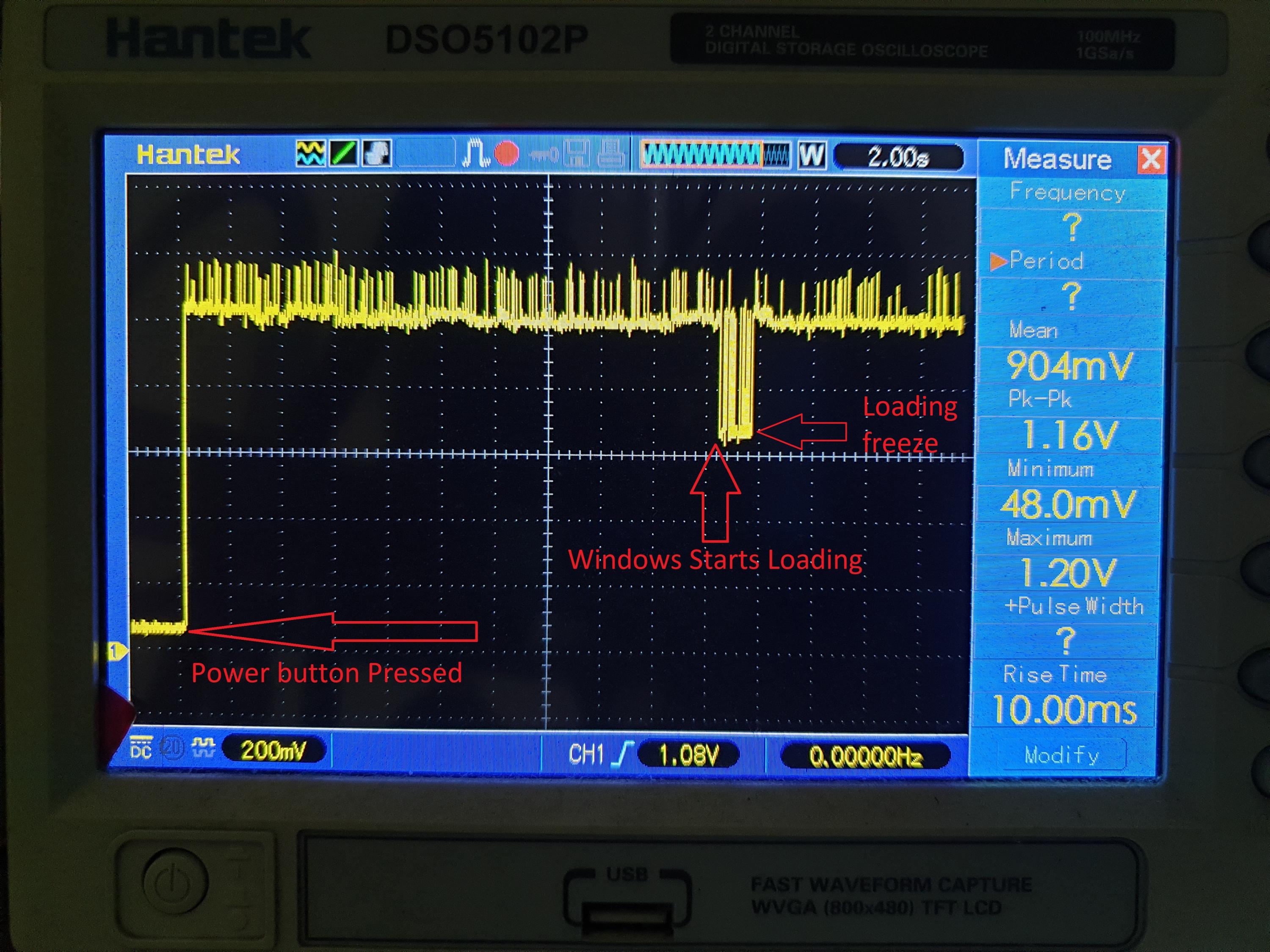

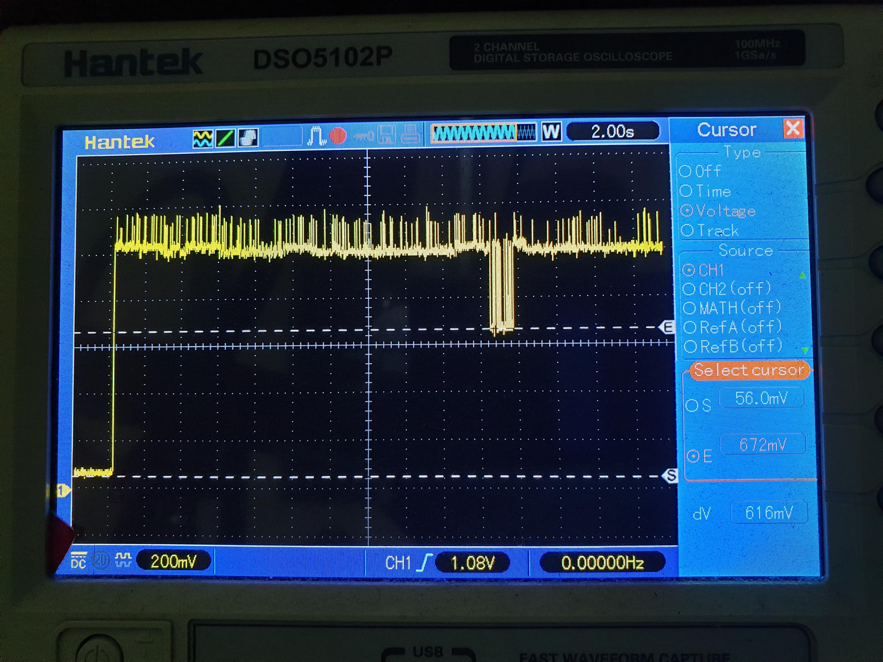

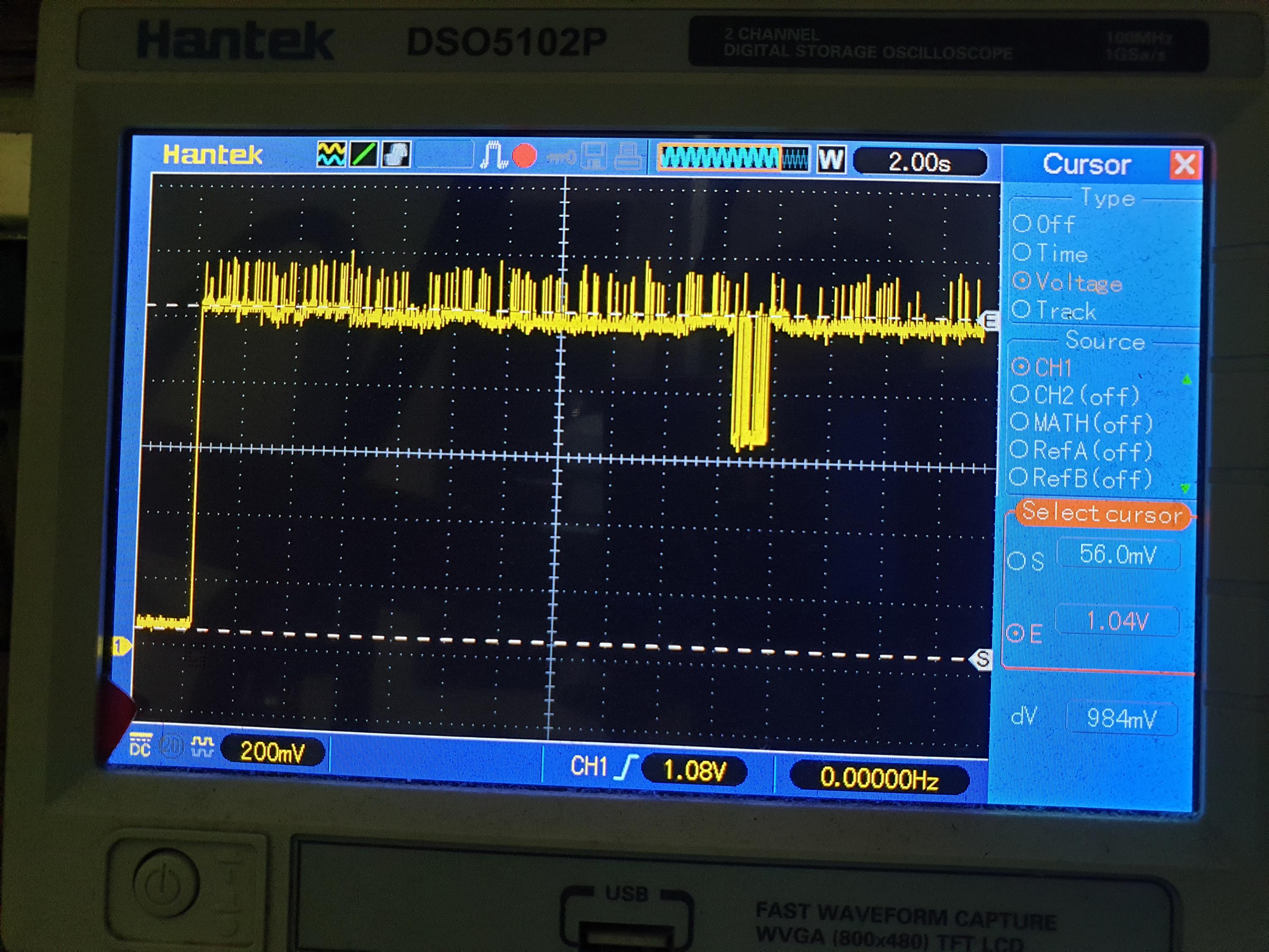

    Voltage measurement

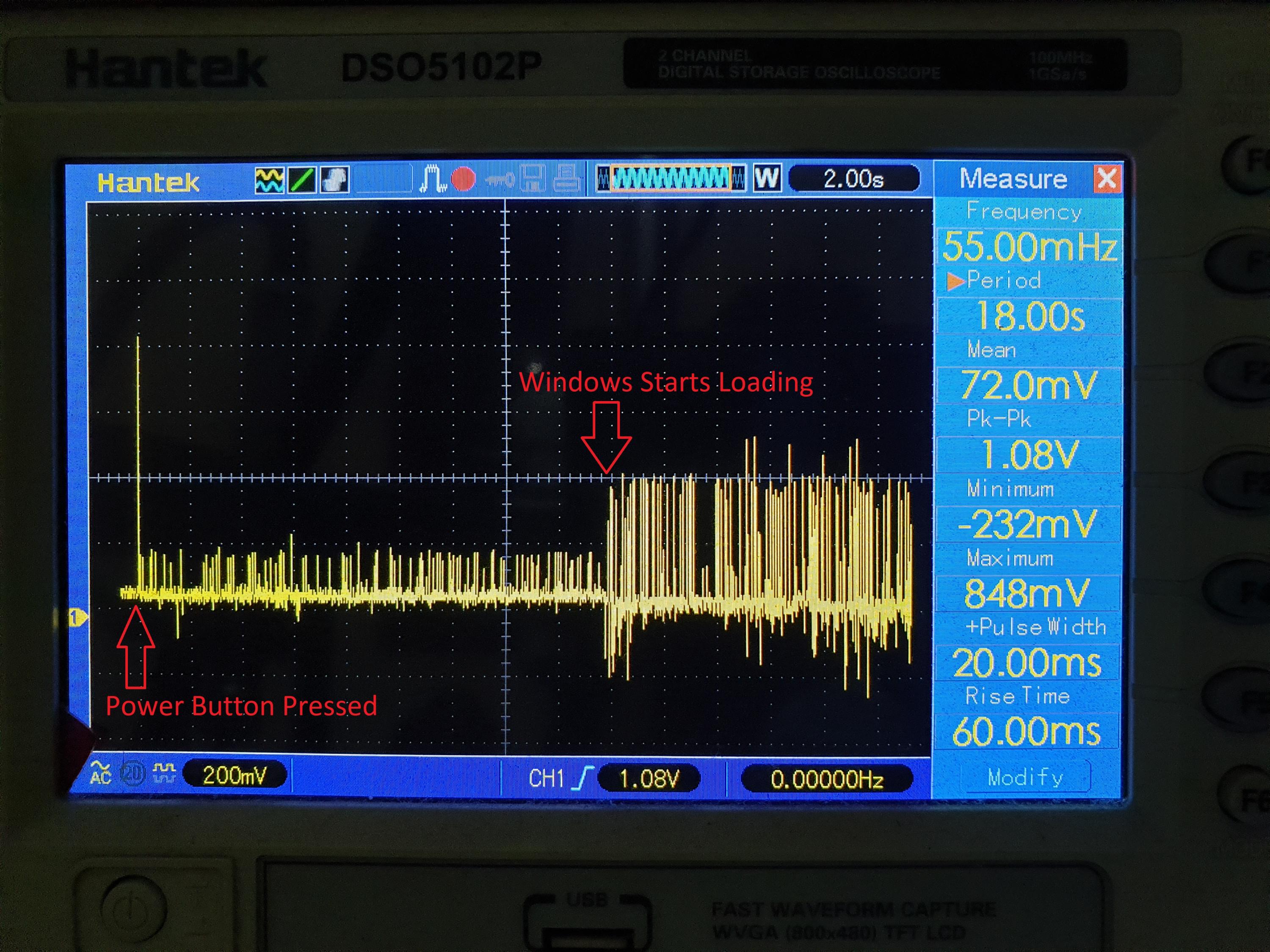

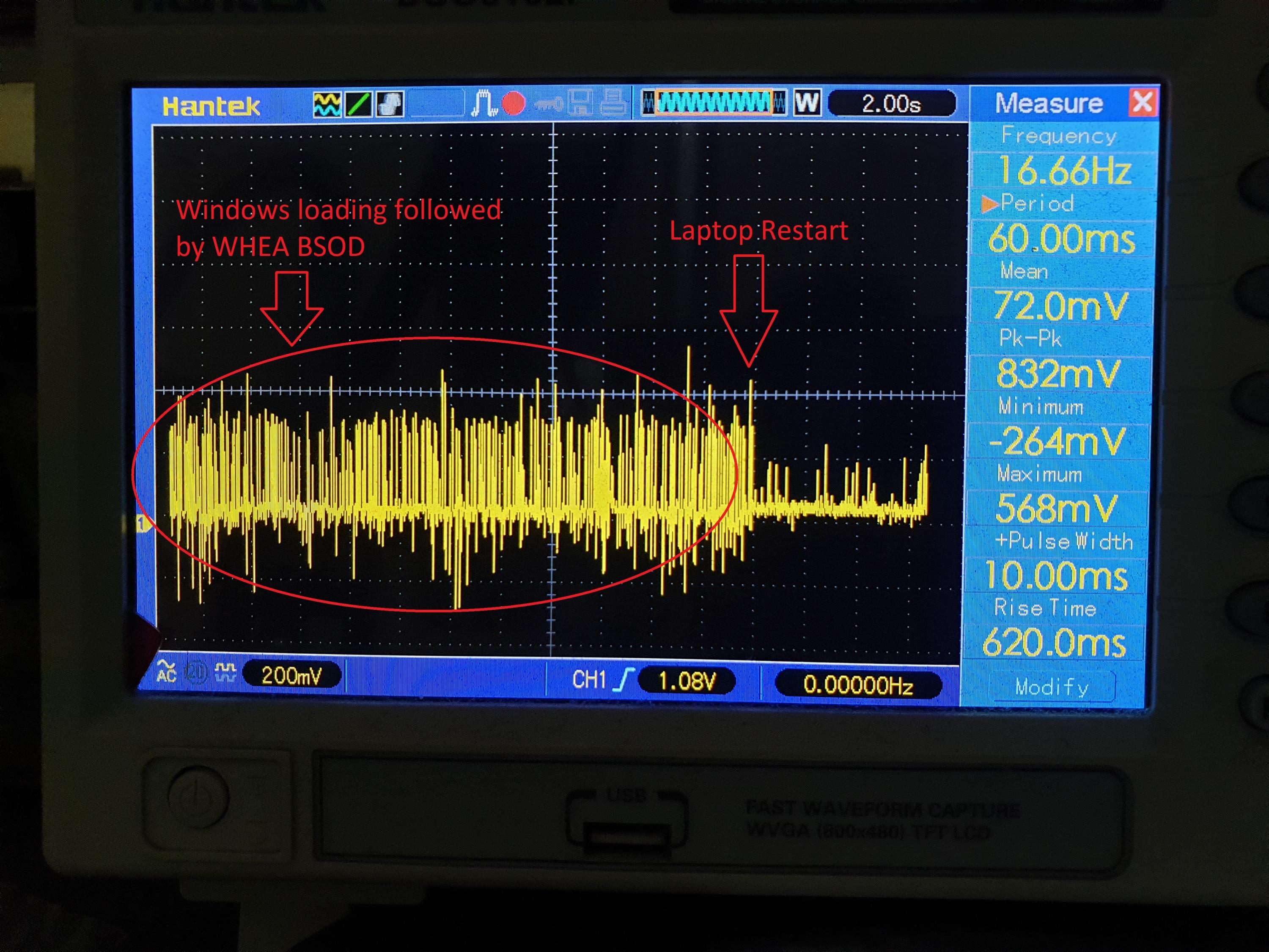

    At first measurement, all voltage seemed OK but right when windows starts loading, the CPU core voltage is all over the place. At boot CPU is around 0.94V but as soon as windows starts loading, voltage can go as low as 0.6V.
    Removing HDD and booting from USB (to prompt windows installation wizard) and causes fluctuating voltage as above.
    Measuring +VCC_CORE with DSO shows a VERY noisy line.
    The voltage on drops when windows starts loading. Otherwise it stays around 0.94V

    2. DSO probe point -> Output of +VCC_CORE inductor
    There is no corrosion on the board and all other voltages are stable and smooth. Am not sure what else to check. Could it be potentially cracked BGA solder of the SoC? Any Suggestion please?
