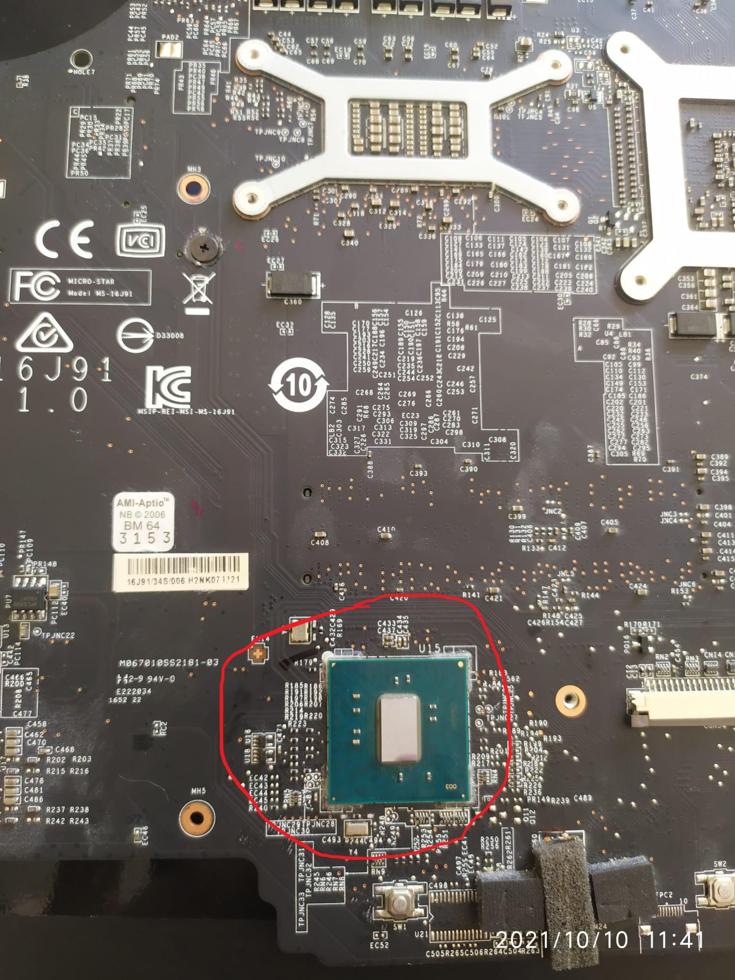

    i try to change the screen for MSI Gaming Laptop, after i replace the screen the laptop stop working. charger indicator working when i plug the charger.
    i disassemble the laptop, and found that when i press at power button the north bridge getting hot (warm) and nothing else happen.
    is the south bridge dead? or i can do something else to retrieve the motherboard?

    Re: MSI MS-16J91 Gaming Laptop motherboard dead
    hi.
    Power down.
    Disconnect the screen.
    Power up. Check the voltage on each and every coil on the laptop. Each coil showing a proper voltage ?
    If not, power down and check the resistance to ground on the respective coil.
      You perhaps didnt dis-connected the battery while changing the screen.
        Confirm that you change screen with battery on as mcplslg123 says
        U59 or U15 is getting hot???
