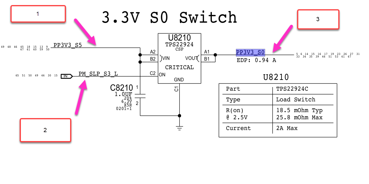

                      Re: A1466 820-3209-A not power on
                      See attached.
                      Check & post the voltages for:
                      1) PP3V3_S5
                      2) PM_SLP_S3_L
                      3) PP3V3_S0
                      • bushmann
                        • Feb 2014
                        • 147
                        • Slovakia
                        PP3V3_S5 = 3,3
                        PM_SLP_S3_L = 135ms - 3,3V ; 4s-0V cyclically
                        PP3V3_S0 = 135ms - 3,3V ; 4s-0V cyclically
