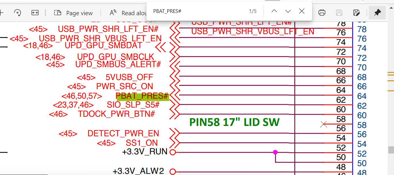

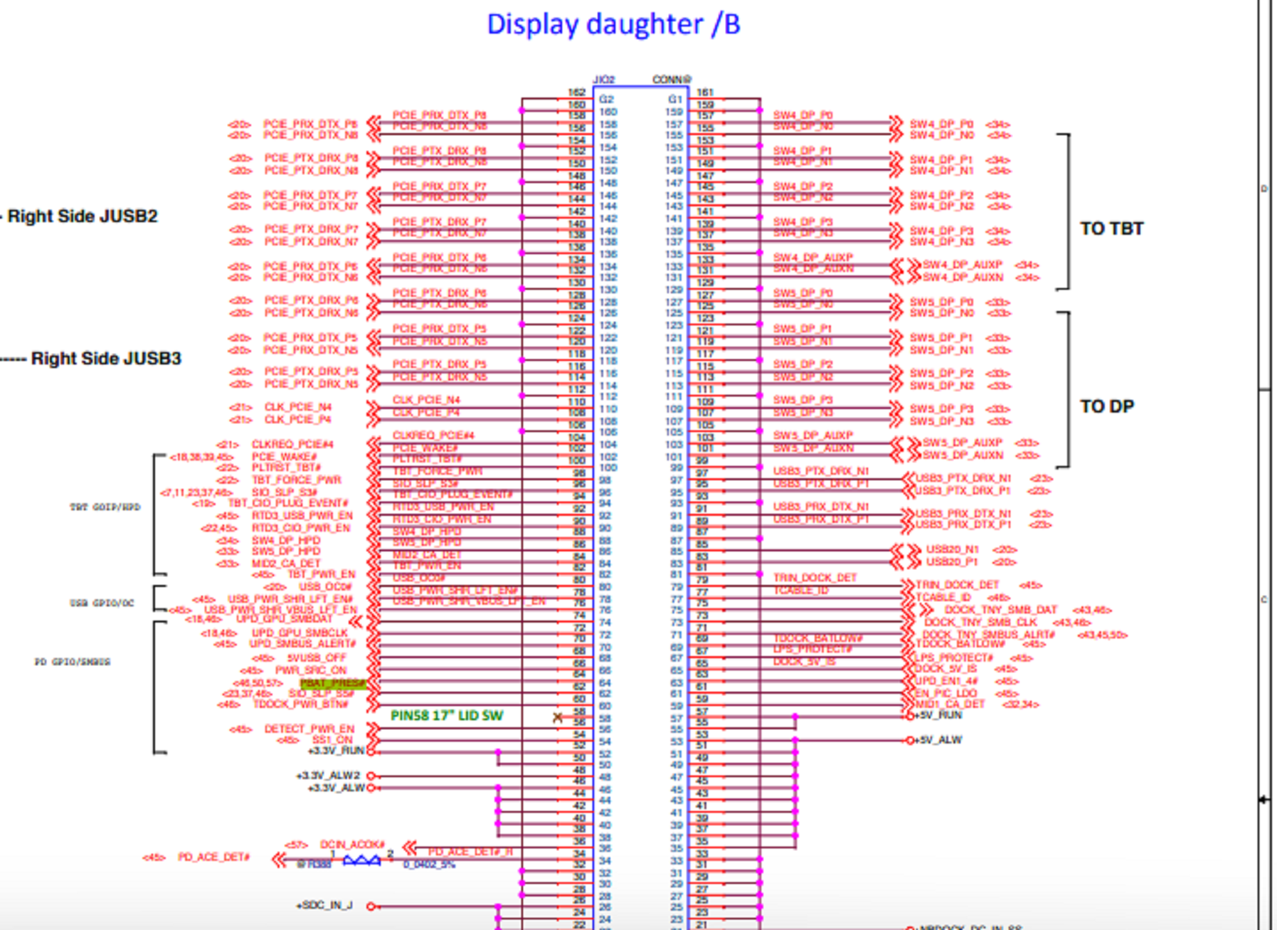

    I can't understand why the PBAT_PRES# goes through that board, on fully working 7510 the battery charges the same with or without the daugterboard.
      Re: Dell Precision 7510 charge battery and left side board problem.
      Originally posted by Andreasbest View Post
      I just ordered another daughterboard just to be sure (bargain it at 30€ including p&p).
      I don't know either, but looks like Dell's engineers like it that way :

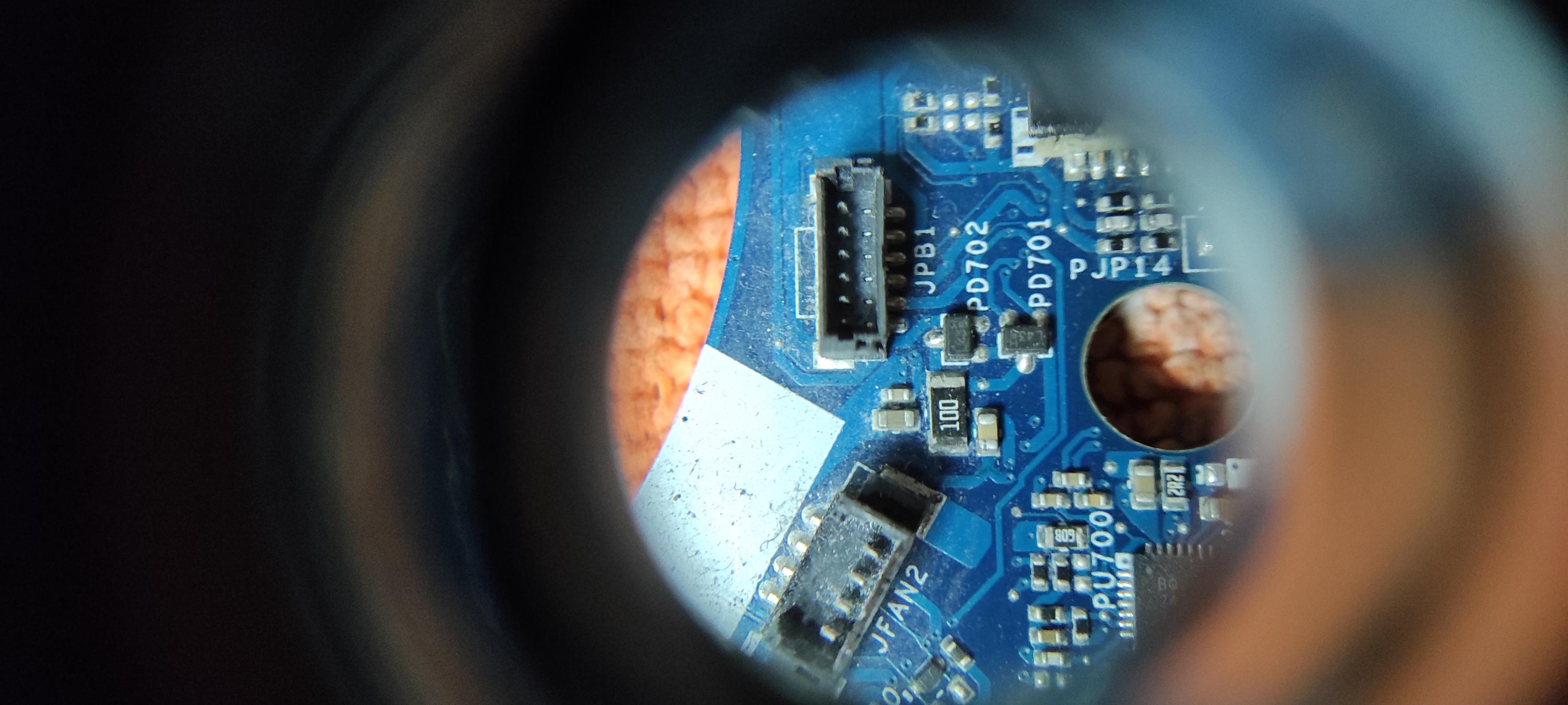

        ok. have you checked PD702,PU1001 and all around the dock connector for liquid damage/corrosion
        Dock connector is clean without corrosion around.
        PD702 and PU1001 are clean BUT next to PD702 is a resistor with one pin corroded (check attachment)
        Now, this resistor (soldered) in my MB shows 1.57kΩ while on customer's MB shows 10.4Ω.

          Test PD701 and PD702 in diode mode ,replace that resistor PR717 10_1206_5% , 10ohms 1206 5% tolerance.In your picture it looks like theres some crud stuck to the chip above PJP14

            Cross tested PD701 and PD702 with the fully working (at charge at least) 7510 MB and give identical measurements so all good there.
            I replaced the PR717 and charge issue resolve, now charging battery smoothly.

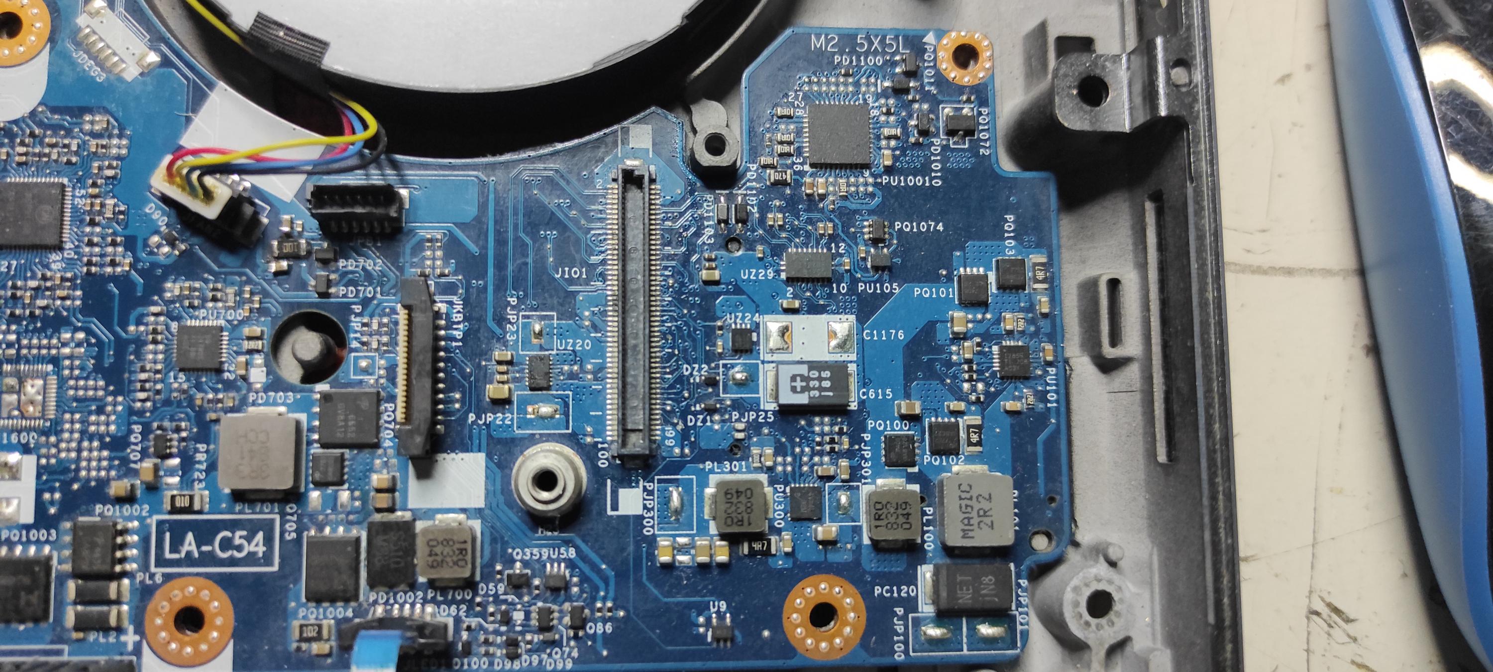

                        Hello!
                        Yesterday i made a terrible mistake with my 7510, i removed the right side daughterboard JIO1 while the system charging (was not on, just charging) that resulted to a shortcircuit and since then it's dead, charger goes immediately off when i connect it.
                        I noticed some tiny solder balls next to PQ101, probably created by instant heat right before shortcircuit.
                        All area there (PQ101, PQ103 and nearby caps) is grounded!
                        Any ideas?
                        Photo, schematics and boardview attached.
                        Thank you in advance!

                          Oh dear,you were so close to fixing it. Looks like some blackened pins on JI01 ,look at the boardview see where they all go

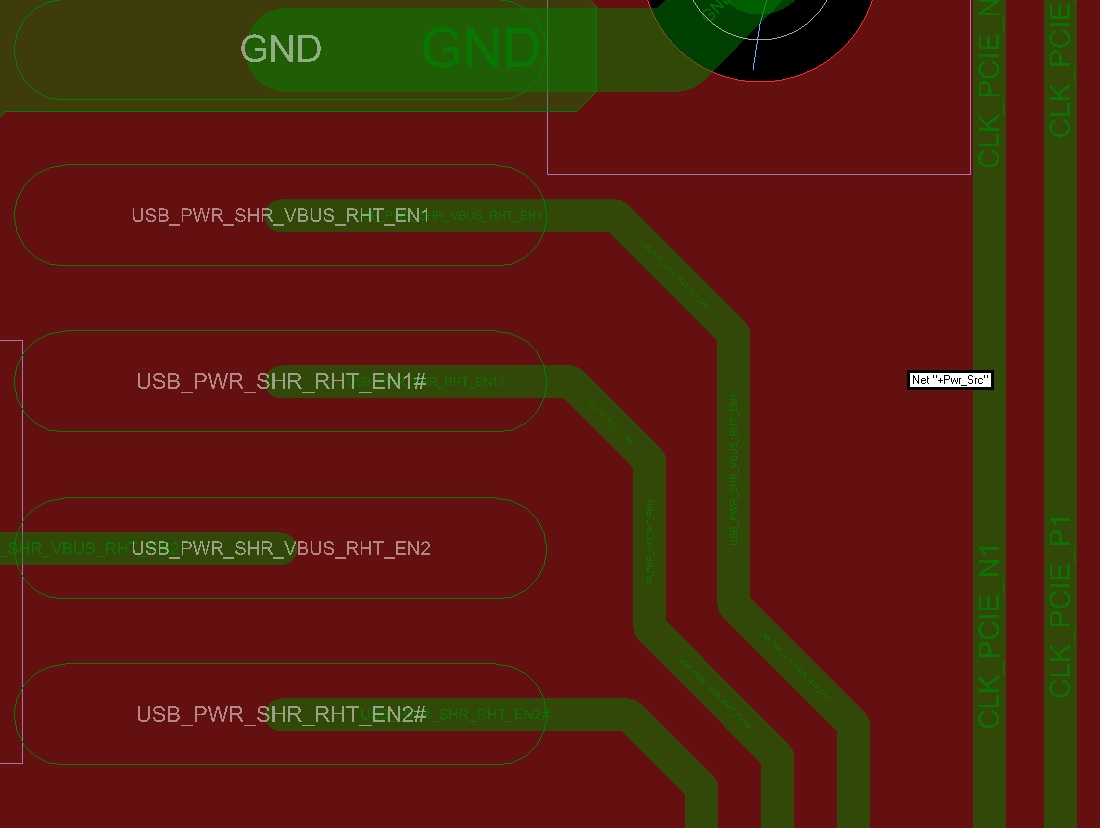

                                Found them on Allegro too
                                (to view traces and component names in Allegro ->https://www.badcaps.net/forum/showpo...0&postcount=38 ,thank you @Spider1211 !!)
