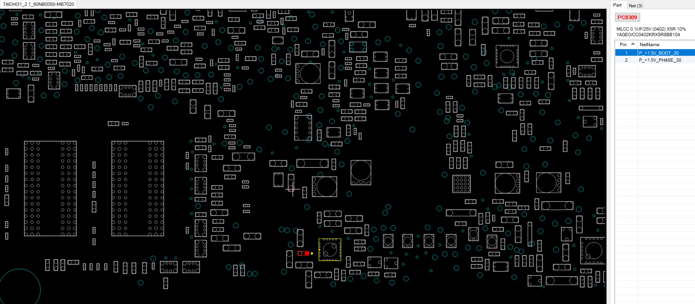

    A Taichi31 not posting. Power led lit, cpu/gpu getting warm, both screens/hdmi blank.

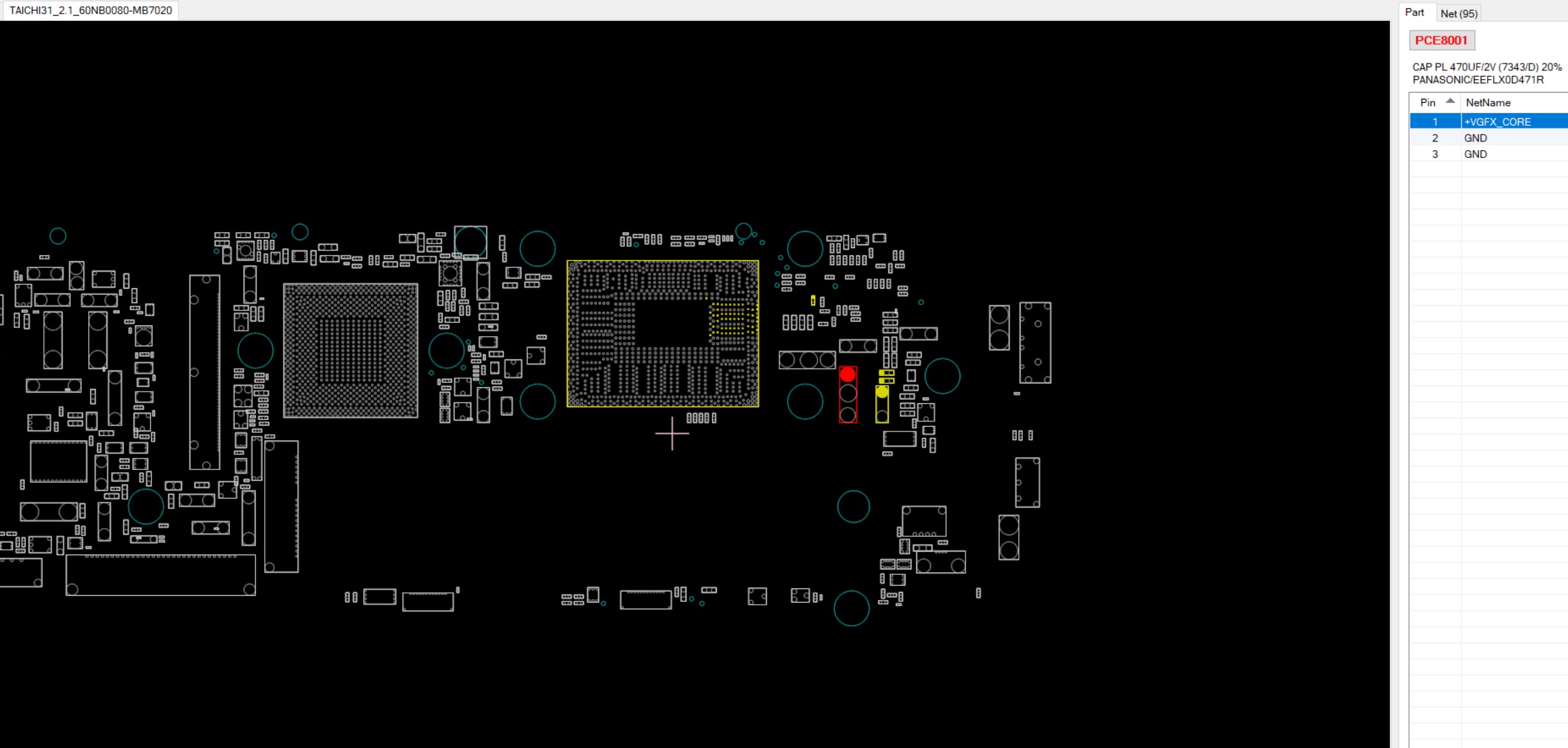

    Power rails checked, all Voltages found correct, except two. First is a VGFX Core, which i think the secondary power for the cpu, maybe right is off.

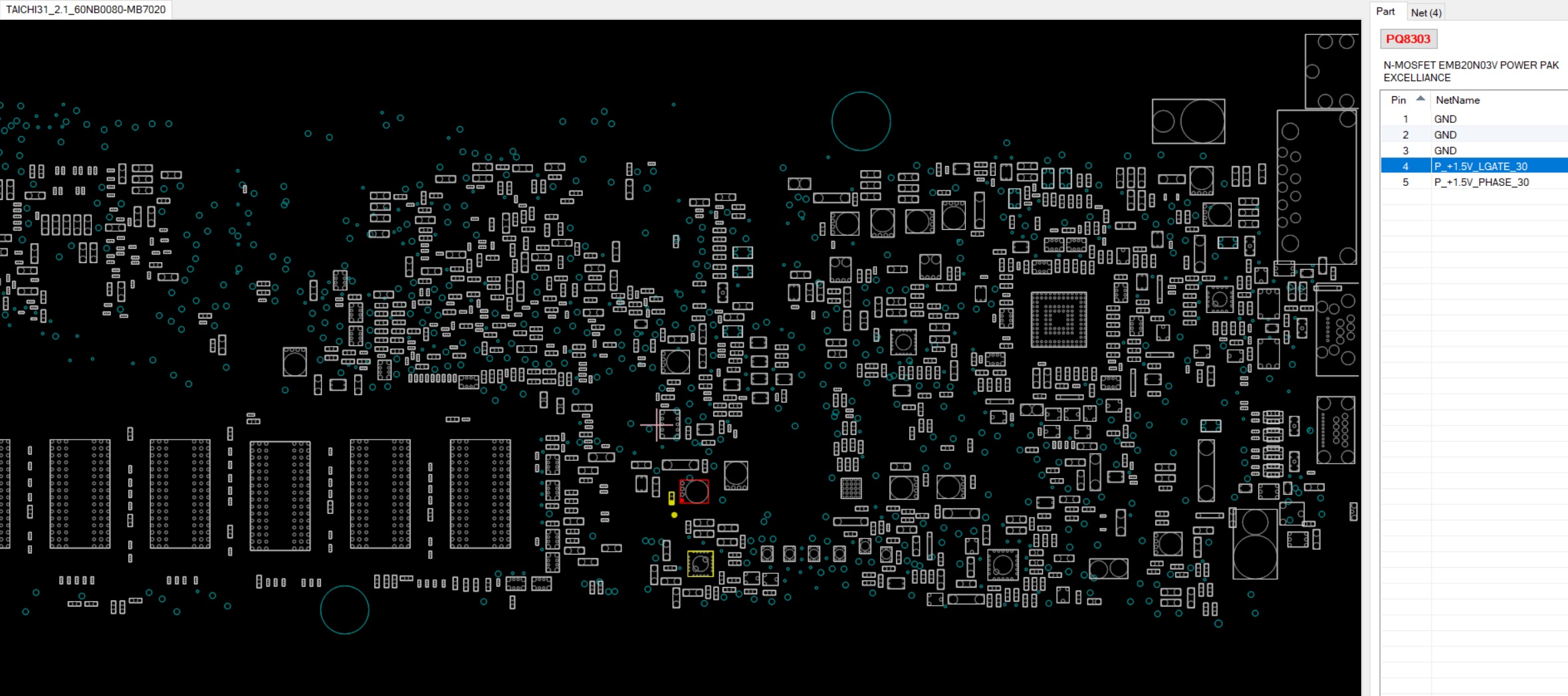

    The second is a mosfet gate, which not give a 1.5V. First thinked to soldering a 1.5V jumper, but checked a few voltages around and found a mistake.
    On a capacitor below measured 6.5V instead 1.5V boot voltage, the other side of the cap is already 1.5V. Just included the schematics too, if somebody can check please.

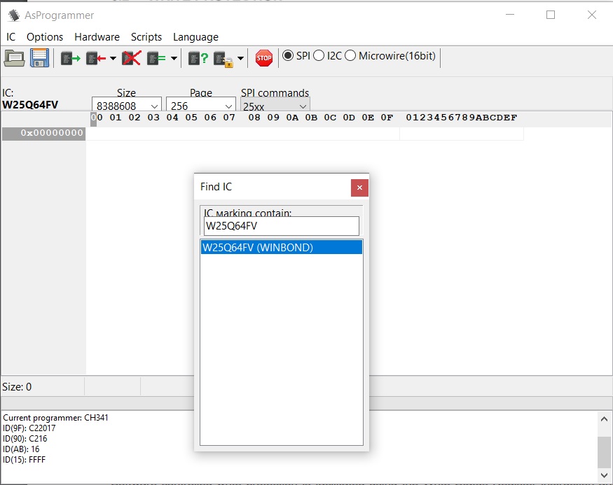

    Try to reflash the BIOS first. Had a similar case in the last 24-48 hours in this forum for another brand of PC with the same issues - no Vcore & no GPU voltage rails = no POST. The issue was resolved by just reflashing the BIOS. Attempt this first.

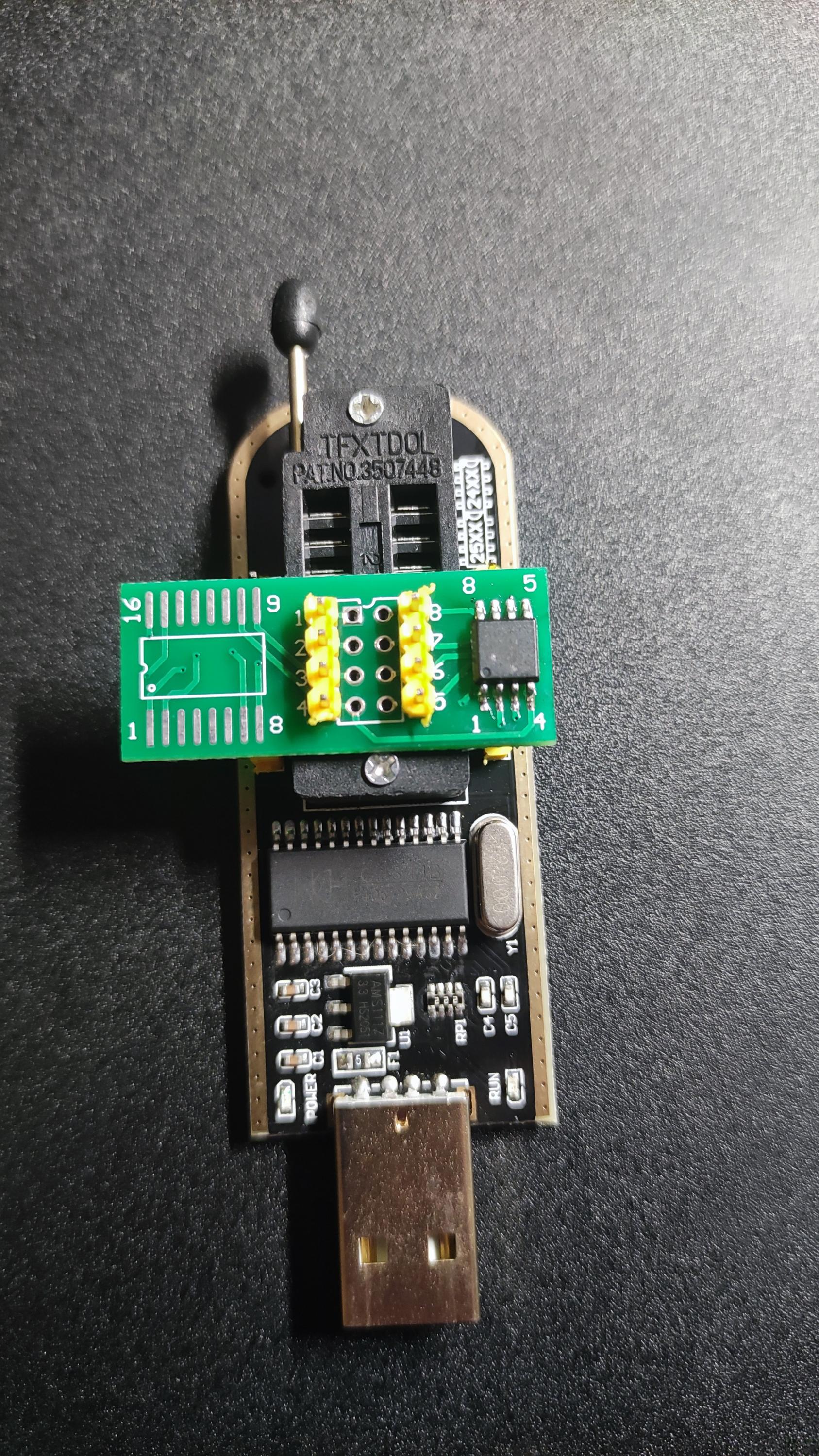

      Don't know where i did wrong. Click on the IC type in AsProgram than nothing happening. On the VCC is 3.3V right. The device recognized, paralell firmware installed.

        Wrote the newest BIOS to the eeprom, not helped. (The problem was the 5V data lines on ch341a, thats fixed.)

            Other suspect is the mosfet, on input side there is 1.5V, but gate nothing. Thinking on desolder and jump the 1.5V, but don't want to kill the MB. Means?

              Never jumper any mosfets. Post the mosfet part number so we don`t have to look at a picture,post voltages.With no poswer test resistance to ground, and check S/G/D .If you suspect its bad test it out of circuit, desolder it.

                PCY01 FDMC 8884 mosfet type.
                Desoldered to check, drain to source under 0.7Ohm, drain to gate 81Ohm. Think is dead.
                  measure source to drain

                    both direction the same result.

                      If you had 1.5V on the 1.5V power rail why would the MOSFET be bad?

                        On VGFX Core did'nt have the 1.5V
