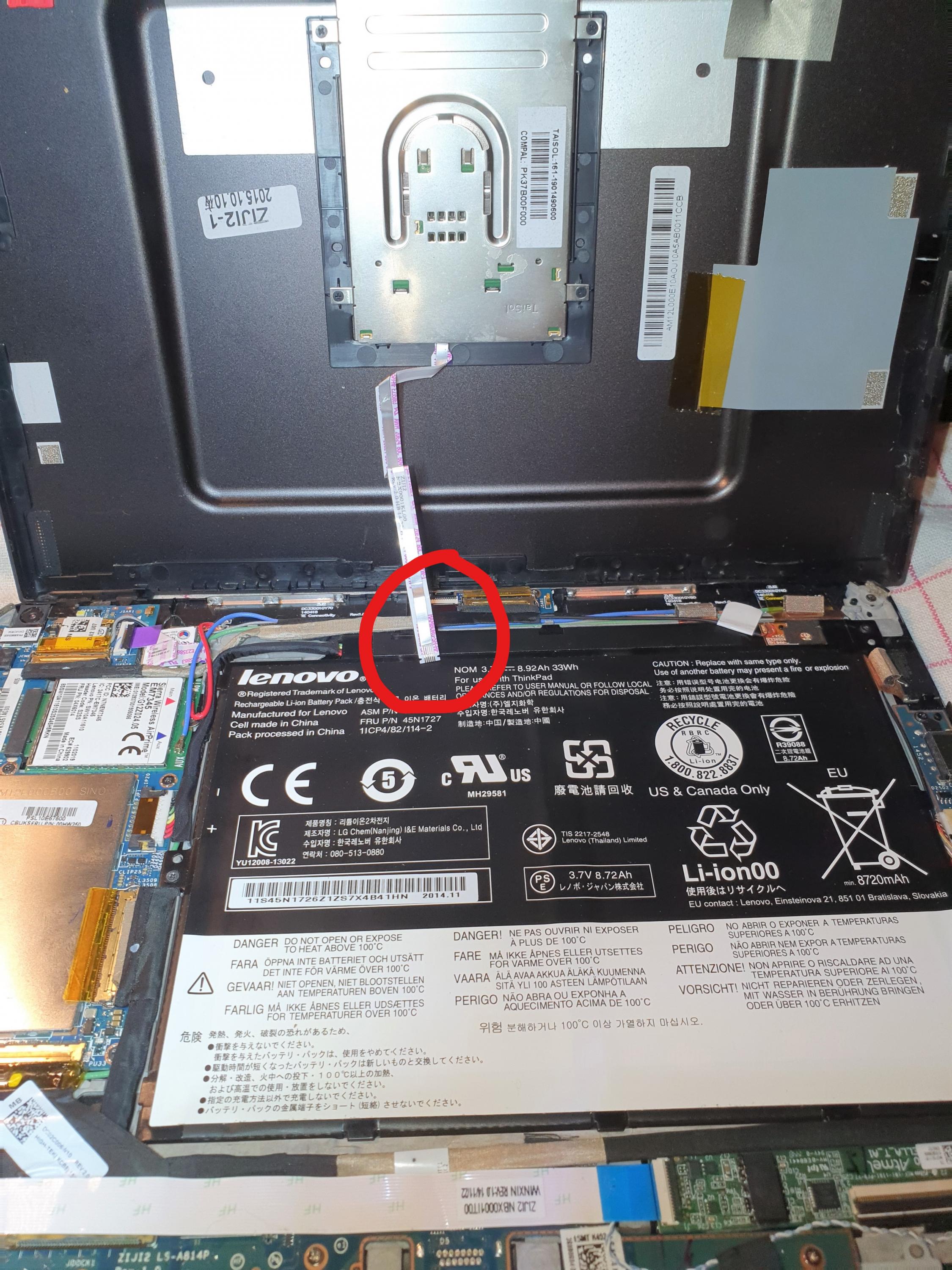

    I need some advice. i disassembled my lenovo tablet 10 to replace the battery. now i can't figure out where the smartcard reader cable connects to?
    I can't find the connector on the board? see picture below.
    Help is highly appreciated.

    There looks to be a couple of flex connectors with the flaps missing on the PCB that's in the red circle.

      You should find what you`re looking for in the Lenovo Hardware Maintenance model for your MT Machine Type
      Machine Types: 20E3 and 20E4 https://cdn.badcaps-static.com/pdfs/...2fced6d40e.pdf
      Machine Types: 20L3 and 20L4 https://cdn.badcaps-static.com/pdfs/...1101cba18f.pdf
