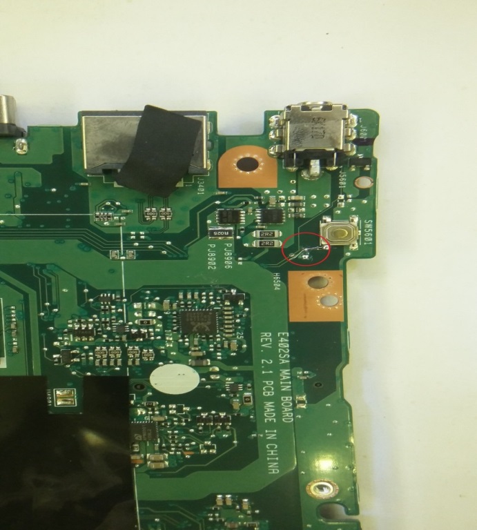

    i have toshiba c660 pwwaa la-6847p problem
    3.3 volt is present
    5 volt is present
    when i connect adaptor led is on
    there is no 3.3 volt on press power
    u19 i/o ene
    pin 30 ON/OFFBTN# is 3.3 v
    pin 100 EC_RSMRST# is 3.3 v
    pin 102 EC_ON is 3.3

      Doctormasry may be due to a broken track what is the the voltage on R395 both sides ? 3V take a wire and GND 3V bottom side of the R395 to check any reaction MB

          Usually it’s close to PWRBTWN put the multimeter in continuity mode one side to pin 1 PWRBTWN and other side to closest resistors bottom or top of the MB if not GND the pin 30 U19 with a tweezers be careful not to short other pins

            As a result of liquid contact on the Asus x502 notebook, a line break was detected in the picture. Examine it with a magnifying glass or if you have a microscope.

              it's work no conect line between PWRBTWN and R395
              work ok
              many thanks
