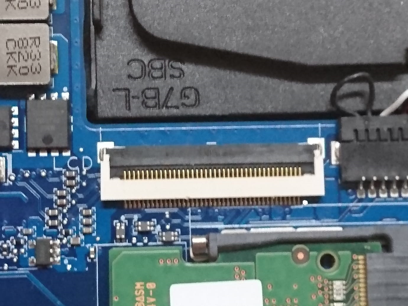

    Hi I have a problem with this notebook, the computer works smoothly but only with the hdmi output, I don't see anything on the main monitor, it stopped working at any moment, it could be the display, the fhd cable or something else ?
  • Sephir0th
    • Oct 2020
    • 1289
    Re: hp pavilion 15-cs006nl
    Check the internal Display Connector for 19V and
    3.3V being present while internal Display ist connected and Lid is Opened.
    It Would be nice to have a HQ Pic of the connector and the surrounding components
      ok I prepare the photos and post them

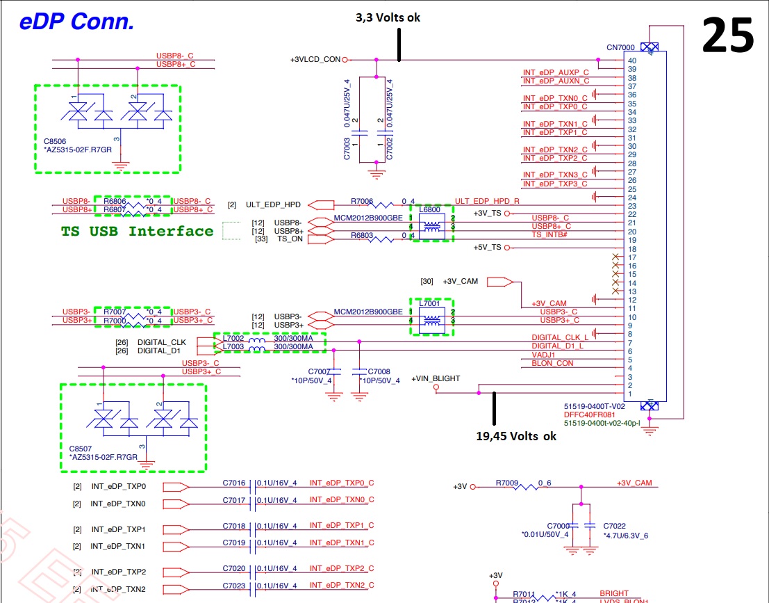

          Refer to any schematic with 40 pin connector and check whether you have +19V/LCD_VDD/Backlit_ON etc signals on the connector.
            thanks for the reply, i can't find any lvds schematic showing 19v, i only see 3.3
              Usually pin 27 & 28 are the two pins for INVPWR_B+(meaning 19V) on an edp connector.You can take LA-C701P schematic for reference as it too has 40pin Edp connector.
                if pin 1 is the first from the right the one where there is a white dot, pins 27 and 28 give them to me as ground
                  this scheme is perhaps more appropriate
                  LINK to G34A schematic https://www.badcaps.net/forum/troubl...needed?t=66810

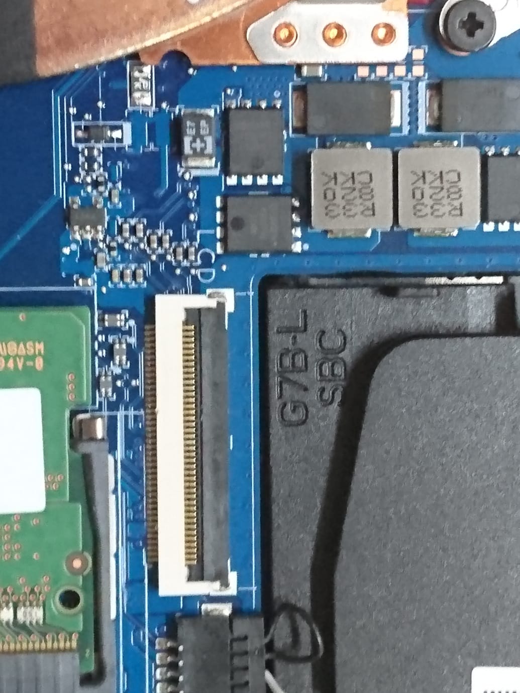

                    I confirm what was stated before, the right connector is this in the picture and I have both 19 volts on pin 1 and 3.3 volts on pin 40
                      Ok, if this is the right connector then check VADJ and BLON pins for voltage. Check carefully is it no display or dimm display on internal screen.
                        what voltage should i have in these two pins?
                          3V approx.
                            3V approx.
                            this measurement is difficult to do, the pins are too close I am afraid of shorting something, also those two pins seem not to be connected with any nearby point to make the measurement more safely
                              Yes, there is risk of damage while measuring. You need needle sharp probes to do this.
                                I close the thread as solved, the problem was the display, thanks to all
