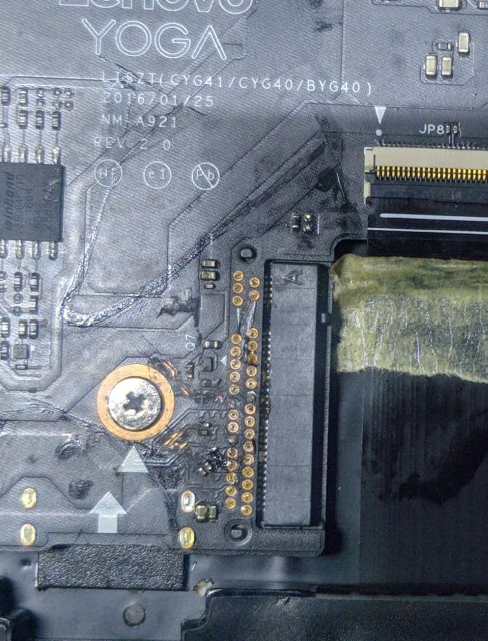

    Hearty greetings to everyone.
    The above motherboard does not detect SSD, I notice some components are missing at the SSD port area. I don't know what are missing and the value because, I couldn't lay my hands on the boardview. Please I need assistance in identifying the missing components and their values. Attached is the picture of the condition of the area. It will be appreciated if I can see the boardview as well.
    Thanks.

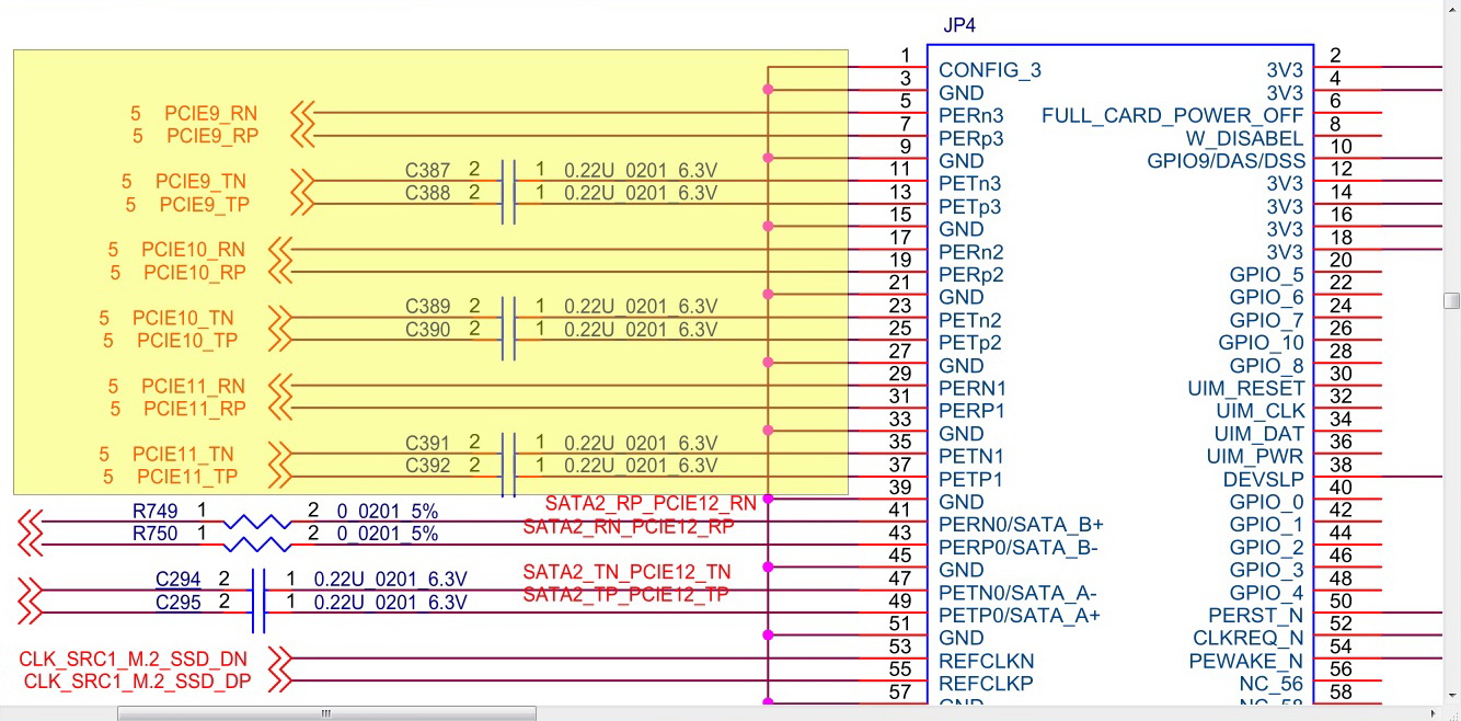

    schematics

      Re: Lenovo Yoga NM-A921 rev. 2.0 disk not detected
      Restore all capacitors. 0.22U_0201_6.3V
        Thank you so very much. Done!
