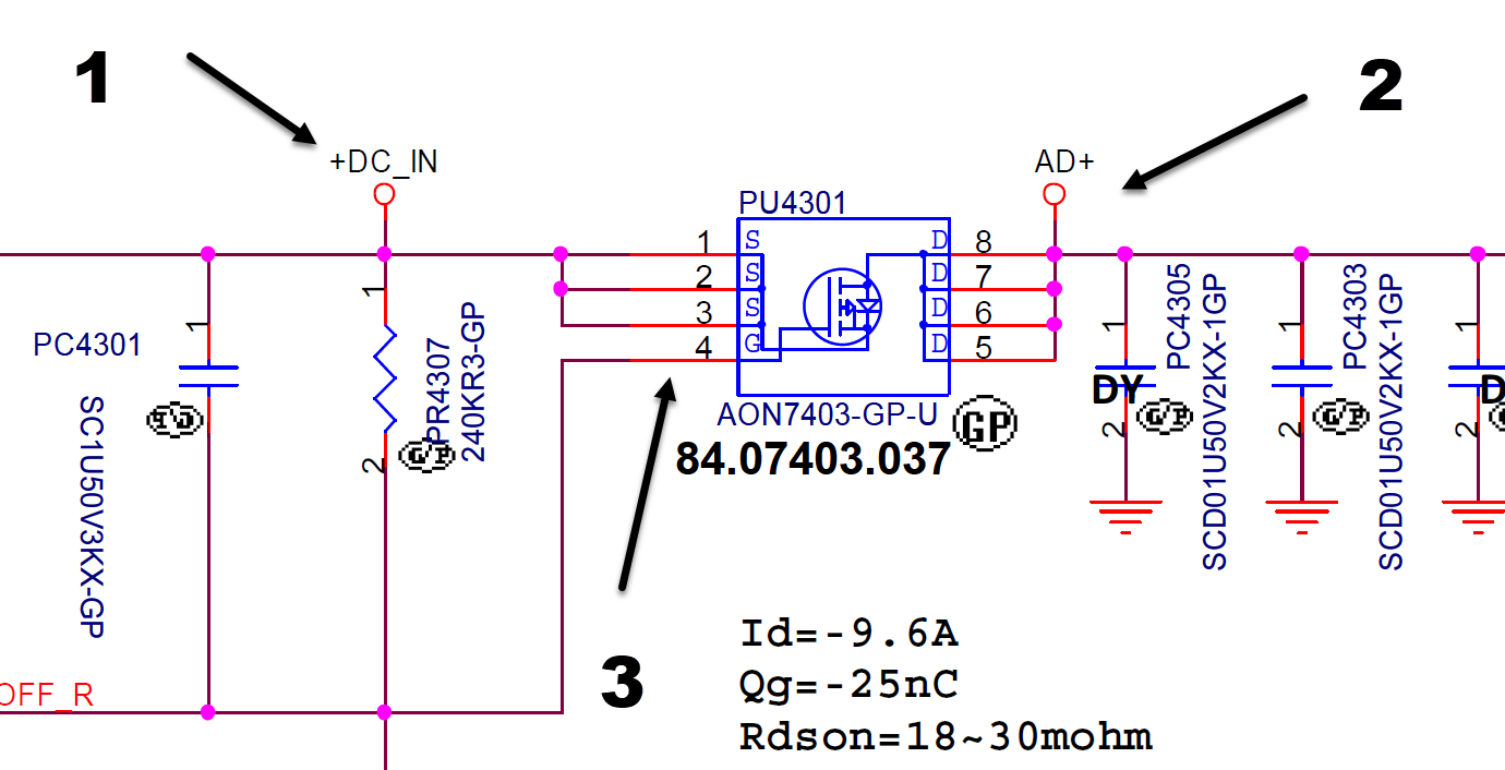

    Hi everybody,
    I have a Dell Vostro laptop with the VEGAS/TURIS SKL/KBL 15341-1 motherboard. Without notice, the other day the laptop was dead and as soon as I plug the charger in, the LED on the charger itself shuts off, as if detecting a short circuit in the motherboard. Measuring on the board between + and - of the plug shows no evident shorts (readings are in the hundreds of kOhms). If I plug a bigger charger with a higher current limit, it will stay on and some chips get hot. Using a thermal IR camera, a couple of mosfets get hot (but, testing them, they are not shorted, I think they go up in temp because of the short circuit current drawn flowing through them). A chip though gets very hot and you can hear a repetitive faint "click" anche the power cycles, as if pulsating. The chip I'm talking about is PU4701, a NCP81382, which is responsible for generation of the VCC_CORE rail. However measuring it with a multimeter shows no evident shorts. How can I proceed in finding the fault? I'm starting to fear the CPU is shorted itself. There seem to be big banks of caps on the VCC_CORE line, could they be the culprit? Or am I completely out of track? I'm a bit newbie at diagnosing such difficult circuits.
    Here's the schematic PDF:
    https://1drv.ms/b/s!Aiwky_BwJ7fkpAzl...h1yFh?e=WXxrir
    Thank you so much in advance!
    Davide

    1) start with page 103 @ Adapter to follow the power supply flow.
    2) Remove the battery (for now) and check the voltage of the external power adapter @ +DC_IN connector. Voltage value @ PU4301, pin 1,2,3 ? (page 43)
    3) Voltage value @ PU4301, pin 5-6-7-8 (AD+) ?
    4) Voltage value @ PU4301, pin 4 ? Measure with care so that you do not short pin 4 to 1-2-3 with the meter probe. This voltage is of interest only to confirm that the mosfet is being told to enable via the gate. If all is well, SOURCE voltage will pass forward to the DRAIN pins.
    5) Then check the voltage reading of DCBATOUT (page 44) - voltage value ?
    6) If AD+ rail does not match the external adapter voltage then power down and remove this external adapter. Meter in resistance mode (200 ohms) and red lead on AD+ with black lead on ground. Resistance reading ?
    You can repeat for each and every (large grey) coil on the board.

      Re: Dell Vostro 15 short circuit
      Thank you very much for you contribution!
      Power adaptor voltage, no load and disconnected is about 19,45v. When connected to the board (which is completely bare, nothing connected, removed from the laptop) +DC_IN pulsates and goes really low, averaging 0.7-1v. Spike cycle is too fast for the meter to follow, but it seems that for some fraction of a second it goes to adapter voltage. I may try to catch it with the oscilloscope. Anyway, voltage pulsates nearly the same on the source and drain sides of PU4301. Gate driving signal seems present but pulsates according to dc in voltage, as expected. By thermal imaging, PU4301 and PQ4410 are the only other components on the board apart from the aforementioned PU4701 that go really hot really fast (probably because lots of current is drawn by the short itself). DC resistance between AD+ and GND when power disconnected is about 120kOhms. Just messing around, PU5003 and PU5002 show a short circuit from drain to source. Strangely enough though, they stay fresh.
