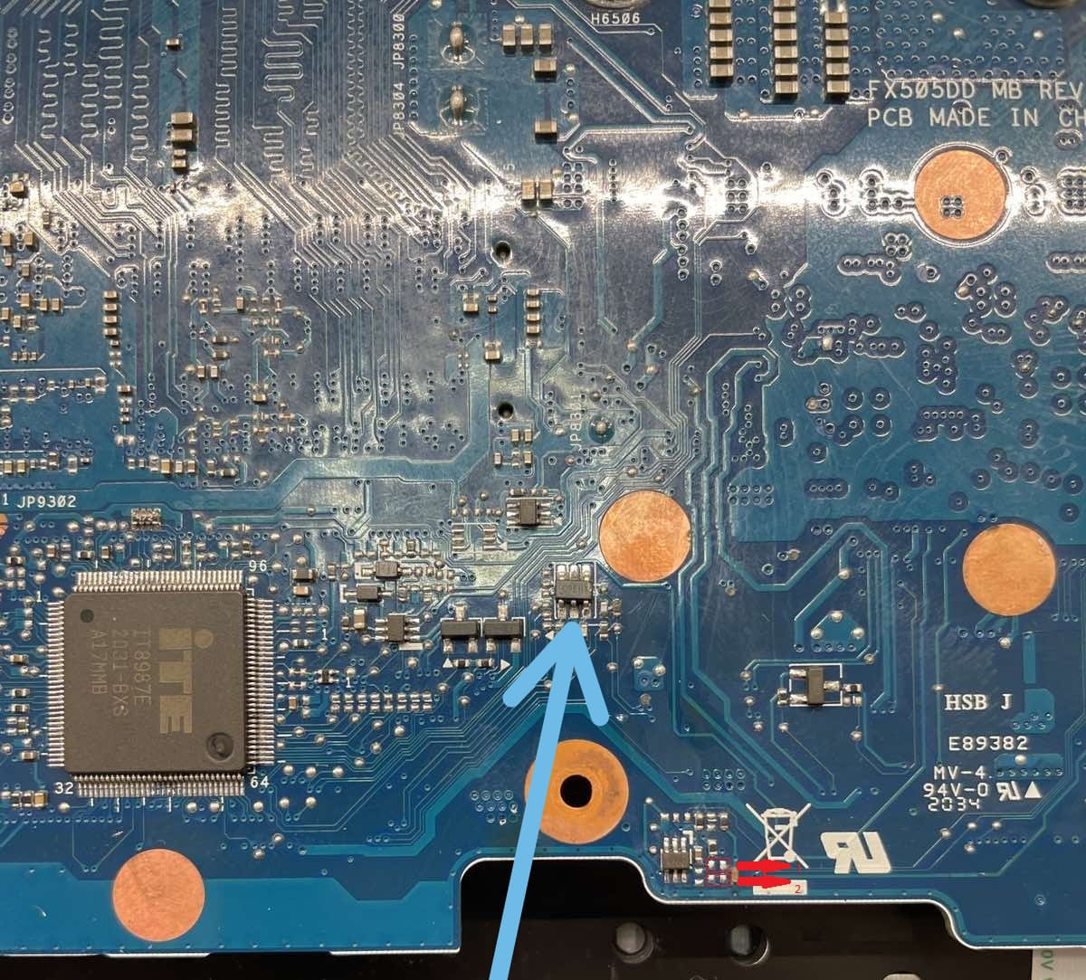

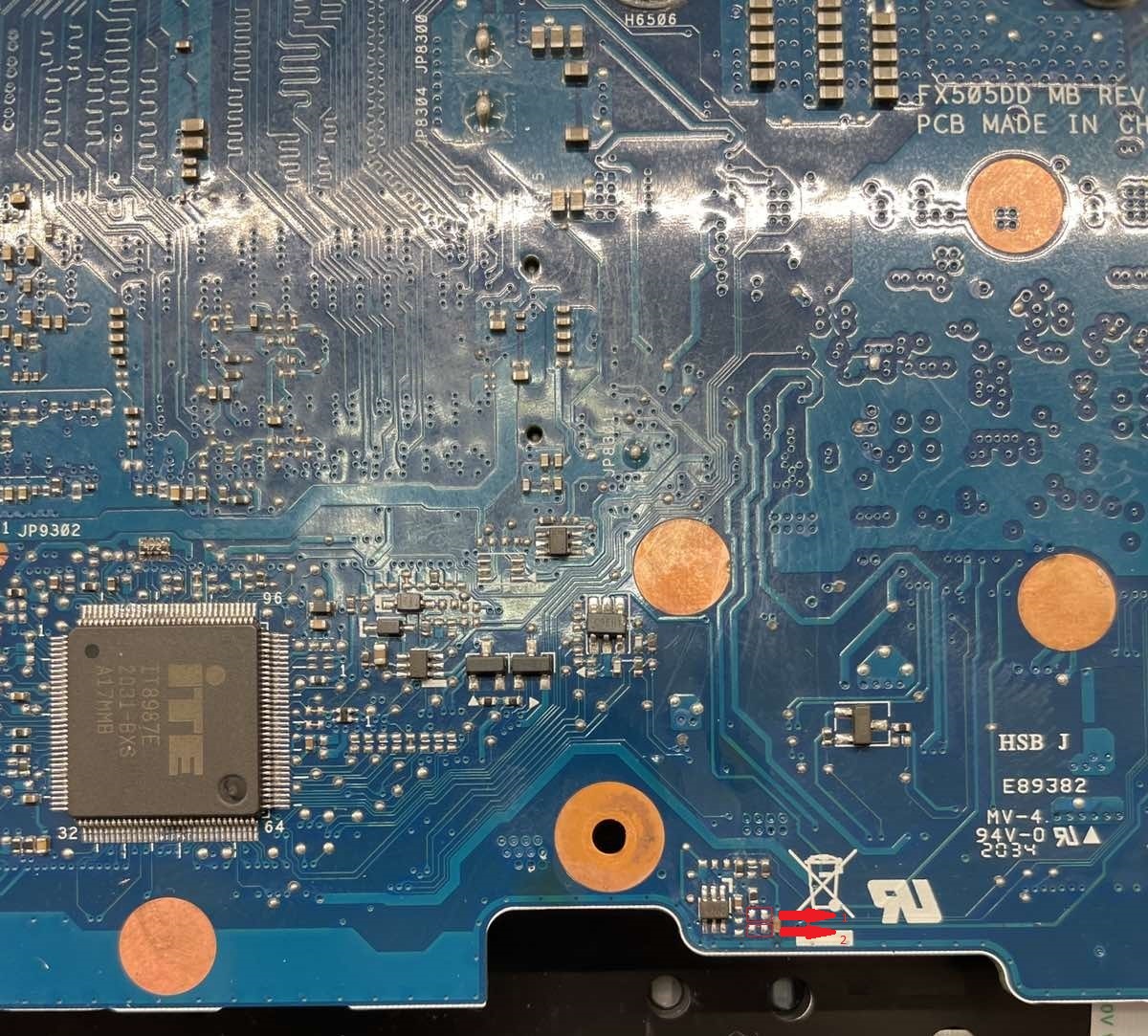

    I have a laptop that has been flooded. I need the value of two resistors. Shown in the picture. Please whoever has such a motherboard, measure it for me. No schematic diagram found.
    Thanks!

    1) Can you confirm that you have fx505dd? Any other markings on the logic board?
    2) Zoom in on the IC near these missing parts and share the markings. That may help.

      Re: Asus fx505dd (rev2.0) - 2 resistors
      This is from fx505gd but it looks the same
        Thank you very much myth77!
        This helped. It works like this. Now I have a problem that this ryzenes laptop only consumes 50 Watts. It has a 120 watt charger. It works slowly. Can you share the fx505gd boardview file?

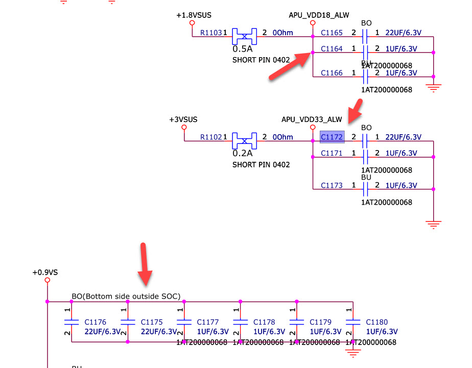

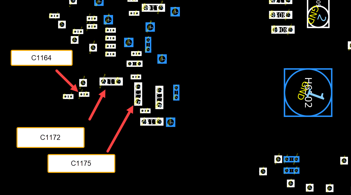

            I think Myth77 has a more suitable boardview file for your logic board but sharing one that may be close to yours. However, note that I do not see the IC to the LEFT of the missing resistors. Anyways, it is attached.
            the boardview file is encrypted. You will need to download and expand a different version of the tool to read this file.
            1) Download the special viewer from here:
            https://we.tl/t-FRYZ2cszyq
            2) Expand this download to a local folder.
            3) Launch the BoardViewer.exe program from this folder. Then load the above encrypted boardviewer file to view.
            4) To use the tool to view normal (no encryption) boardview files, launch the Boardviewer_normal file instead.

              Sephir0th >> I said from memory, but you are really right
              mon2 >> Thank you, it helped a lot so it will be easier
              IC is 2N7002DW, but I'll see you tomorrow
                Here it is ...

                  Thunder 1986, i have the same board, with missing component, did you know what component it is, one with arrow point.

                    hello sir are value resestor
                    up 300k
                    down 1M

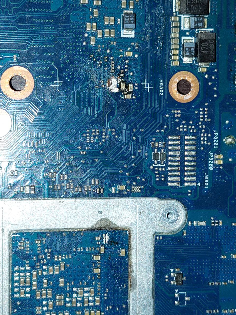

                      i have help
                      same board are damged i have image same this
                        Attached.
