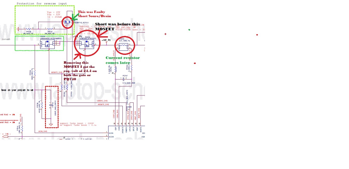

    Hi, Does anyone have the boardview for Lenovo IdeaPad FLEX 5-1570 81CA LA-E541P. Schematics is posted but I need little help finding the components. The motherboard in this is CIUYA/SA/SB/SD LA-E541P. Another know how.. I remove PQ712, I get all the voltage on the Gate of PQ740 which is 24.5V a true voltage out here meaning ISL88739HRZ is working fine, but as soon I solder PQ712 the voltages drop again. PQ712 is not short & I also checked PQ707 (Protection) all seem to be fine. Do you think I should replace PQ712??? I also check PQ705 & PQ305 (Battery Charging MOSFETs) & the surrounding caps., all seem to be fine. I removed the resistor PR913 to check if any short further but still the same. So there is something going on before this resistor. How come voltage is dropping??? Any help will be greatly appreciated. Thanks

      I soldered back the resistor & it 1 ohms (010). Removal of the resistor does not make the difference. Once I remove the PQ712, I get gate voltage on PQ740 24.5V which is a true voltage., & this Gate voltage is directly connected to the gate of PQ712 & this is turn on to pass the 19v on the drain & then comes the 1 ohm resistor. So whatever is happening is all behind this MOSFET & resistor.

          See I knew the problem was before this PQ740... MOSFET PQ707 was shorted, replaced it, all works fine. Just used Technical knowledge & brains & trouble shooted step by step. Motherboard work 100% fine. Thanks for all the help "Sephir0th"., it was great you guiding me.

              I do understand, but it did not seem logical to me.. I Read & studied the schematic very well. It isn't logical to remove the current resistor when the short was before this. There was no short on the resistor point even after removal. Pls. view the Schematic & study well. It's very nice to argue as we all learn a lot from all of this, thank guys for all the help & hope we have learnt from this trouble shooting.

                Likely PQ707 was shorted beetween Drain and Gate. Then this all makes Sense.

                  "Sephir0th" , yes you are right (Drain & Gate), when the power adapter was connected then the ISL chip as once detected this short & put it into protection mode though the protection circuit was short & never let the true 19v pass through the PQ712. This is why I kept on repeating that the voltage has not even reached the resistor so there was no sense of its removal as I had already removed PQ712. Thank you guys for all your help, really learnt a lot from this repairs.
