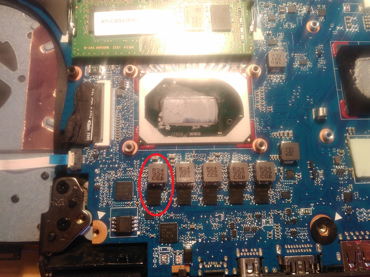

    Hello.
    Iha this HP OMEN 15-dc1101nc DAG3DDMB8C0 that makes 3long and 2short blink of capslock with no post. That code tells that error os in memory initialization. I try to flash bios, resolder memory connector, but no luck.
    When start i have all voltages except one coil in CPU power which i see on some laptop that it must not be there

              Re: HP OMEN 15-dc1101nc DAG3DDMB8C0 - 3long 2short blink of capslock
              this is the coil without voltage. resistance is 3ohm, on other cpu coils is resitance 1.6ohm
                You cant check that coil with DMM. Still check while you turn on there should be slight deflection on DMM. If it is so, then nothing wrong there.
