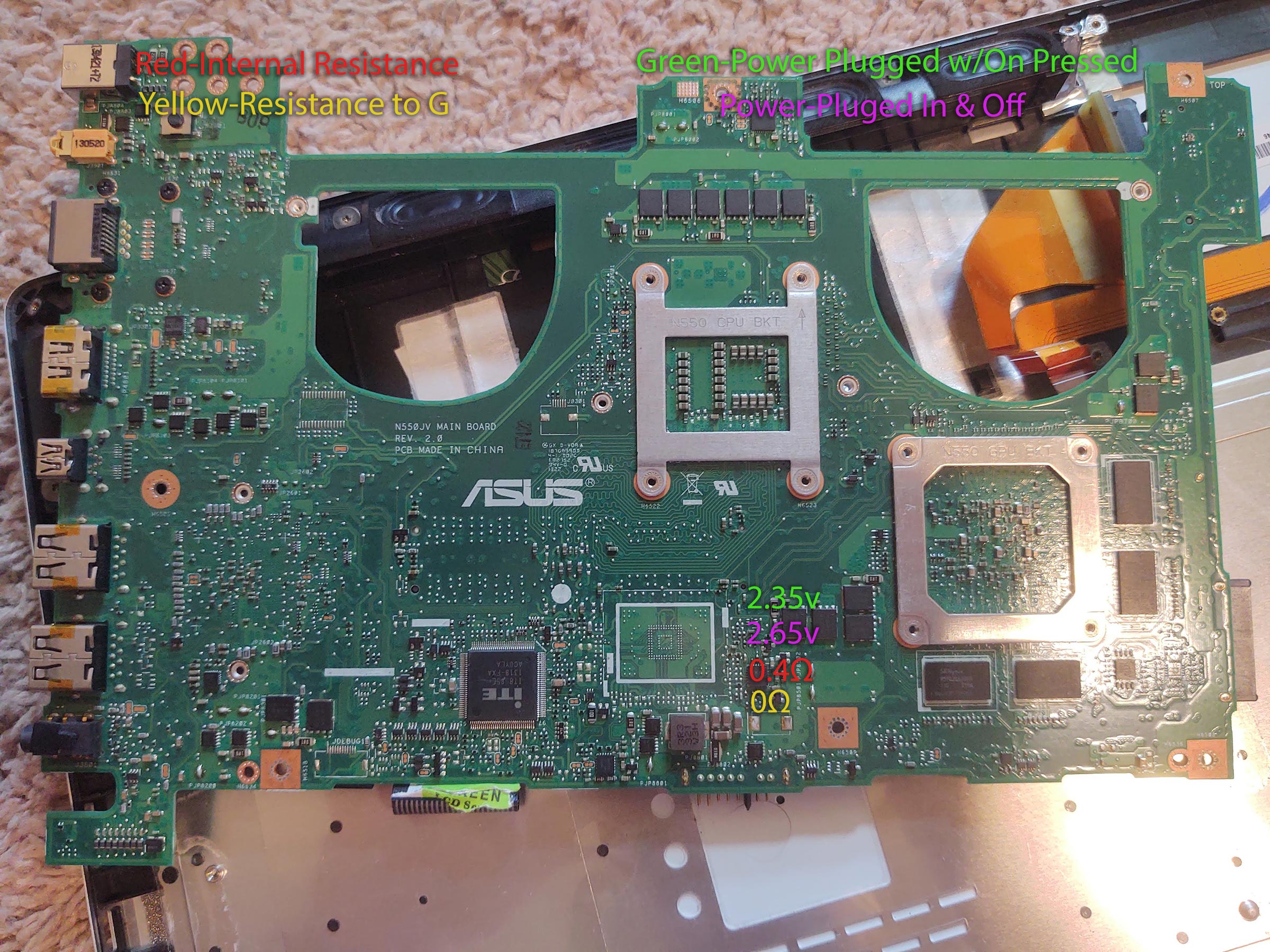

    I have an ASUS N550JV Rev 2.0 Motherboard that is not passing post. It was sitting plugged in for a while and when I tried turning it on it would occasionally try to boot (LEDs on front flashing with power solid) then just turn off. No screen activity. After moving the LCD forward or back and resetting the plug it would sometimes turn on. Now its no longer turning on at all. Just power light, (battery charge light if battery connected) and then the three other LEDs flash in sequence from right to left and then the power shuts off. Nothing has been able to bring it back to life so far. When it was working I tried to reflash the BIOS and did once but it changed nothing with how it was booting nor did it directly cause it to stop booting. I have read through forum posts here with others that have similar problems. I am not an expert in PCB tracing but have started dabbling as I am learning more and more about electronics and components. Obviously this is way further away from the old chips I used to work with.
    Does anyone have any suggestions that they might offer. I have downloaded BoardViewer and the Schematic file posted here. I have tried following some of the other posts but those are more specific to their issues of auto starting or just nothing.

    Start with Checking, which coils have Voltage before and after pressing the Power Button. Check also Resistance to GND of each coil (with all Power removed).
    Share a Pic of the Board with your measurements to have an detailed Overview about the Situation.

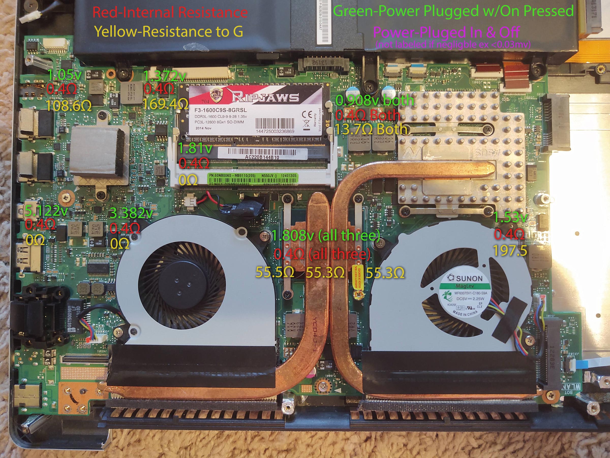

      Sorry for the late reply. Some family emergencies called me away and I was busy catching back up on work. I have analyzed the board coils and documented as best I could. The one back side coil I might have transposed the voltage off plugged in and pressing on but I figure that one is not causing my issue since it seems to be working as far as I know.
      Any advice or suggestions again is greatly appreciated. I don't quite understand what the stock values are but seeing some wide ranges alarms me a bit.
      Thanks in advance!

            The Voltages as well as resistance readings seems more or less fine. I'll suggest 2 things-
            01.Replace ram stick with a known good
            02.Flash known good bios.
            If both these steps dont solve your problem, we've to look for powergood signals.
