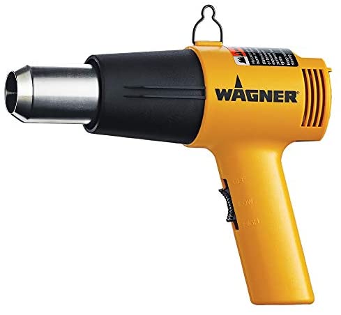

        1. Is it possible to desolder the IC with a rather large heat gun? (I do not own a hot air station unfortunately).

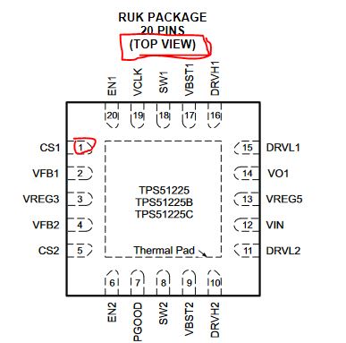

        2. How can I tell which pin is which underneath this chip?

          There is a dot on the ic or some arrow sort of marking on the mb which denotes pin1. You have to count serially after that. If you can post a pic of your hot gun, then i can comment whether it is suitable or not. Remember, proper tools is a must for repair.

            Re: Dell Inspiron 15 33308 Fried M/B
            You should count clockwise from the point in the picture. Check voltage outputs 3 and 13 pins LDO, 8 and 18 pins ALWS.
            I'm not happy to be so strong. because it's not humanly
              • 21869
              Anti-clockwise
                Looks something like this and it has 2 settings for low airflow/heat and high airflow/heat.
                I know that a hot air station would be ideal, but this is one of the very few times I had to work on SMD components, usually my T12 soldering station suffices for most of the repair work I need to do.
                  You`ll burn through the board,the work bench,through your leg and the carpet with one of those, its not the ideal tool.
                    A clear No No with this tool.
                      Yeah I thought so as well. Guess it will have to wait for now
